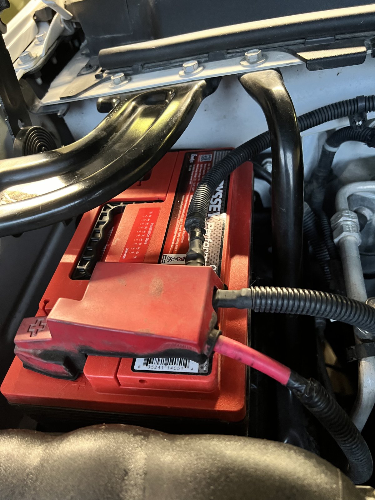

New battery. The 6 year old interstate was leaking and getting long in the tooth with only 12.4 volts resting and I was getting some odd little issues. Installed an Odyssey and we’re good to go. $243 for a battery this good. Can’t beat it.
Also an Amsoil oil change. Getting ready for another trip back to Salt Lake City 6.5 hrs away. Just got back a couple weeks ago. This is an enjoyable truck to drive long distances.
