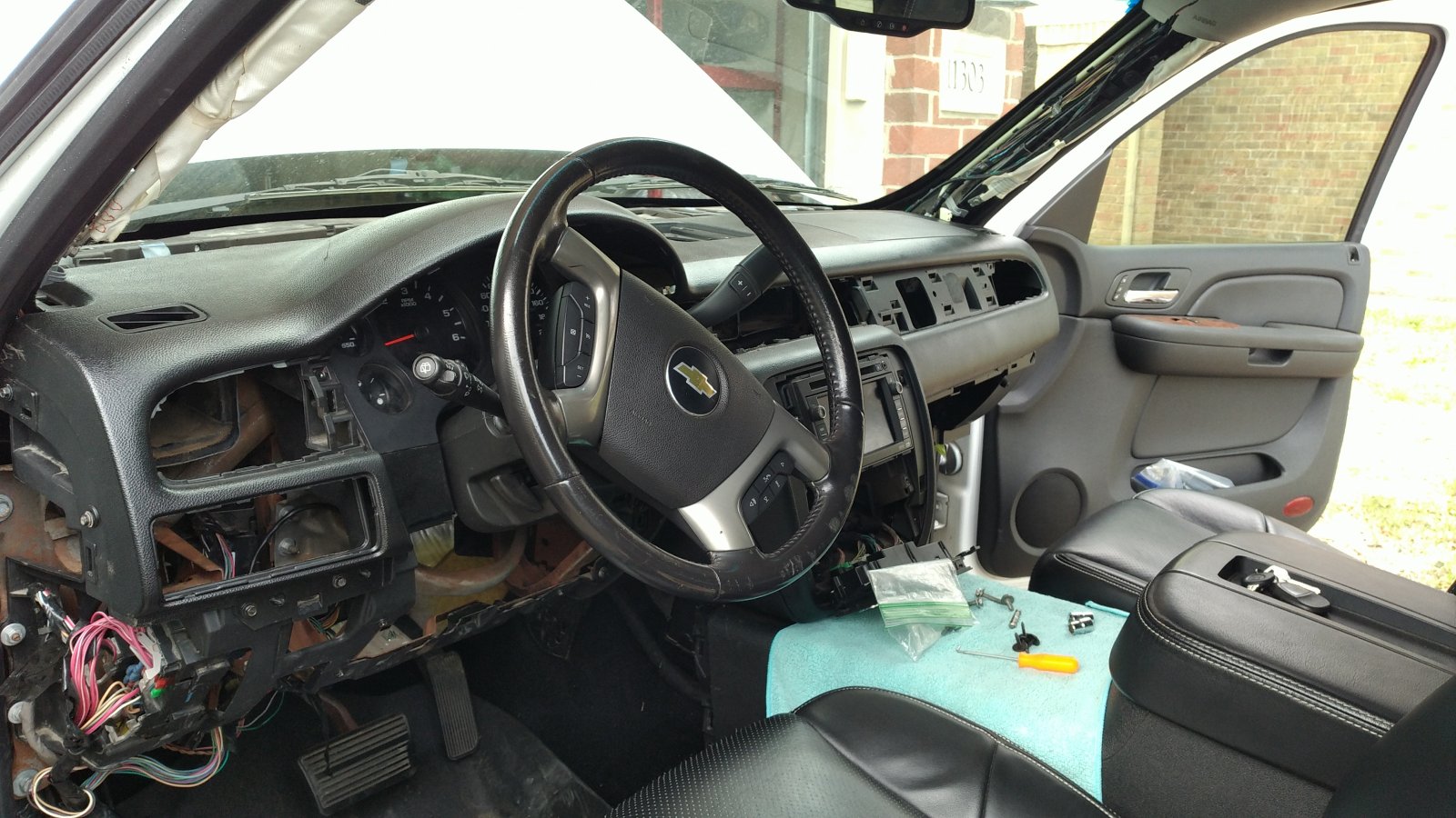

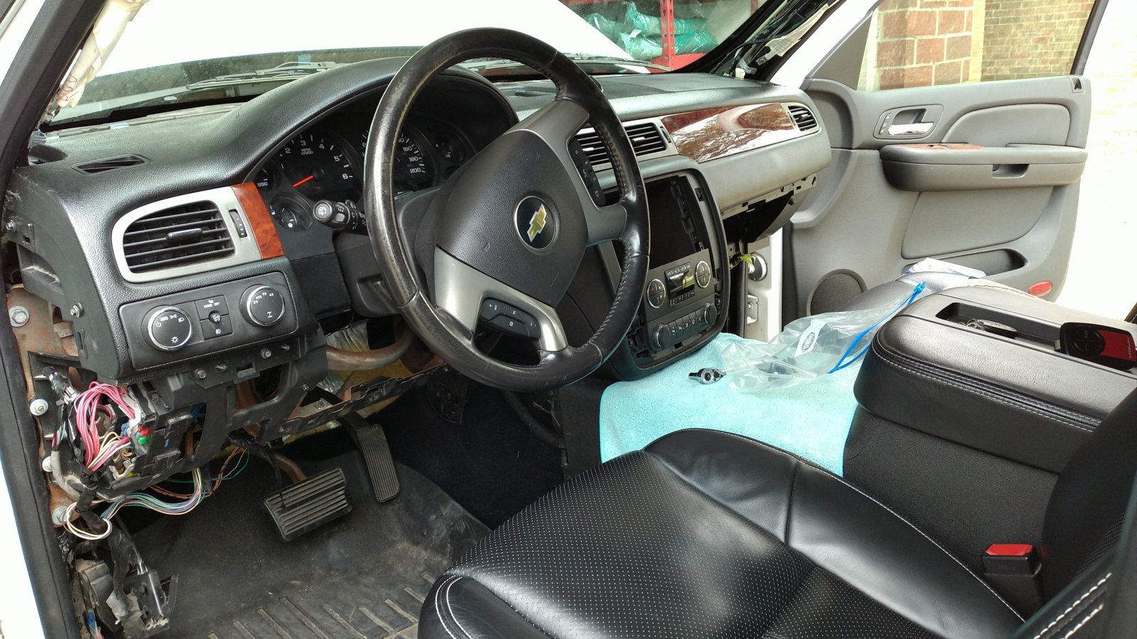

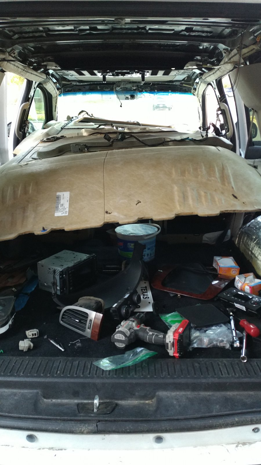

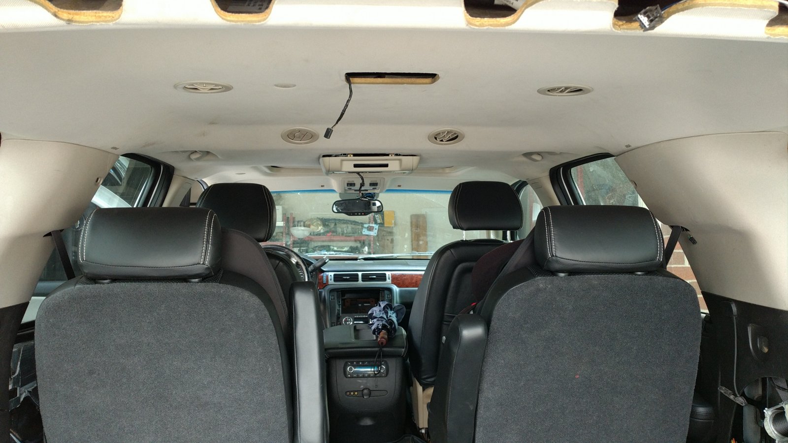

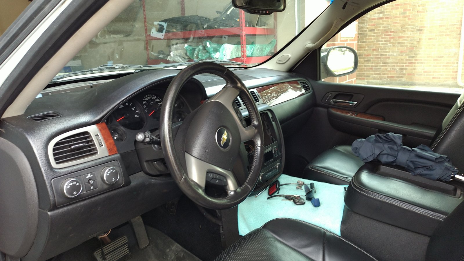

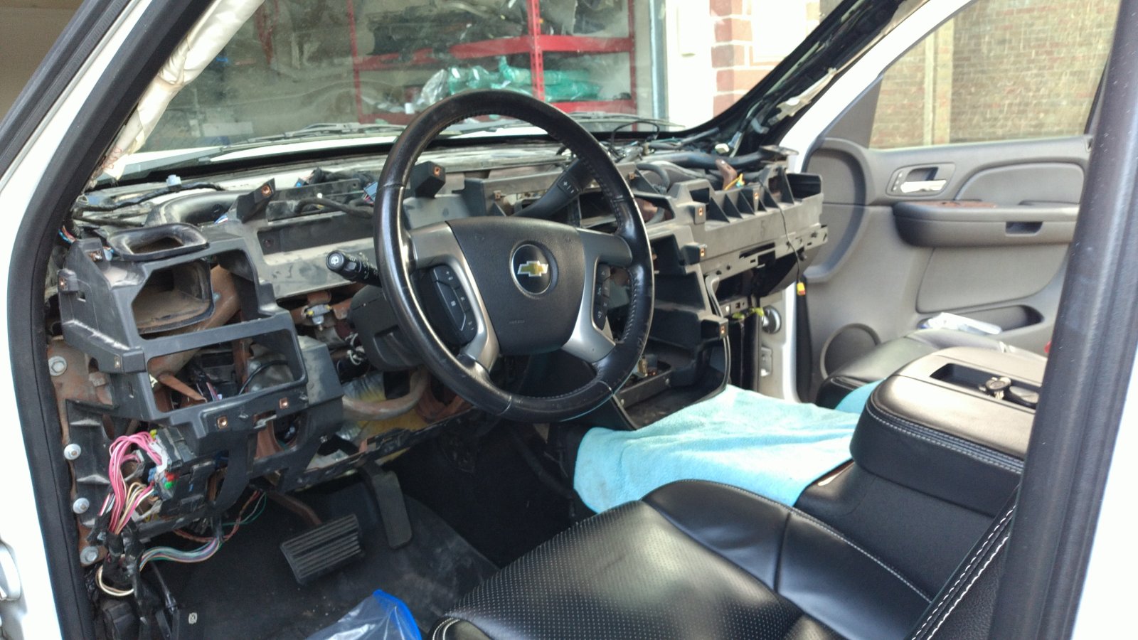

R&R headliner with replacement (used) headliner. Noticed a fair amount of the gray plastic trim is aged / yellowed. May hit some of the pieces with some gray paint before I put it all back together.
FIY for anyone that is going to take apart the dash, know that the long plastic cowl that butts along the windshield will likely break apart when you pull it out. They are notorious for this. Have a plan beforehand. I had a new one ready to go.
