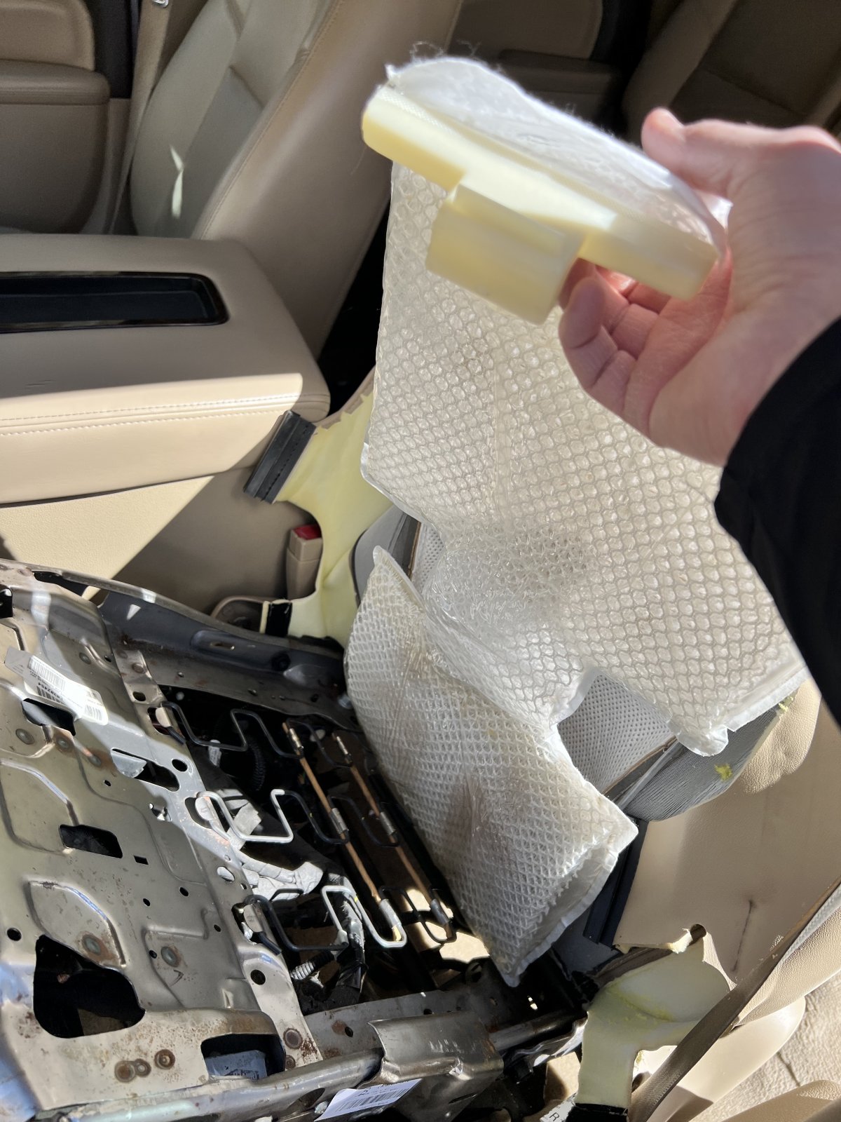

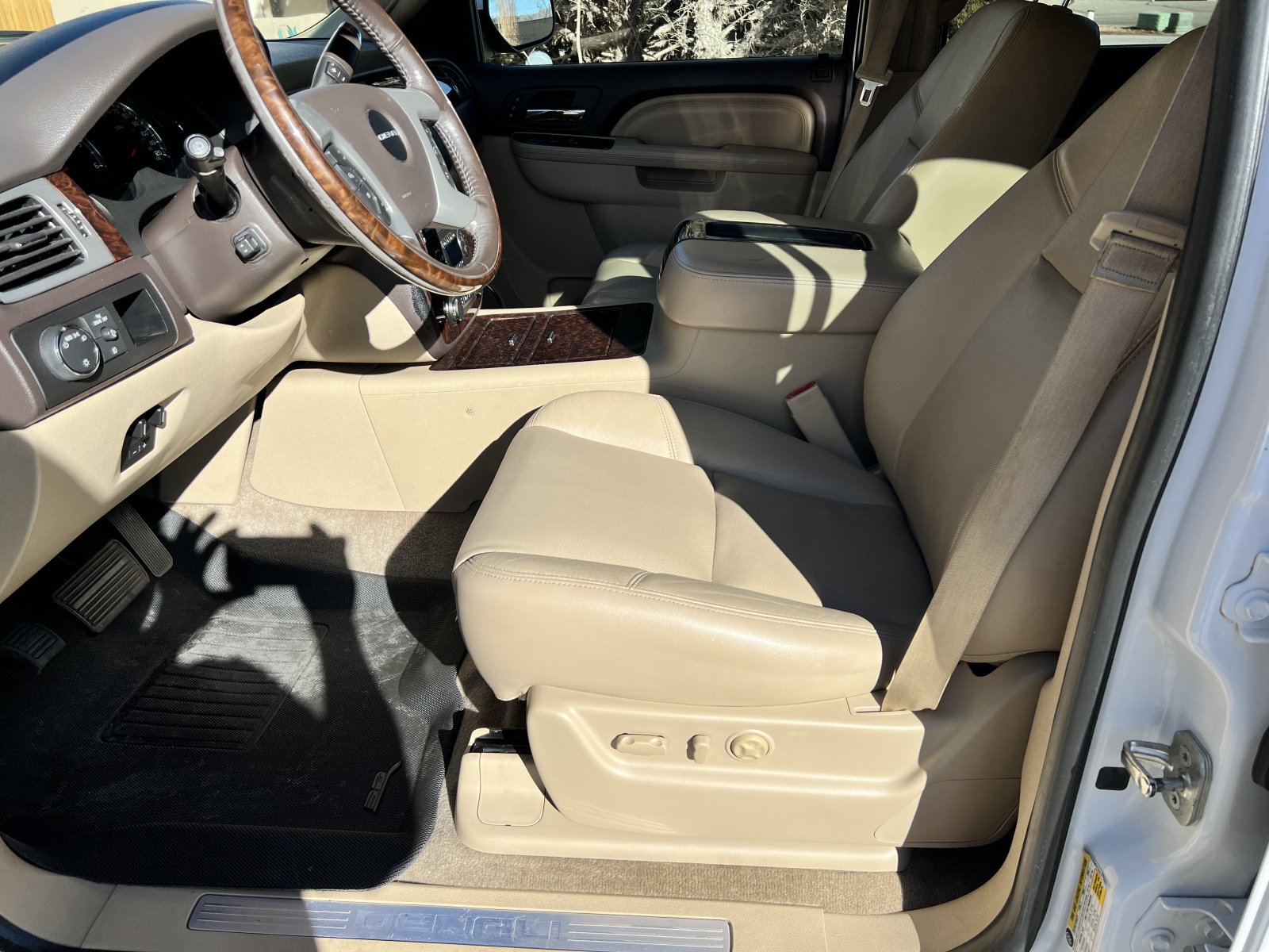

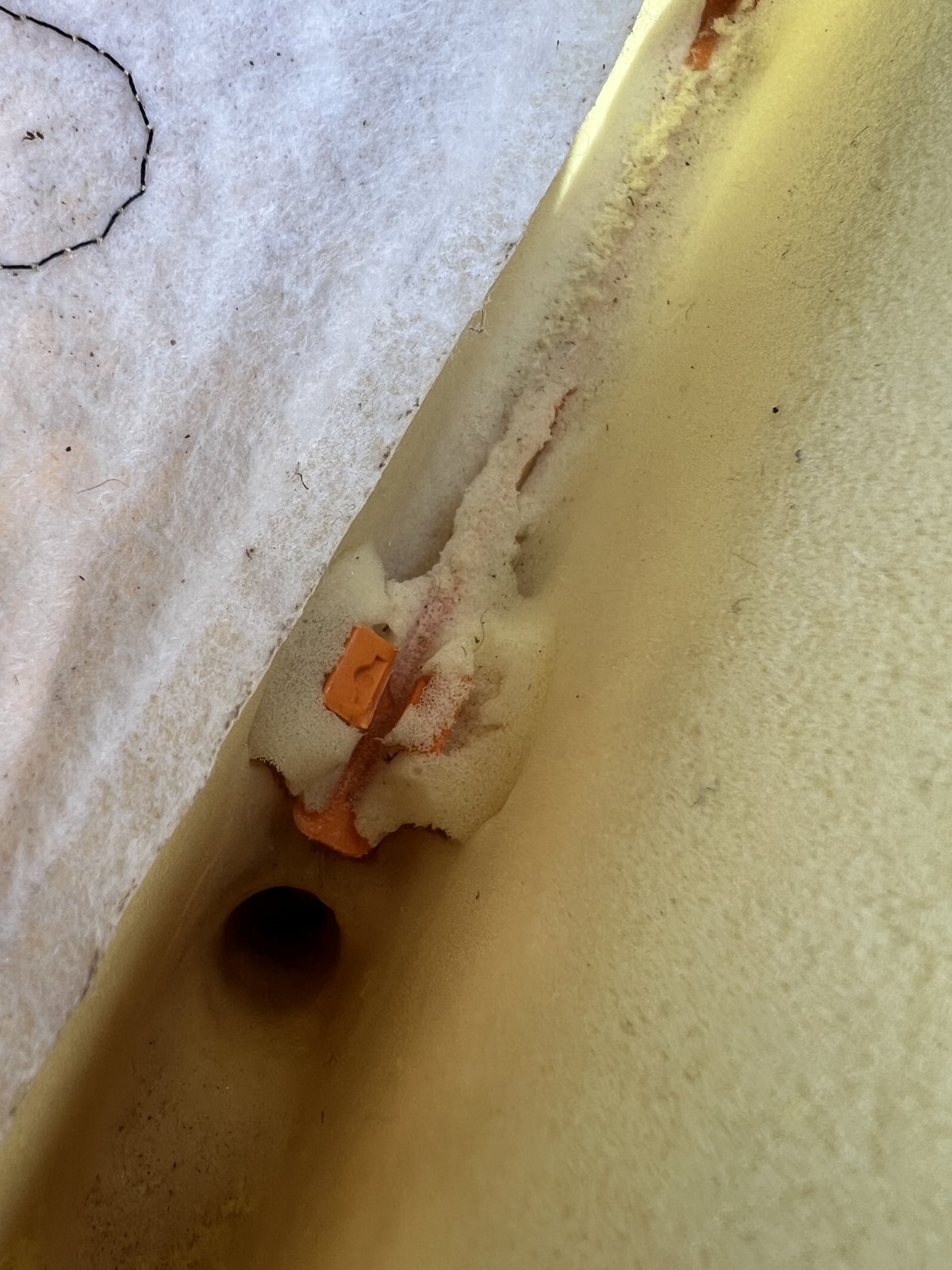

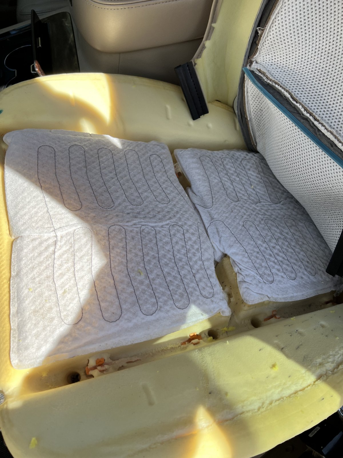

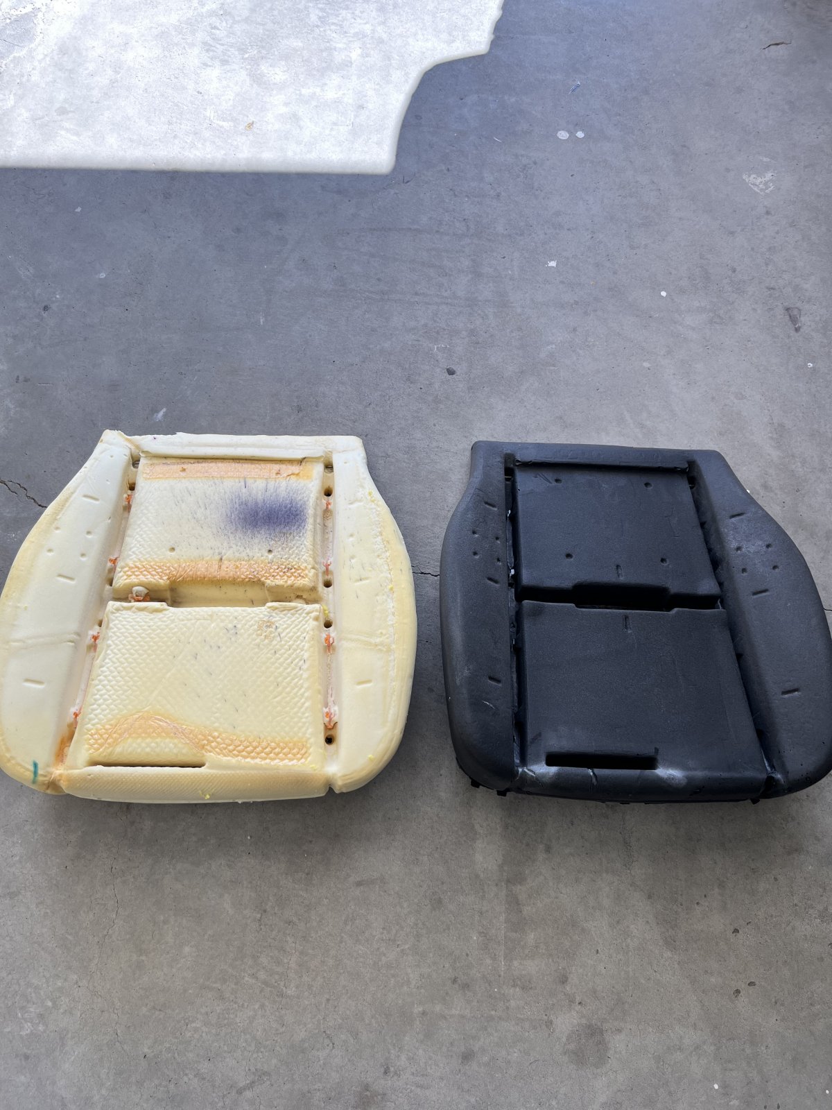

I was taking the drivers seat cover off to steam the foam completely and let it dry but I tore out a couple clips. Usually you can slide them out but since I was leaving the seat in I couldn’t. Oh well. I just ordered a new OEM seat pad. Delivered in 2 days. Installed it today. Huge difference.View attachment 391883View attachment 391884View attachment 391885View attachment 391886View attachment 391887View attachment 391887
will you do my driver's seat? please?
