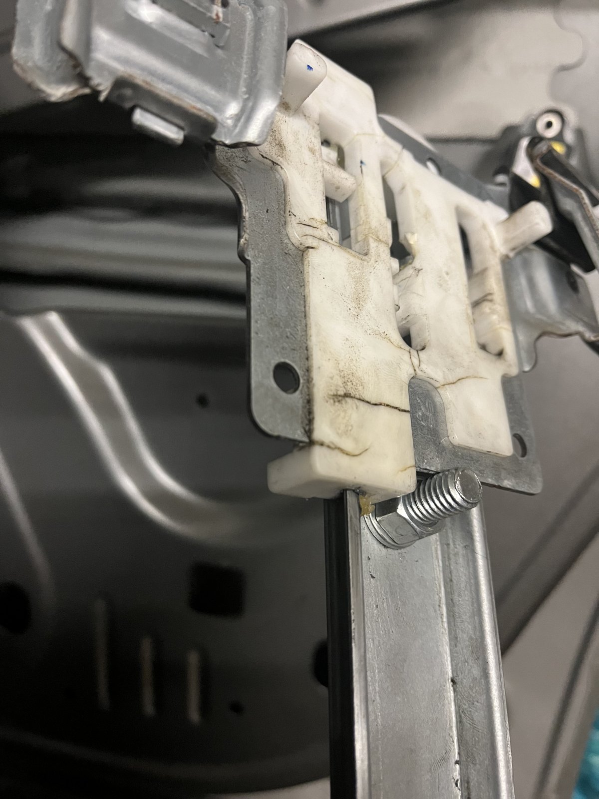

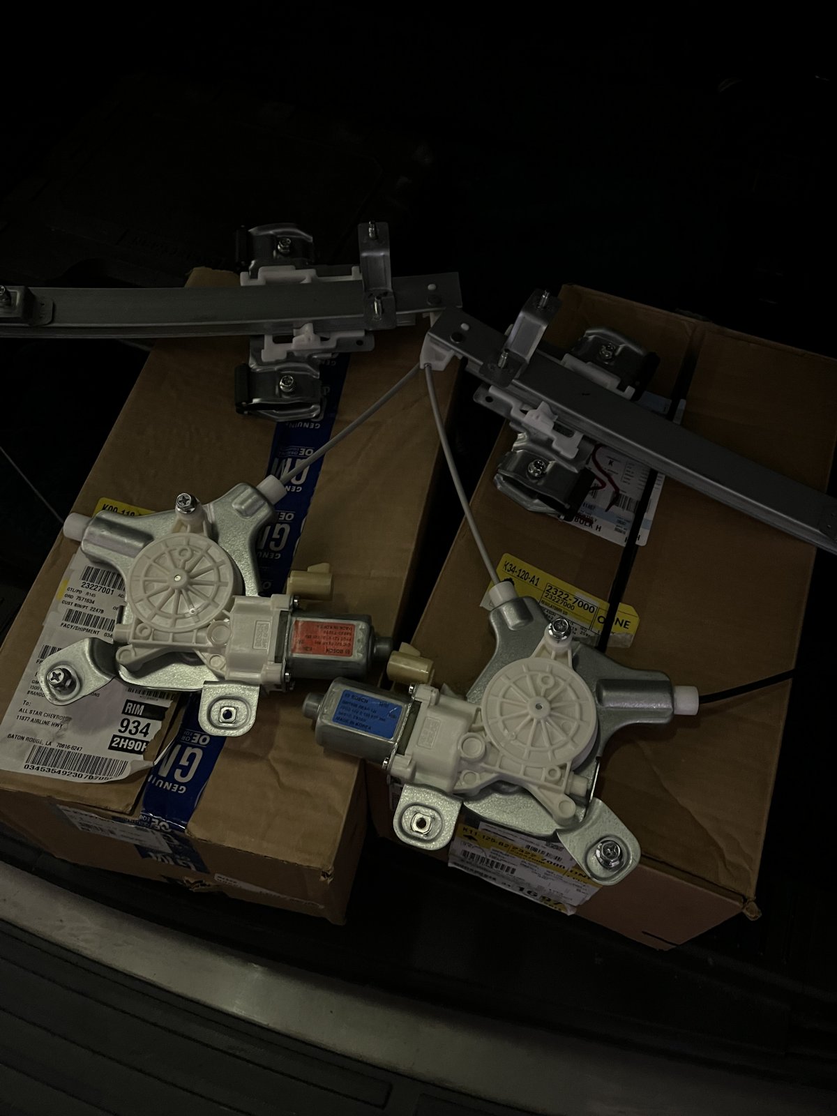

Weekend before last, I was putting the windows up and the right rear one made a cracking sound. It was up so I was gonna leave it and I should've unplugged the switch. A week goes by and I had forgotten about it. So, last weekend, I went to lower the windows a few inches for the drive home and the right rear window just slammed to full open. I'm lucky it didn't break. I park in a garage so it wasn't so urgent.

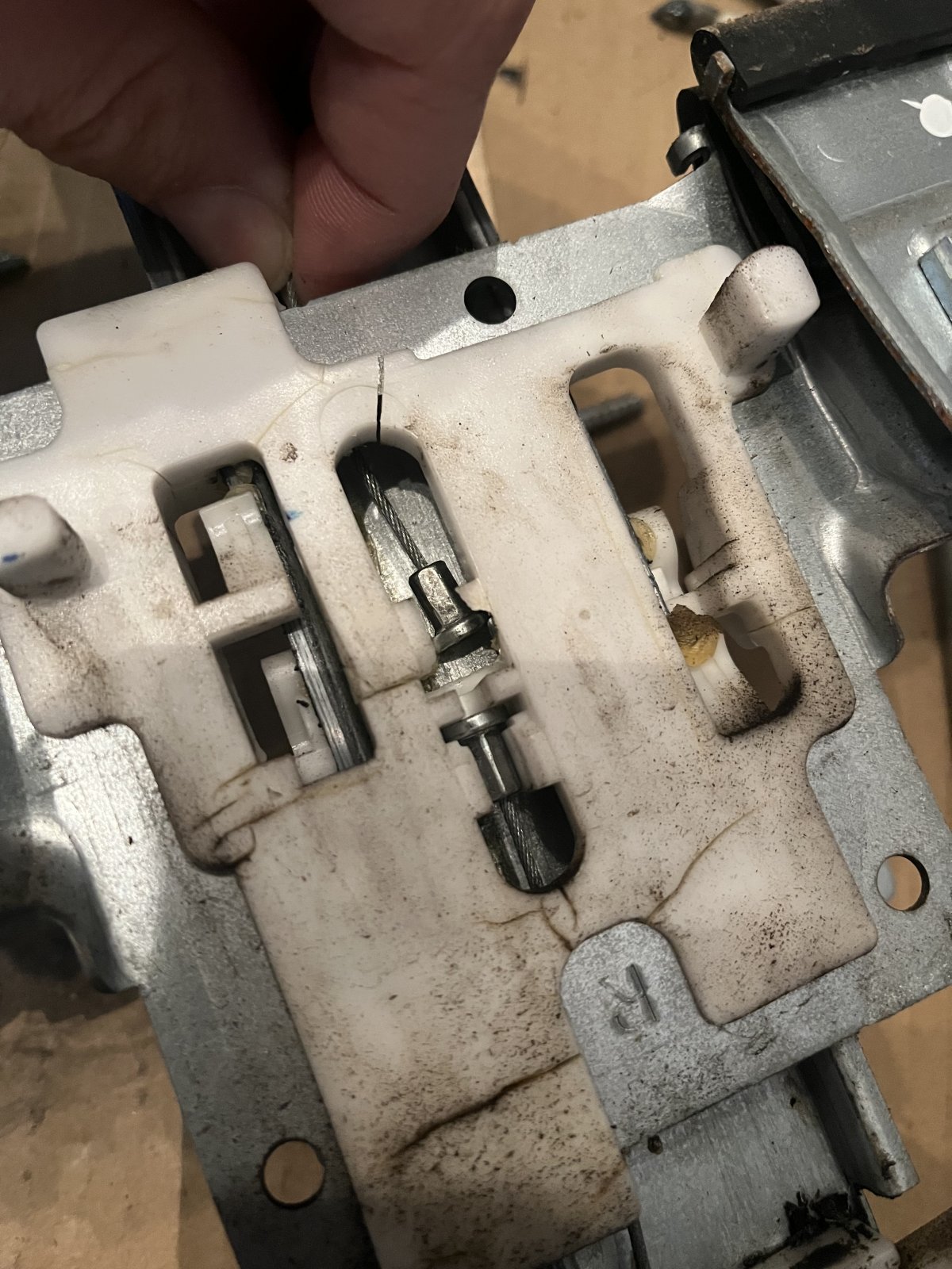

Just under four years ago, my driver's door regulator messed up and it was just a frayed cable. I made up a new one and it's been perfect ever since. I had an early day Friday so I tore into it to assess. This time, I wasn't as lucky. The cable was fine but the whole plastic trolley assembly was cracked in multiple places (obviously from age) and it broke where the cable attached. No saving this one!
I'm holding the upper cable end where it would be locked in place like the lower one but the pieces are missing:

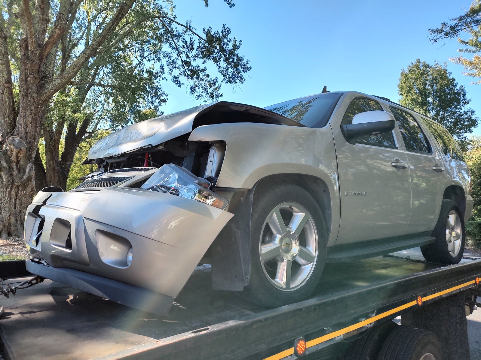

New OEM regulators are $100+ and I wanted to avoid aftermarket so I went straight to Marketplace to look for an SUV being parted out since I need a few other miscellaneous parts. I found a few but was targeting a 2013 since it was the newest. Then, I saw an ad for two new OEM regulators a guy had bought for his '08 Tahoe, but was T-bõned soon after so they were never installed. He wanted $40 and was on my side of the river. I messaged him Friday night and didn't get a response. I had to get groceries last night so I removed the motor drive and cables, put a 3/8" bolt in the track and reinstalled the regulator to hold the window up tightly in the seals:

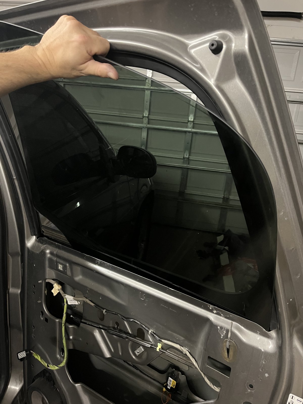

BTW, if you remove the inside sweep and tilt the window this way, you can remove and install it without removing the rest of the seals:
I was starting to think the guy with those regulators was yet another Marketplace seller who sold their stuff and just never deleted the ad. But then he replied this morning and we made plans to meet in town. I was skeptical that they were actual OEM parts until I saw them:
They're legit! As I pulled four $20 bills out of my wallet and handed them to him, I asked "It was $40 each, right?" He said "$40 for both" and started to give me two of the bills back. I told him they're a deal to me at $40 each and to treat his girlfriend with the cash (she was in his truck with the window down and saw and heard everything) :D

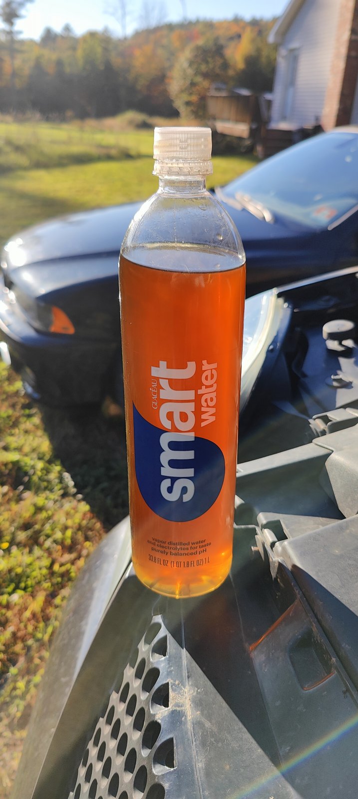

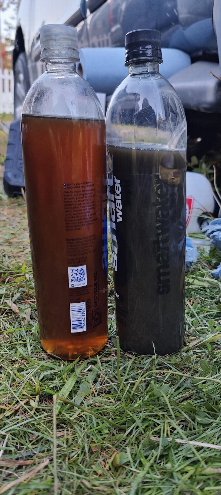

Replaced caliper and bled brake. This is the schmutz that came out. I had no way to drain the reservoir the other day, but plenty of fluid, so I kept adding it until the tank and output were clear.

that fluid looks good, mine turns black in 12 months without fail so it gets flushed annually.

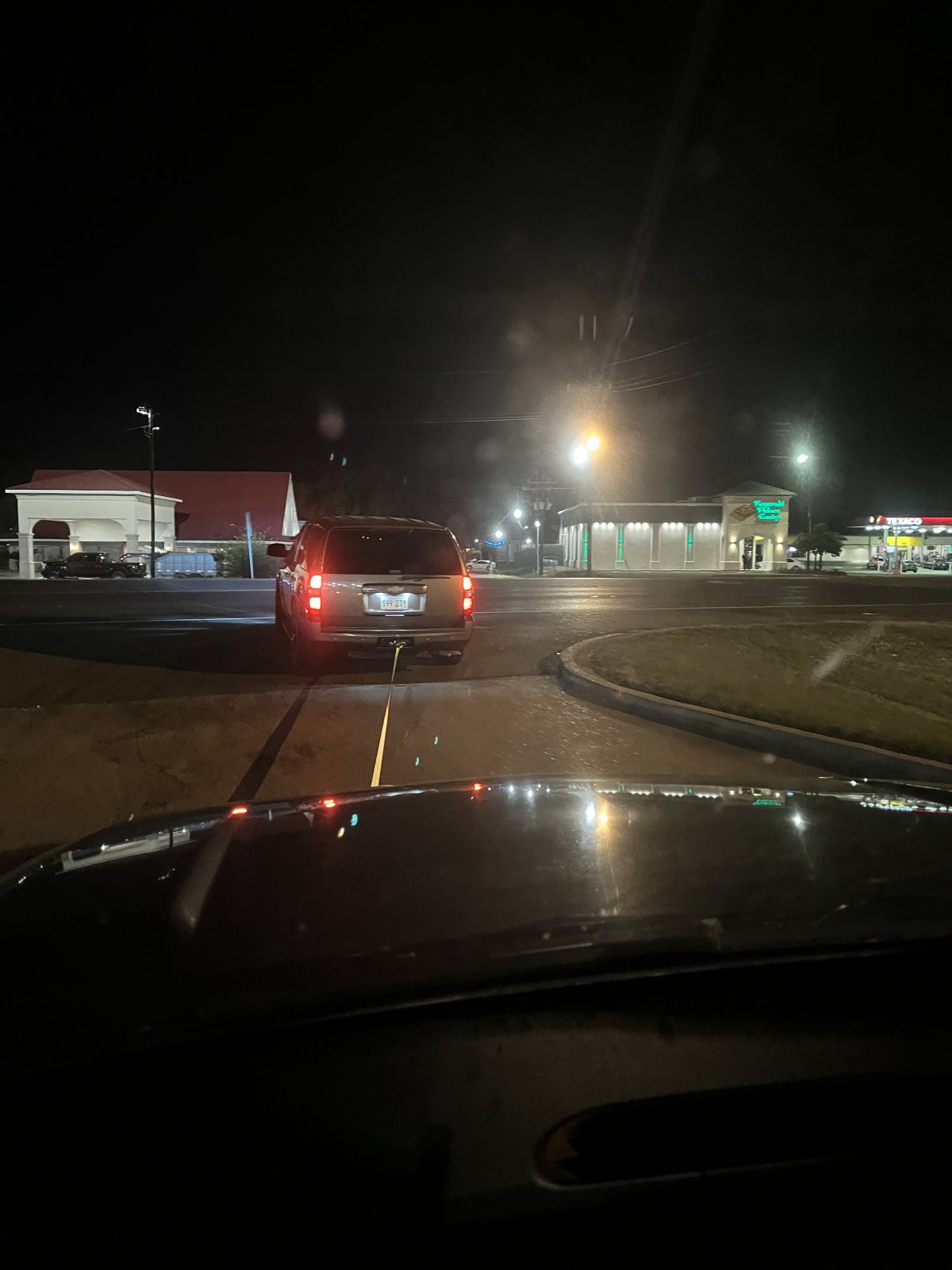

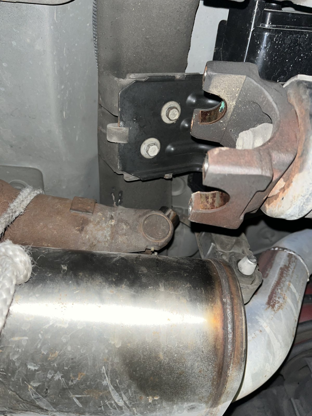

After replacing that window regulator Sunday afternoon, I hitched up my trailer to go grab some landscaping rocks (maybe 200-300 lbs altogether, at most) that my Tahoe Twin buddy was giving to me. Came home, unhitched the trailer and parked in the garage- all was well. Showered and headed back out to go visit my stepdad in the hospital. Never exceeded 4,000 RPM since leaving the house and had the cruise set at 70 once I reached the highway. About five miles later, I felt what seemed like a loose wheel or U-joint vibrating. It went away when I lightly accelerated or shifted to neutral. Accelerating felt strange so I turned the radio down and heard clacking. Gauges showed all vitals were normal. There's no lights or any safe place to pull over, so I eased it to a well-lit gas station and shut it down. Oil on the dipstick looked good and saw nothing external. Clacking sounded like a lifter but also deeper and like there was more than one thing clicking/knocking.
Jenn was nearby so she picked me up and brought me to Walmart to get a tow strap. Garrett (the "Tahoe Twin") brought a floor jack and jack stands. I jacked up the rear, unbolted the driveshaft and roped it to the muffler:
Yes, those appear to be original U-joints. 14 years and 218K miles WITH me beating on 'em for the past 72K... I don't know what's going on, but I can't detect any slack in them.
