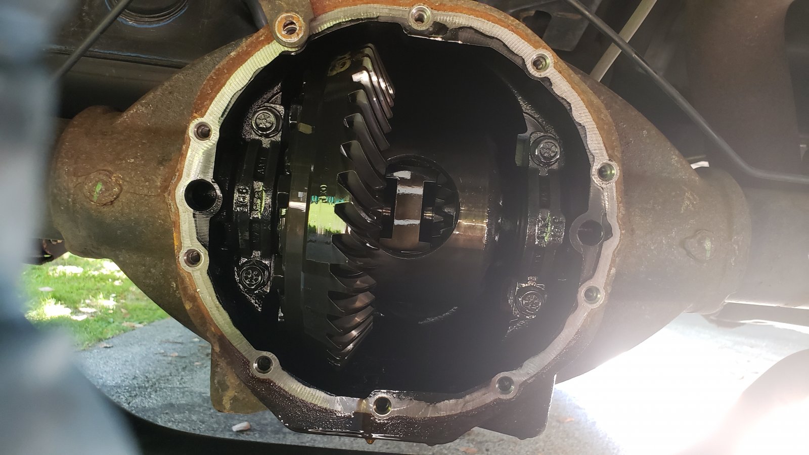

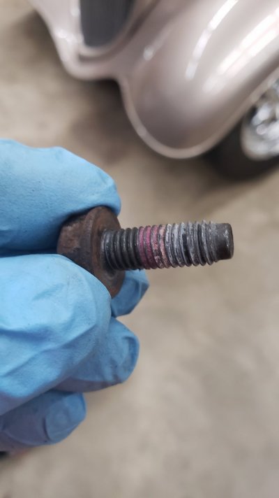

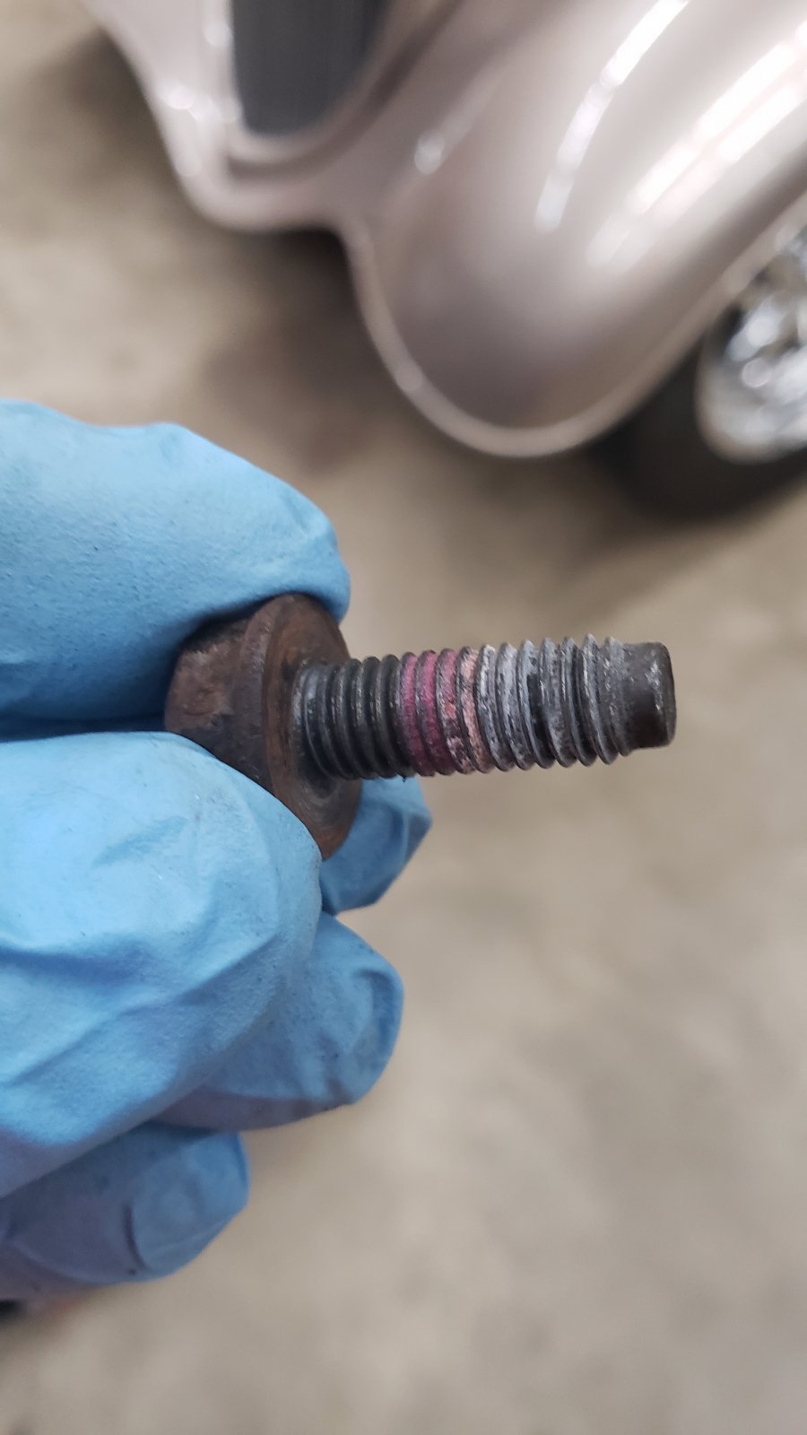

Doing the rearend oil, cover, and QA1 bar today. I dropped the spare and have the OE bar off, the lower sway bar links disconnected (for ease of access to differential), differential cover off and fluid drained. The fluid looked translucent like honey when it was draining. Did have an OE style gasket. Here's pics of inside cover and differential. Old bolts had red loctite on the threads, New bolts have lock washers but thinking of putting blue loctite on them

You sure it was red loctite and not thread sealant? Because red loctite usually doesn’t give up without heat added.

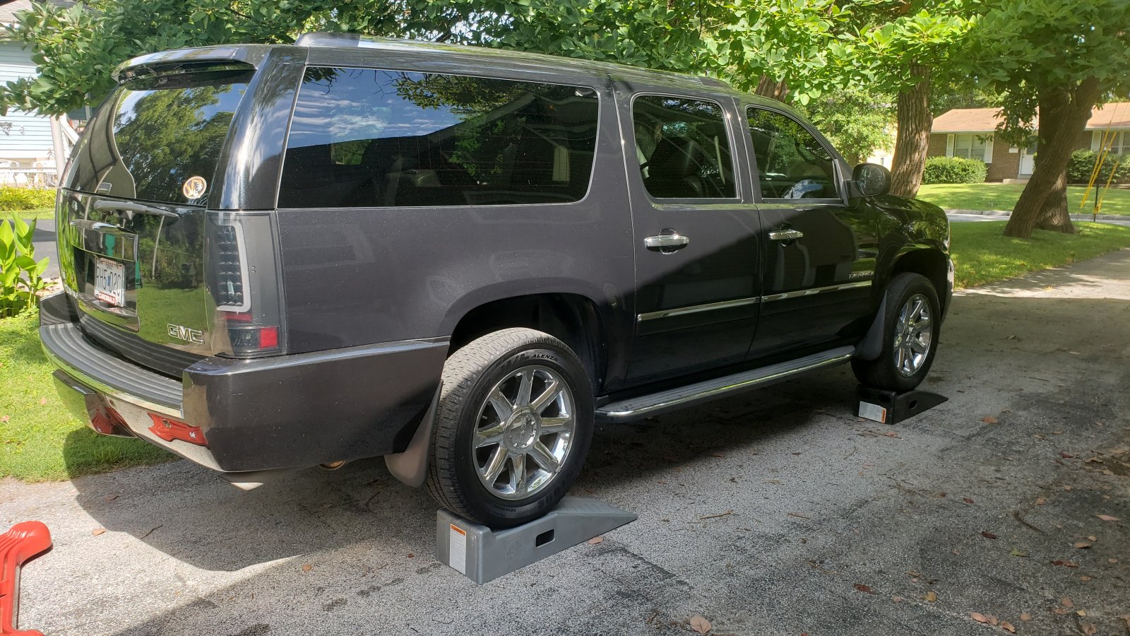

Good stuff!! Did you drive up on the ramps? I didn't think they would clear under the running boards but I never tried that way myself.

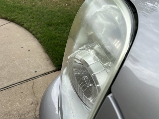

Swapped out the headlights and fog lights today. Think it woke up my sleepy truck a bit.

Yup. Don't forget my front is lifted 2"
Before the lift i could only drive up forward on all 4 ramps.
I decided backwards today so I didn't have to deal with the ramps taking up space behind the rear tires where I was going to be rolling around on a creeper.
