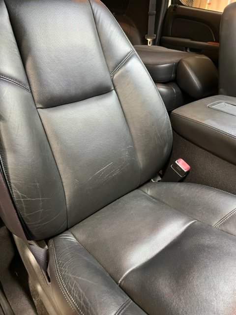

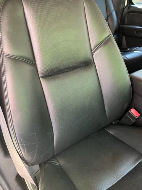

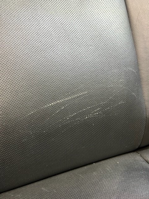

I fixed some scratches on my passenger seat. These were probably caused by some web gear or suspenders during hunting season. I used an autoleatherdye.com kit. So far I only did that center panel where the scratches were as a test. You have to put the dye on THIN to prevent plugging up the holes. I put on two THIN coats. It came out pretty well.
View attachment 376317View attachment 376318View attachment 376319
I did something like that to one of my rear captain chairs when removing a camp chair.
Nice scratch showing through to the leather underneath.
I used some holster dye I have on hand to touch it up.
I immediately regretted it; the dye was much darker than the seat.
Then I spent the next hour trying to thin the color out... :jester:
