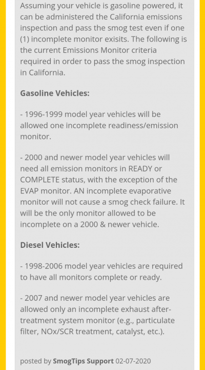

Well, got about a hundred miles on it so far, everything is ready except for the EVAP system...
Sort of running out of time here, not sure if it needs more cycles or if I do have an issue even though there's been no check engine light.
Do they make you have them all in a ready status?
Evap takes an insane amount of time to complete its test cycle, and temps have to fall within a range...
Here it's the one expected to be in a pending.
If I remember correctly, it all need to be in a ready state.
I'll have to double check, I know NY let me get away with one not ready.
Looks like I'm good to go then.

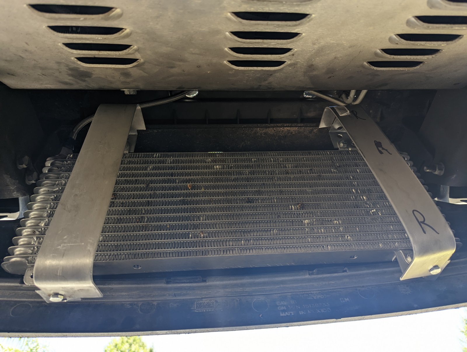

My bracket idea for moving the tru cool back down to the bottom again, going to drill a couple holes in the flat bar and mount it with the skid plate bolts, kind of subjects it to the elements a little bit but I've had it down there already for months and had no problemsView attachment 374032
Did you cut out the front of the bumper behind the fake grill? Exactly how Im wanting to mount mine
30,576
48,070
yes, did that last time I had it down there, I tried to have it up top and to the side a little but that didn't work either, kept getting the engine hot so it's down below again a transmission is cheaper than a engine :shrug: the chrome piece comes off but you have to be careful the little clips break very easily I broke a few but it still stays on, then I used a fein multimaster tool with just the bracket on it and it cuts thru plastic like butter

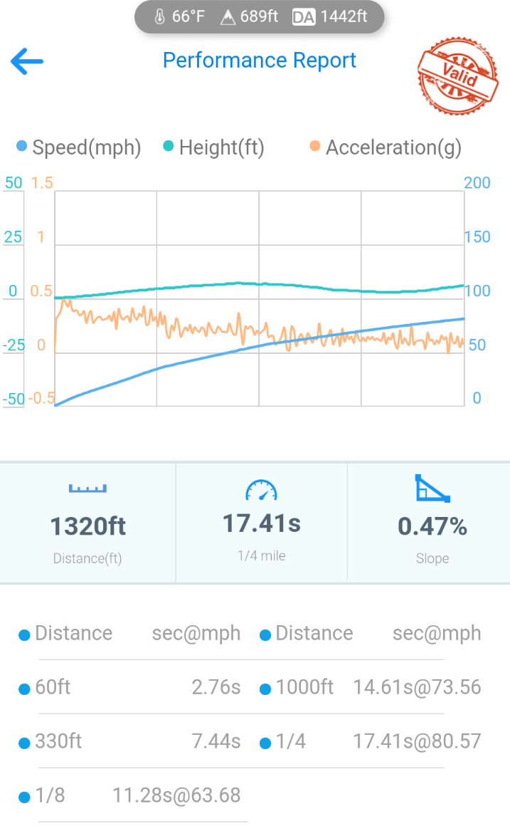

Regular 87 & Stock(catback only) is junk! Only pulls .5g acceleration, so slow, and so numb.
This wasn't stalled up or anything, just matt the pedal.
