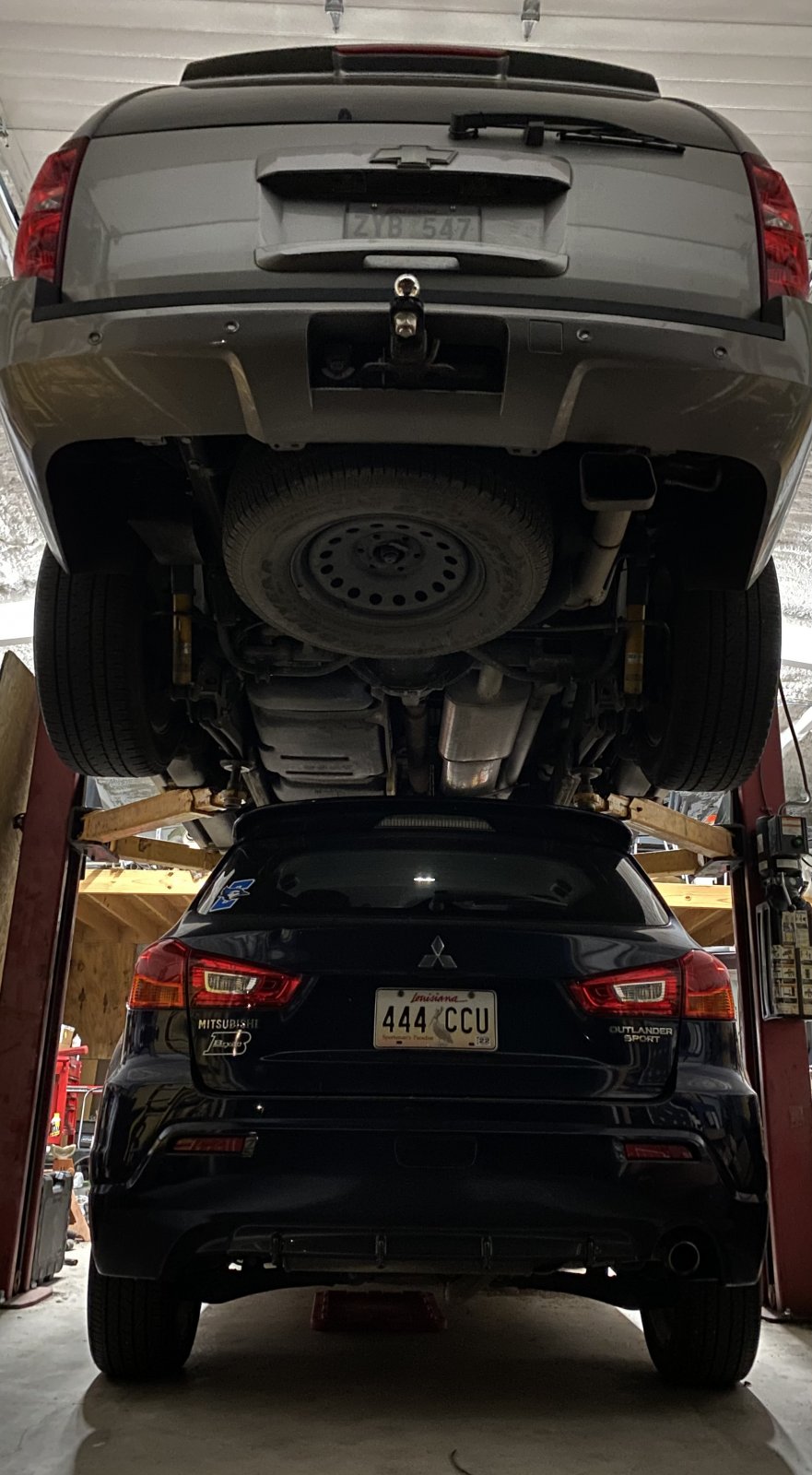

They're forecasting a decent chance of tornadoes and hail today, so I put it in the shop on the lift and Jenn's old car underneath.
