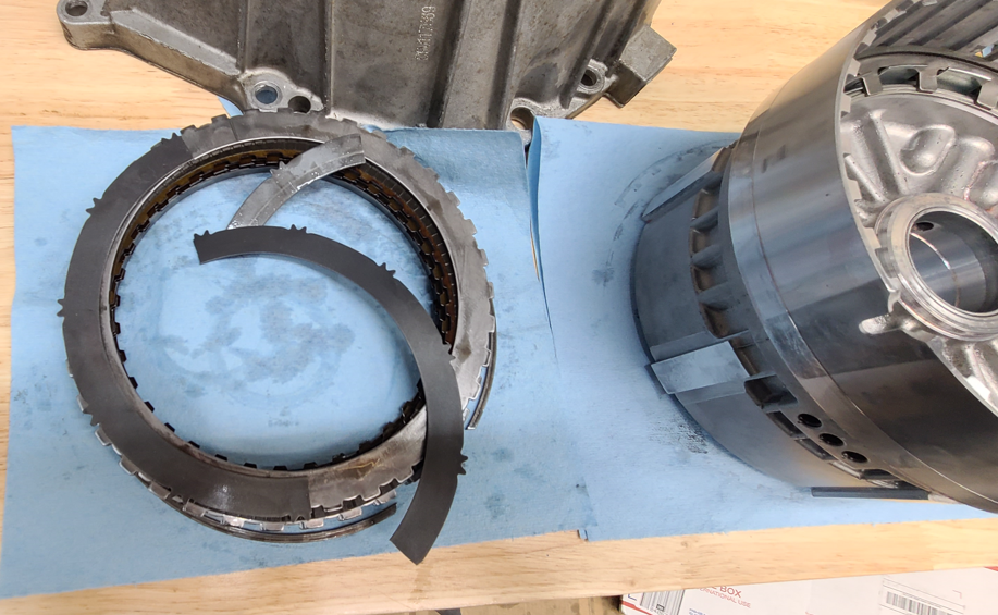

Found an unexpected surprise while making sure i have everything on order that i'll need for the transmission rebuild.
2-6 wave plate broken in 3 pieces?!
I have no idea how long it has been like that, but I didn't notice any weird effects.

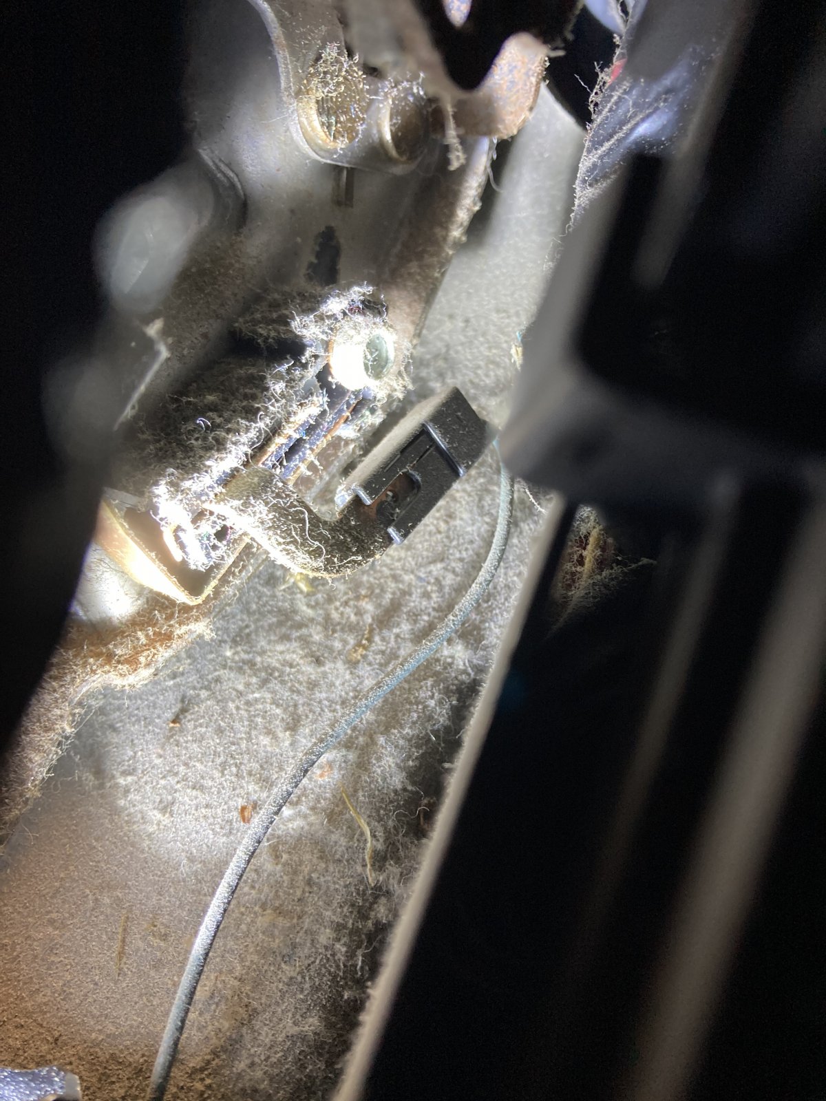

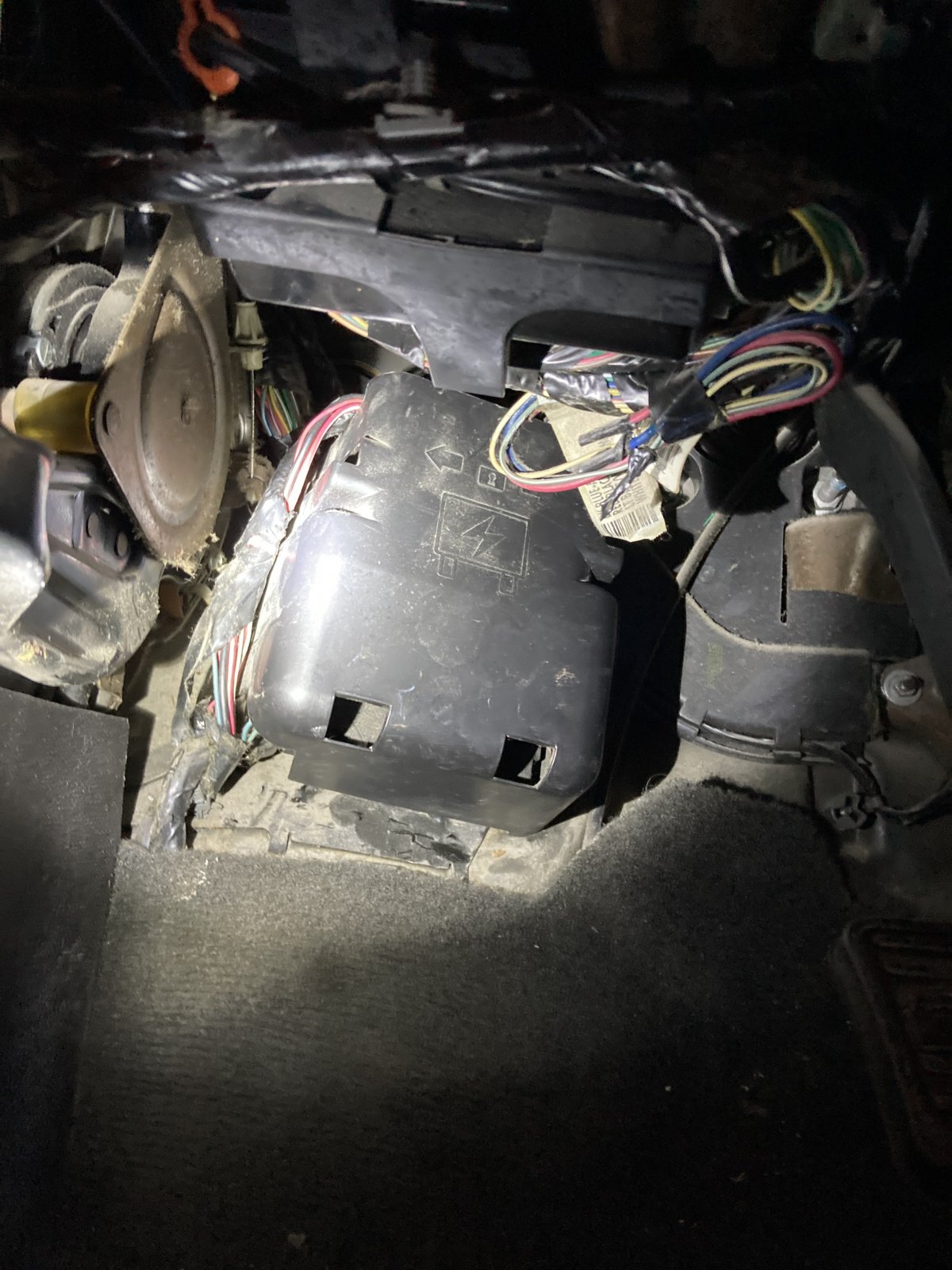

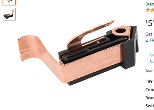

Yeah climbed under there tonight to check out the parking brake switch.
It should look something like this if I'm not mistaken.
That’s the one. Yeah climbed under there tonight to check out the parking brake switch. It sure is buried deep in there. Also can’t believe how much lint is stuck under there. That may be why it is not working. I’ll tear that sht part this weekend and vacuum the hell out of that area and try clean up the switch or at least test it.

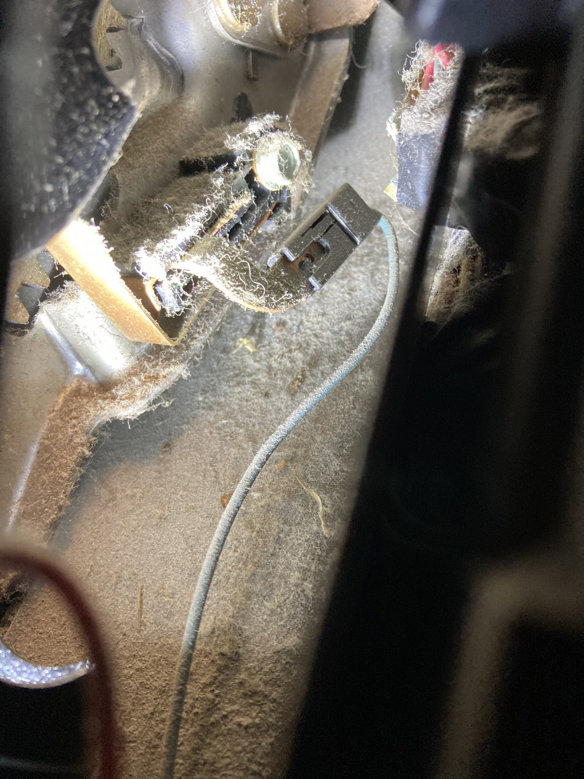

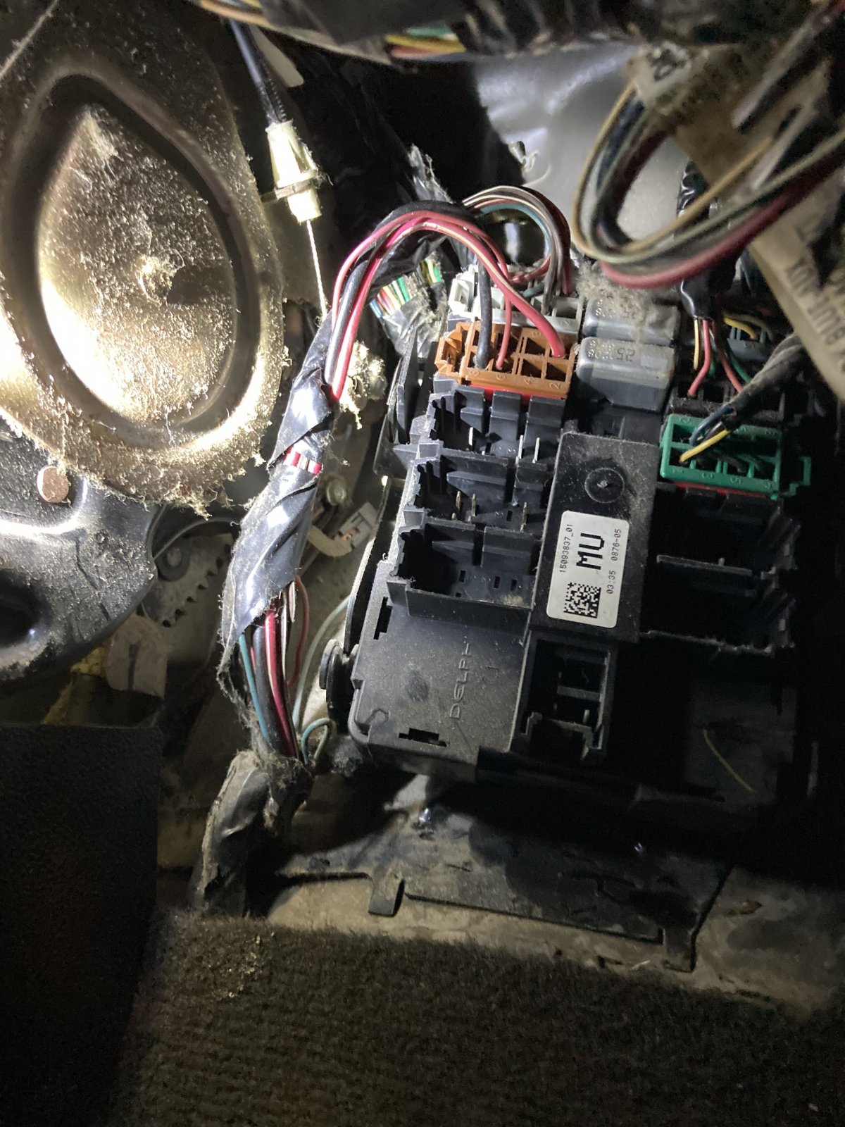

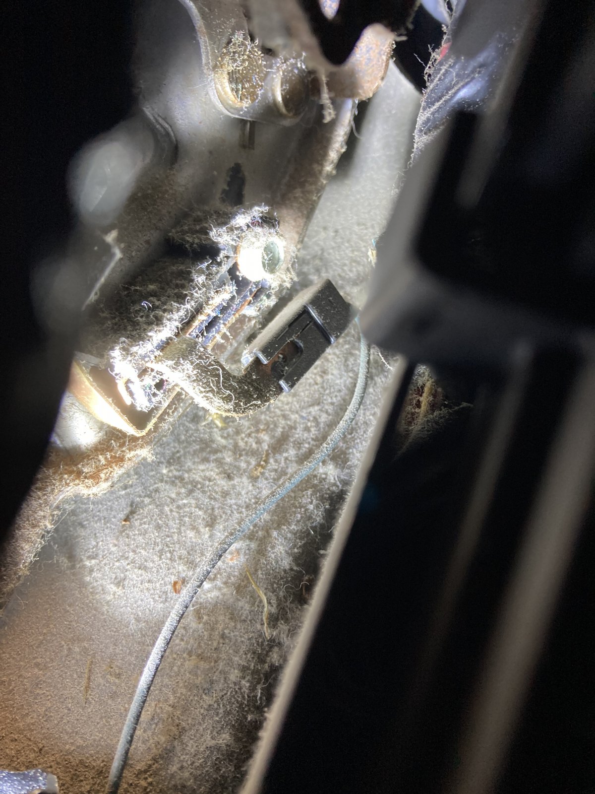

View attachment 366333View attachment 366332View attachment 366334View attachment 366335
I would use some compressed air to blow it all out and then hit it with some contact cleaner. if you have any maf cleaner sitting around it will do the same thing as contact cleaner
