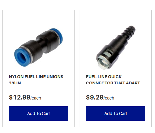

The 3/8 line goes directly into the pump and the 5/16 just connects to a black hose inside the tank and goes down into the netherrealm somewhere in the tank. You can't pull it out so have to disconnect it from the bottom of the pump mounting plate as you rotate the pump/float assembly out. I am assuming that is a return line?? I think the parts Fless posted are the ticket. Doing some parts research now. I can use the dorman union fittings to make the connection just need to figure out the transition to the connectors for the steel lines. They all look different online compared to what is on mine retaining clip wise.
I stumbled across this list of parts on O'reilly's website that looks promising!
