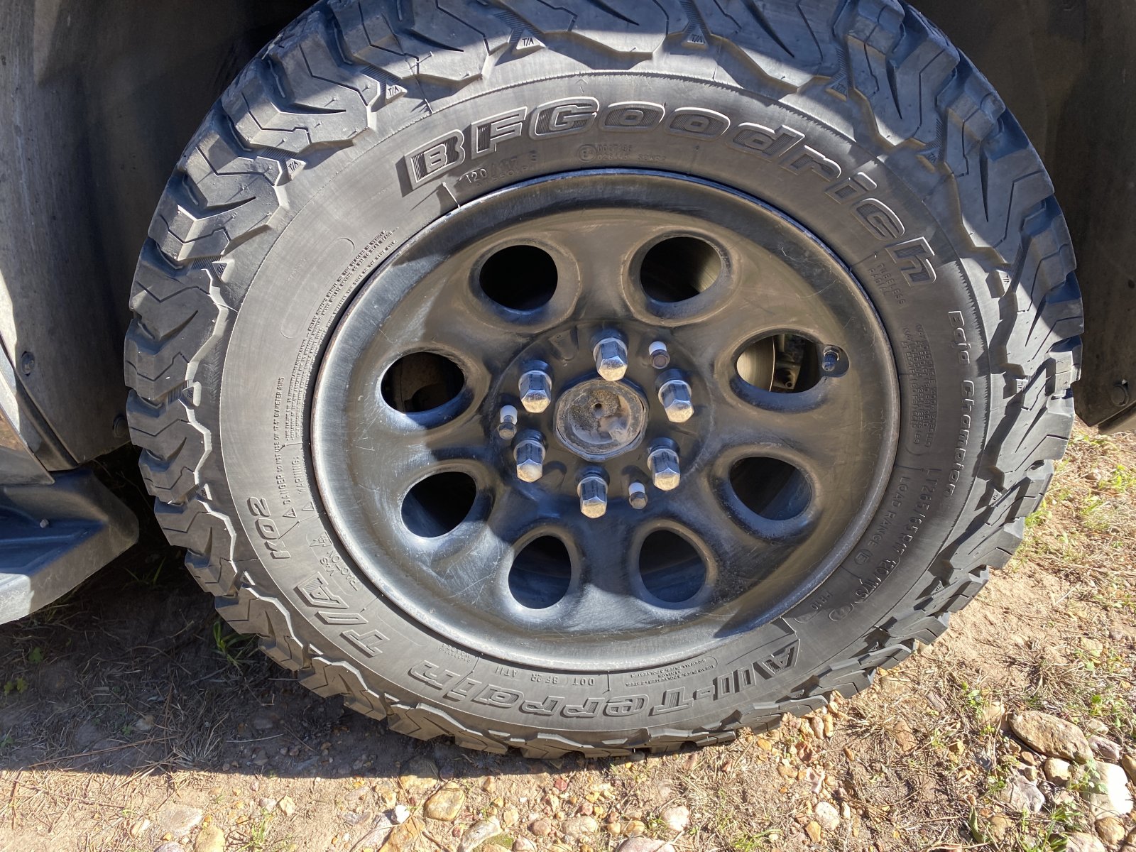

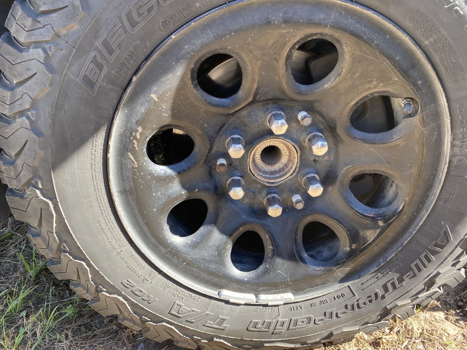

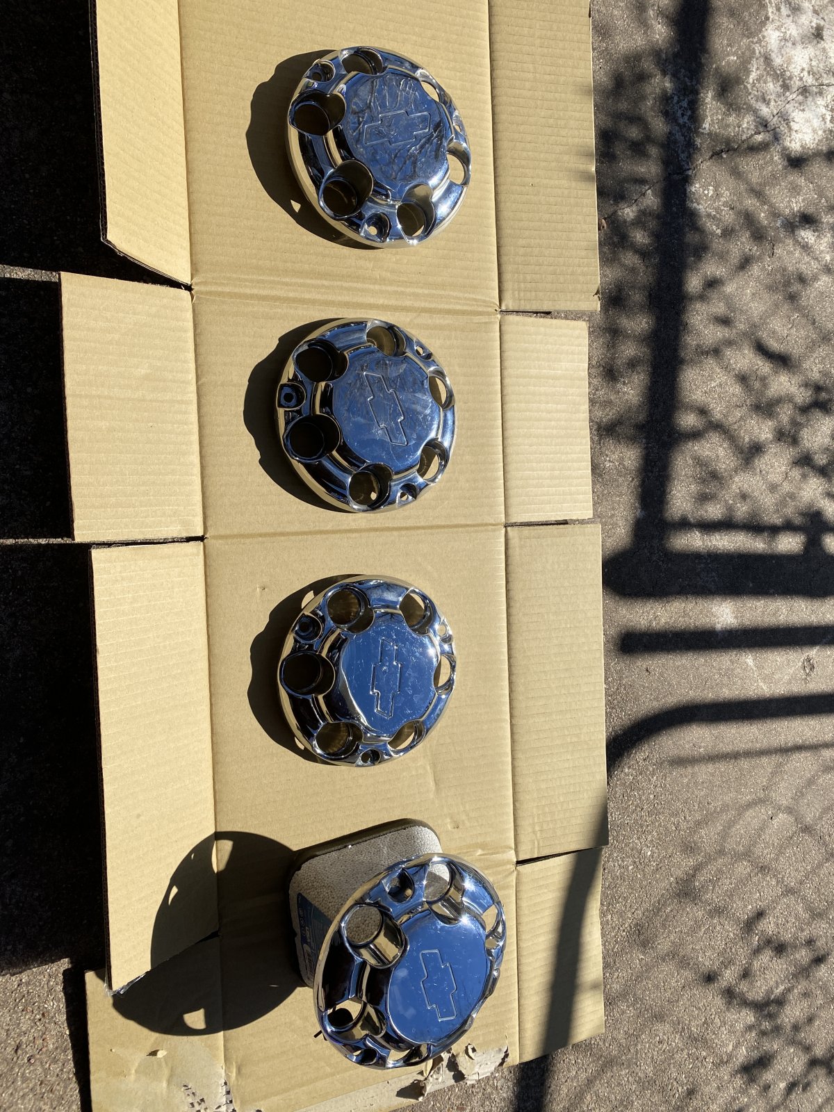

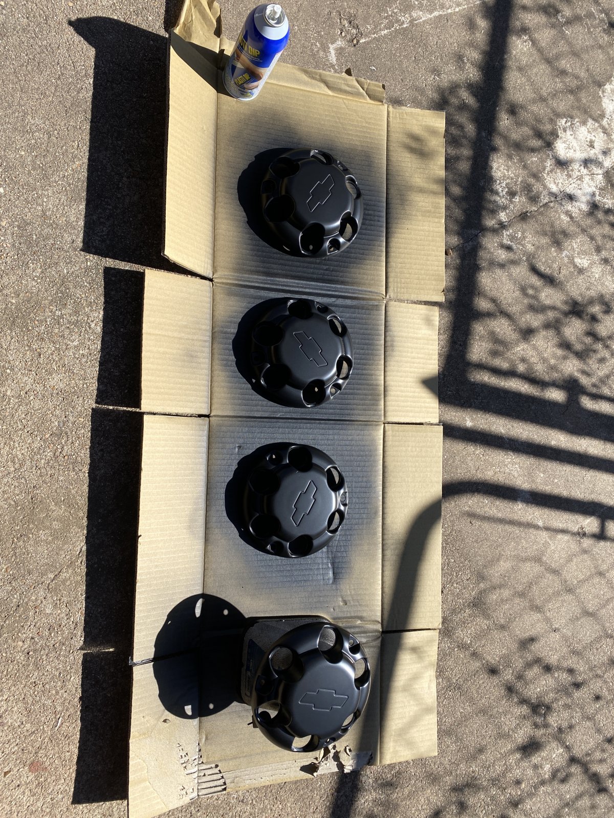

During the recent “Trip to the Desert” (C), you might recall my mention of the missing center cap spacers. After a few days, the look kinda grew on me, but the hub was definitely a gap. I thought about getting some of the black caps from the K2xx PPVs, but they’re still $60 each. Plus I’m not totally convinced I’ll like the look.
Enter Plastidip. I thoroughly scrubbed the caps in warm soapy water, then wiped them down with alcohol.
I’ll do another coat or two, then see what they look like mounted.

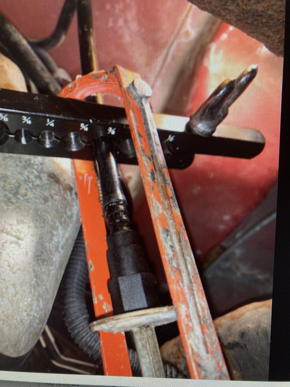

Look at this guy's trick with a flare tool and a caulk gun:
I actually tried that when I was doing mine, and possibly referenced that same image! It wasn't working out so well and I found I could do it by hand- with gloves, cuz it was hot. I did hold the hose with the same kind of flaring clamp, though.
