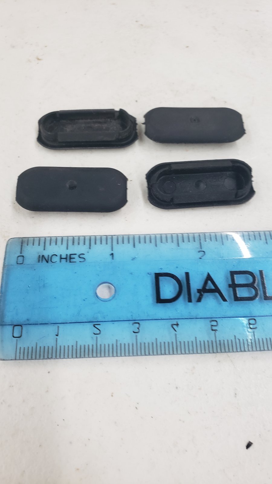

I drilled a couple holes in mine no more fish tank
Why drill when there's holes already there, just plugged with rubber/plastic plugs?
They look like this, and are in both front and back doors. I think the rear doors of the LWBs have 2 each, while the SWBs have 1 each 20211230_184713.jpg

Just pull the oval shaped plugs out that are under that plastic flap and keep them out
Ah yes, I forgot about that, thank you.

There is also a small drain hole in the rear most corner of the door where the sheet metal folds meet that is the actual "drain", but it is small and gets clogged easily. I used to take a small zip tie and use it like a pipe cleaner to clear out this hole, then I found the bigger ones that have the plugs.

What part of the rear doors in a YUKON ( 2007 ) are these plugs located ? Obviously near the bottom to drain water.
My rear pass side door retain water sometimes. Never knew to look for these plugs.
Thanks in advance

Kinda answers my previous question. Will be looking to pop out the plug on one of my doors when the snow melts next week

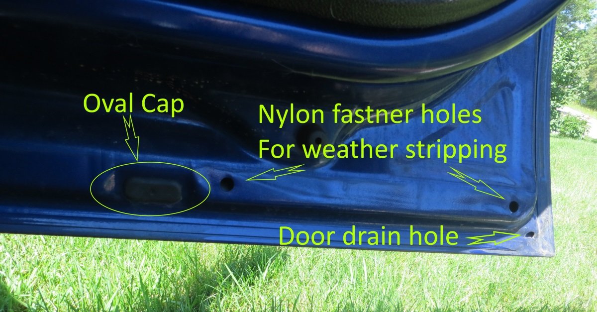

Thanks in advance
Along the bottom inside edge is a plastic weather strip "flap". These oval plugs are under it. download.jpeg
Yeah, I knew about that one. That's the one that I jammed my Leatherman tool into when I parked at home, and got the door to start draining.
Opened and closed it really quickly a few times to let centrifugal force help get the majority of the water out.
It'll be a dry weekend though. So it shouldn't be an issue. I've done much worse to a lot more important areas of this vehicle anyway. Hahaha
