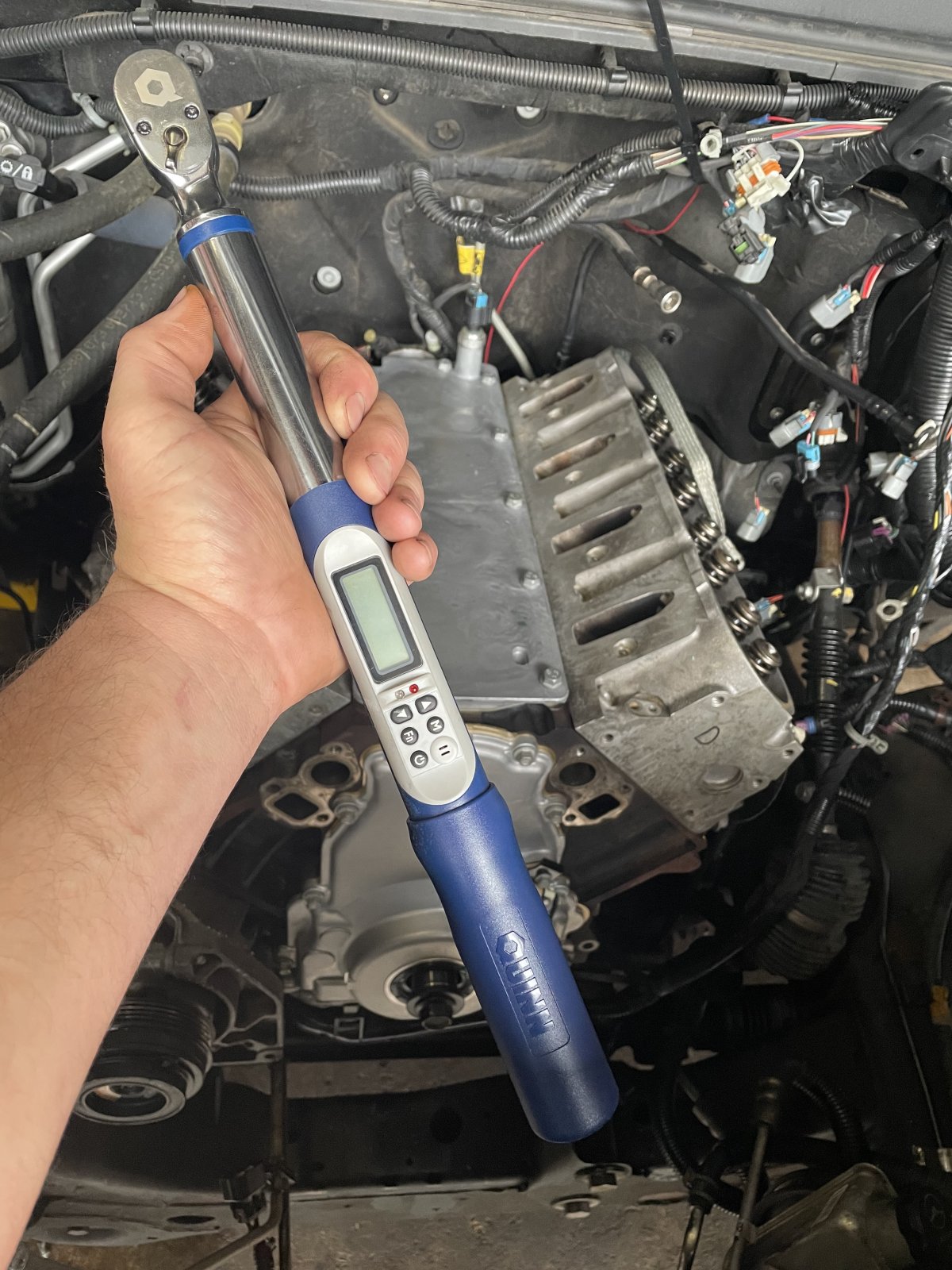

Just a heads up, this Quinn torque wrench has performed flawless. Especially handy on the angle specs. I was hesitant about using it but it’s been good.

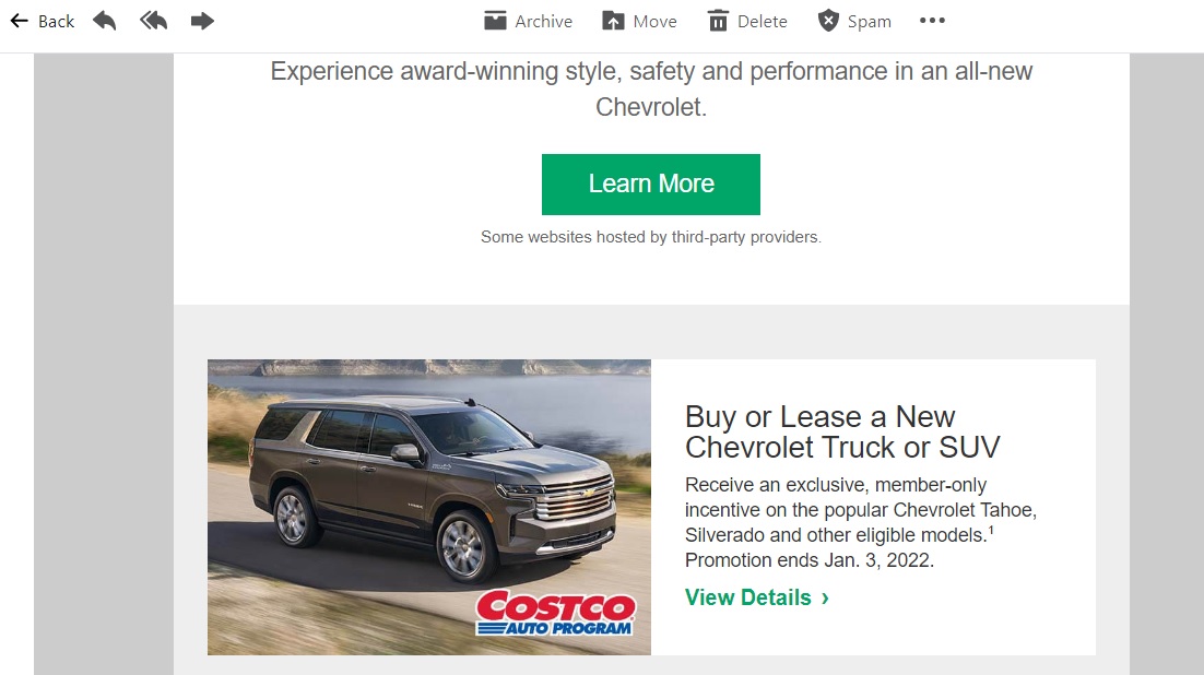

Just saw this Costco Chevy Tahoe View attachment 359269fleet order style incentive purchasing email
I wander what the true $ discount is ?
