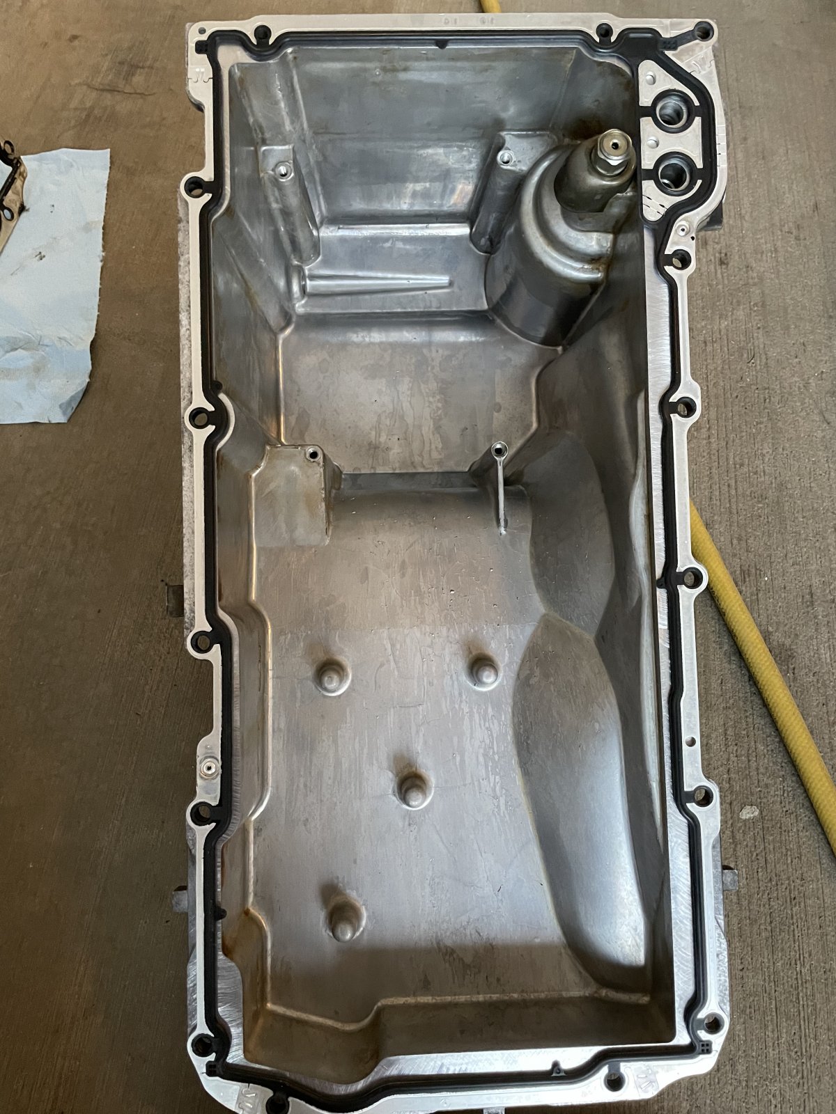

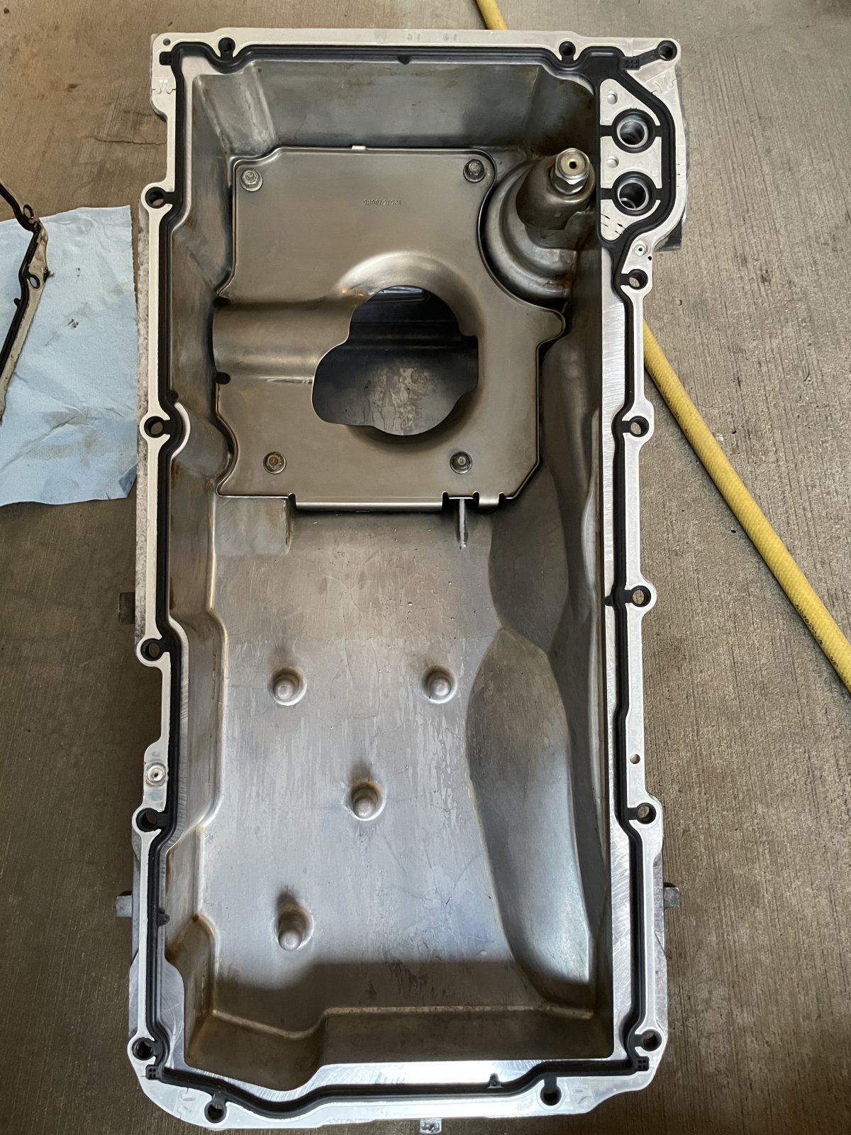

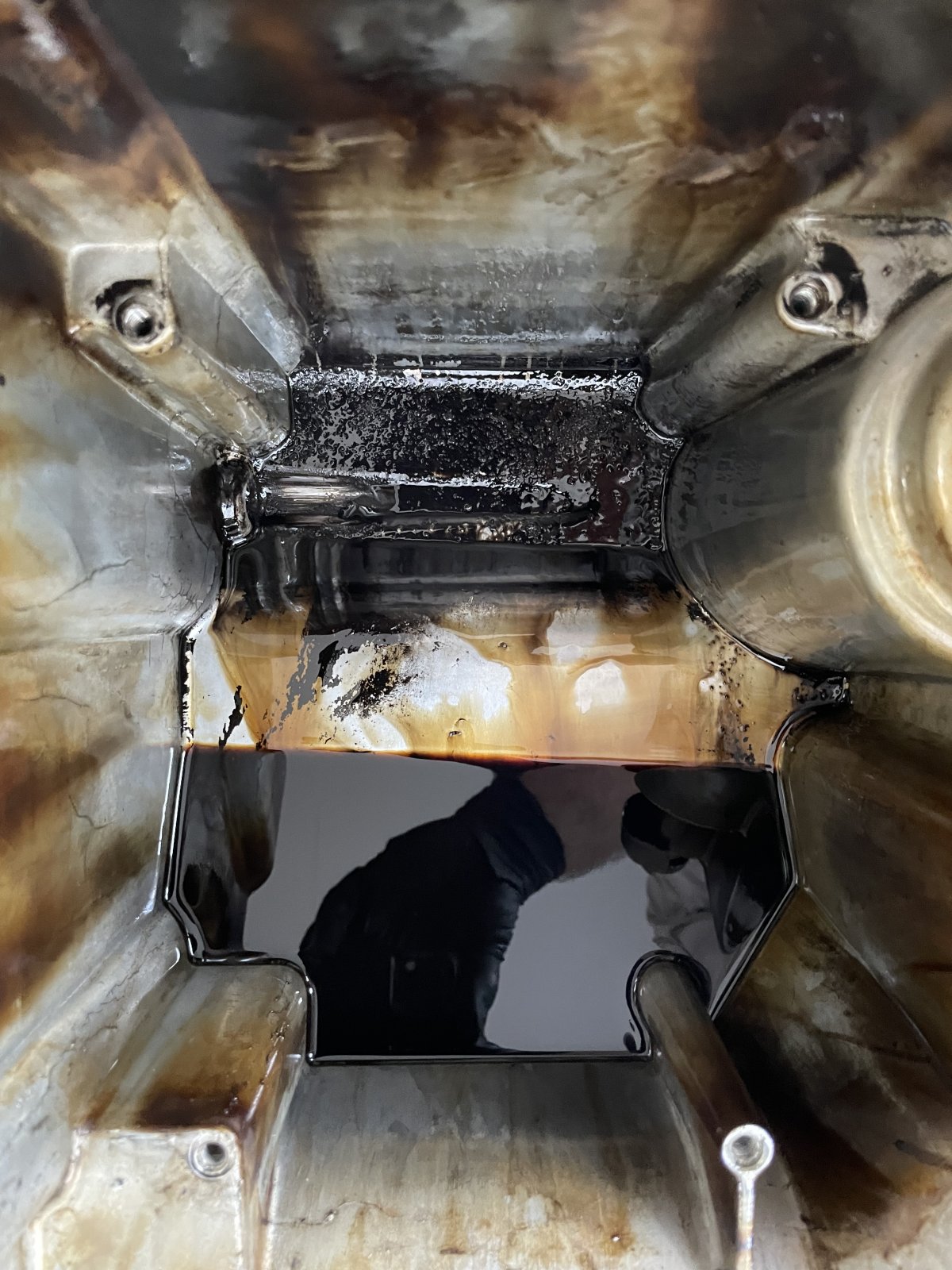

It wasn’t too bad. Still a bit more sludge than I’d like. About 1/8 inch layer in the bottom of the pan. Maybe that’s normal at 150k. It’s been through four oil changes since I’ve had it. Each time I’ve substituted 1/2 quart of ATF in an attempt to provide some extra cleaning action since I don’t know the complete vehicle history. It has helped quiet down a noisy lifter.

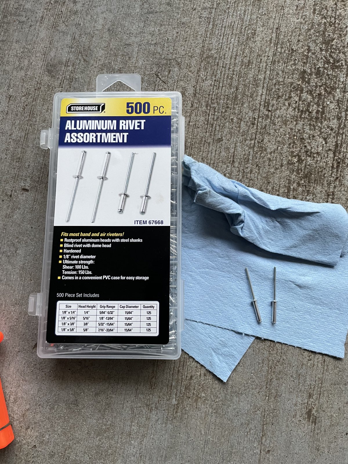

Got it cleaned up and a new gasket riveted to the pan.
cmatt
Apr 29, 2009
637
702
Per the service manual, the rivets aren’t required to be replaced. But I’m OCD. It allowed me to get it perfectly centered and the gasket didn’t budge at all during installation which was nice. My guess is that, at the factory, the oil pan is prob put on with the engine upside down. So the gasket needs to be held securely to allow for higher production rates.
I’ve seen folks use zip ties which seem effective.

I went with the no rivets on the oil pan install, wasn't hard to keep centered.
I also for some reason felt like the rivets could get in the way, but I'm sure it's away from the sealing surface anyways.
:jester:
52,949
:jester:
They don’t. You think if they did, the factory would use them? You’re killin me man! Just look at them. They’re recessed.
Edit: also a note- if you’re 2WD I’m sure it’s easier, or if you pull the front diff. I just had mine drooping so it’s hard to wiggle the pan in place and not have the gasket hit on something and fall off so the pop rivets worked awesome for me.
