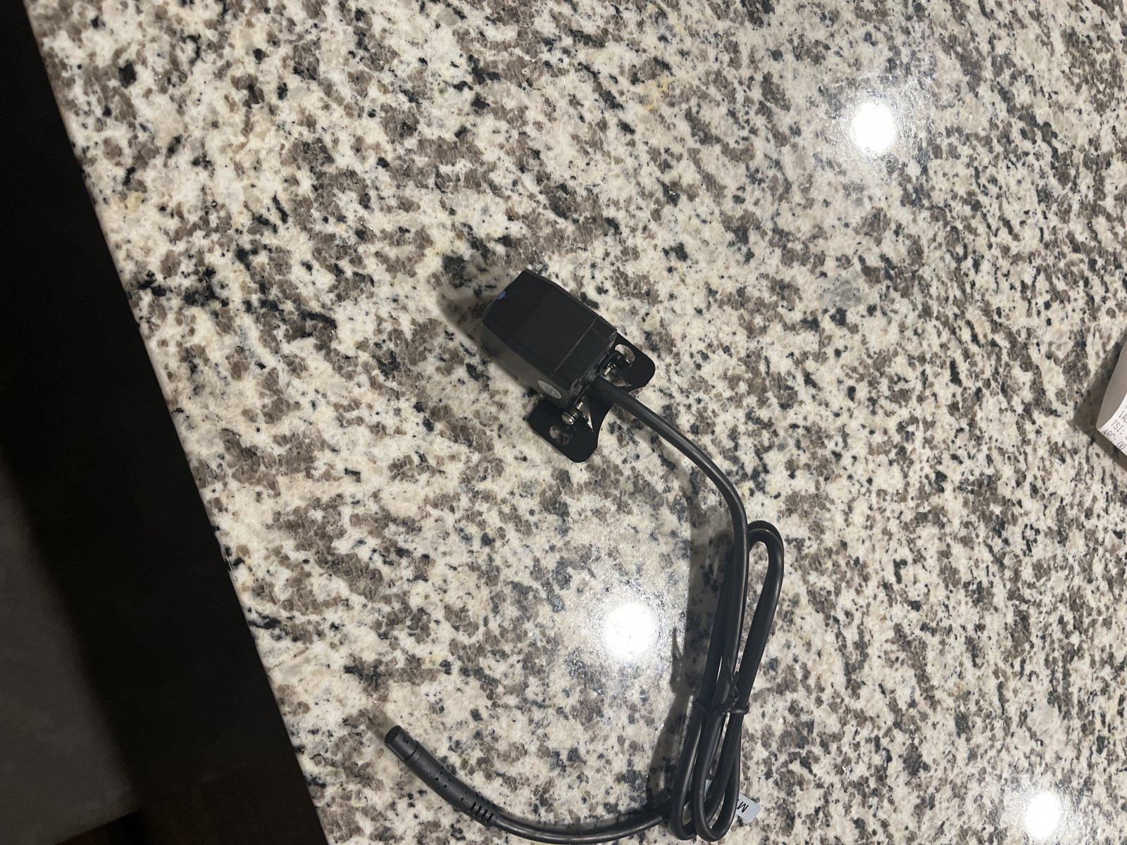

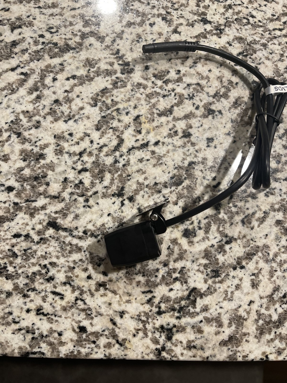

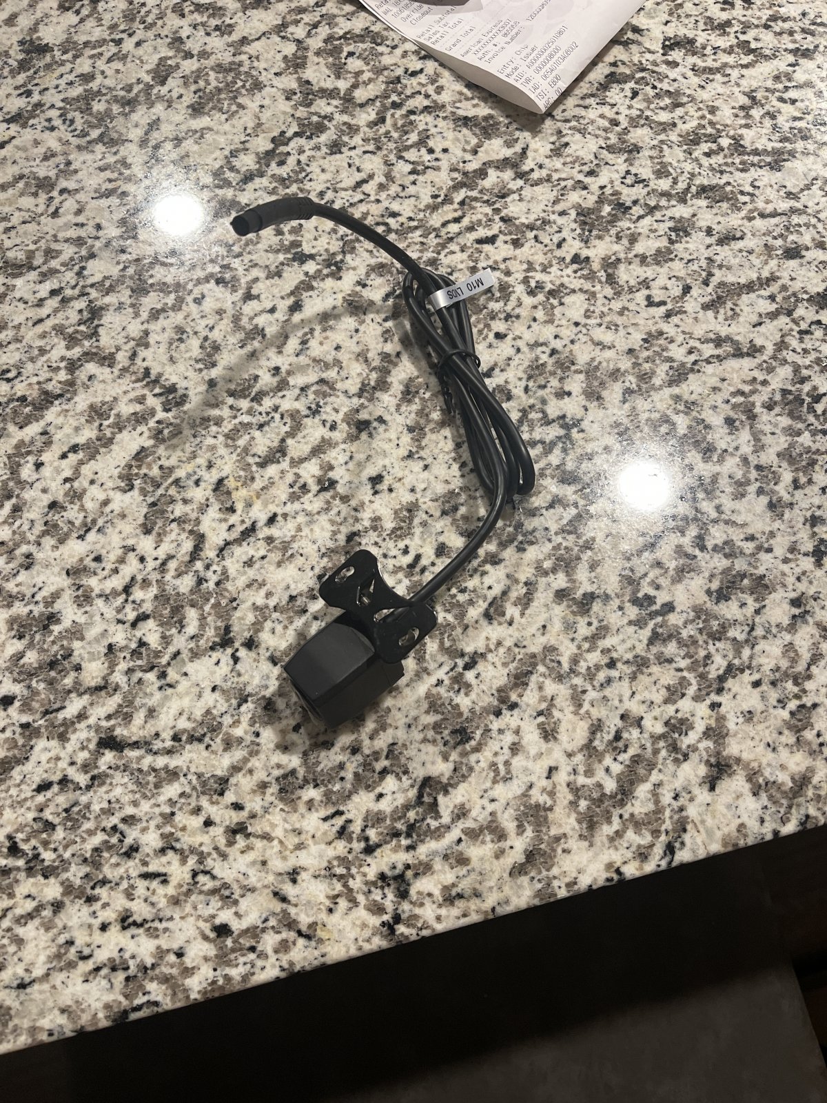

Y’all remember the airbag issue/seat position sensor I’ve been trying to figure out for the past month? Well i finally gave in and took it to the dealership. So apparently somewhere in the harness there’s a shortage. Go figure.
On another note. When i get my truck back I’m going to install this rear view mirror with camera myself. The rear camera is going where the oem camera is going under the tailgate. Should i just drill the camera directly or there or make so kind of plate to put the camera on, then mount under the tailgate.
If you take the piece off, you will see the indentations for the camera, the mount and the holes, or where they should be. They were fused in with melted plastic, no screws. I used RTV on my replacement panel and it still changed the view a little from the original position.

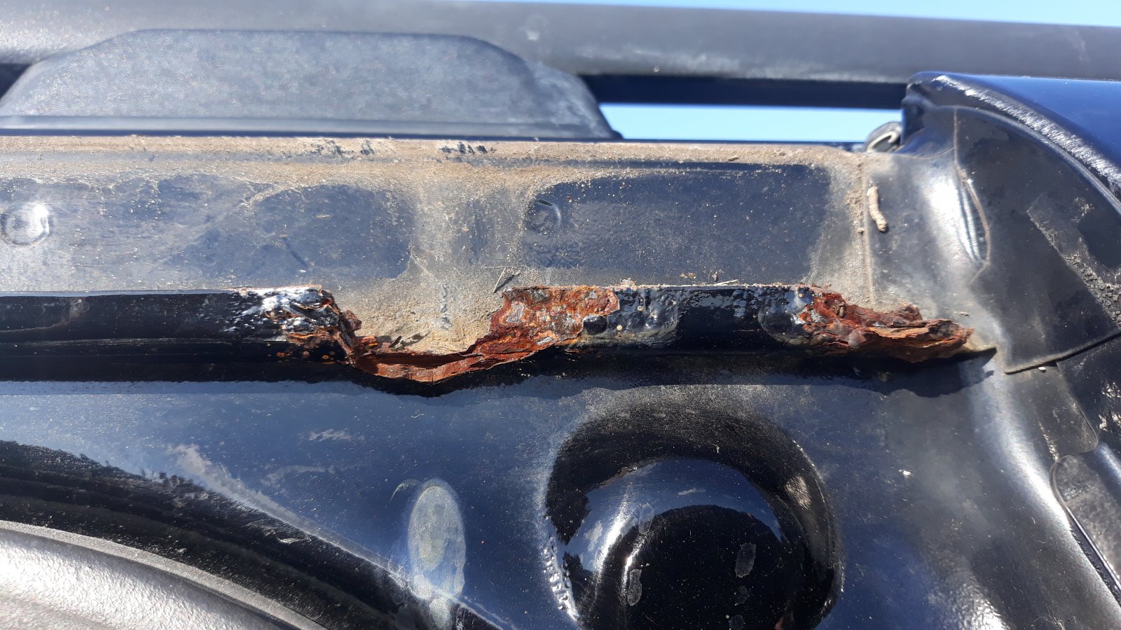

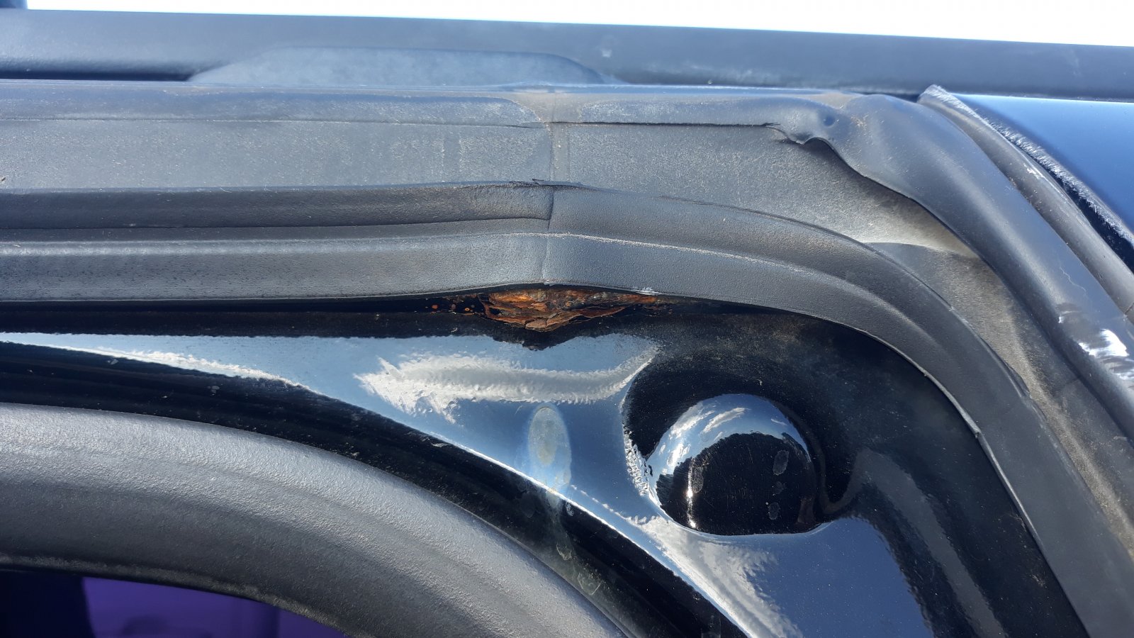

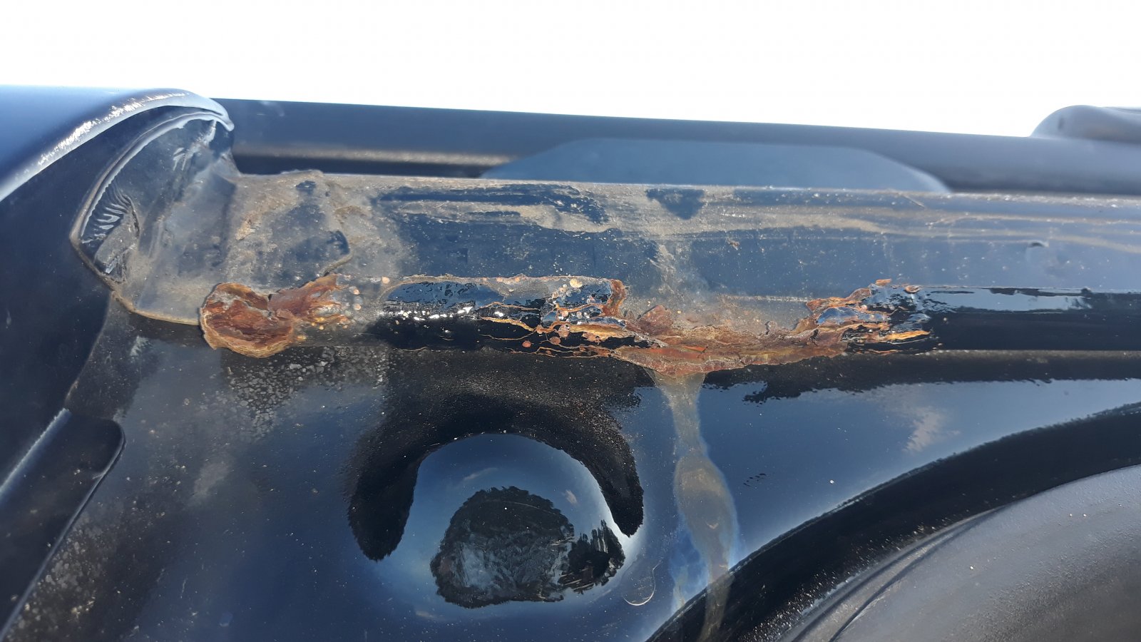

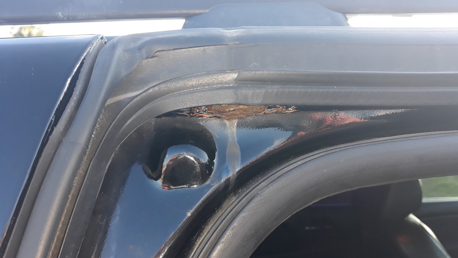

Check your Drip Weatherstrips fellas!
The top portion is just friction fit, you can pull them up and clean under there and put them right back, wish I'd known this years ago.View attachment 357711View attachment 357712View attachment 357713View attachment 357716
Holy sh*t that salt gets everywhere. I don’t have that problem here but I did find out about pulling that weatherstrip many years ago when I removed the side trim on the windshield in order to paint it. That looks like it’s gonna be a challenge to fix but at least you caught it before it’s too late.
21,278
30,213
The only thing I could do from home quickly was to grind away the bad stuff and paint over it. Should buy a few more years. Eventually, a new section of drip rail will have to be fabricated and welded in.
