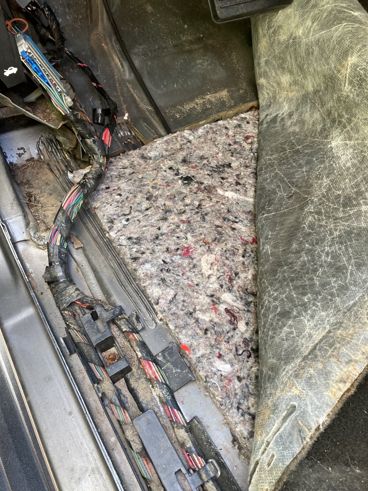

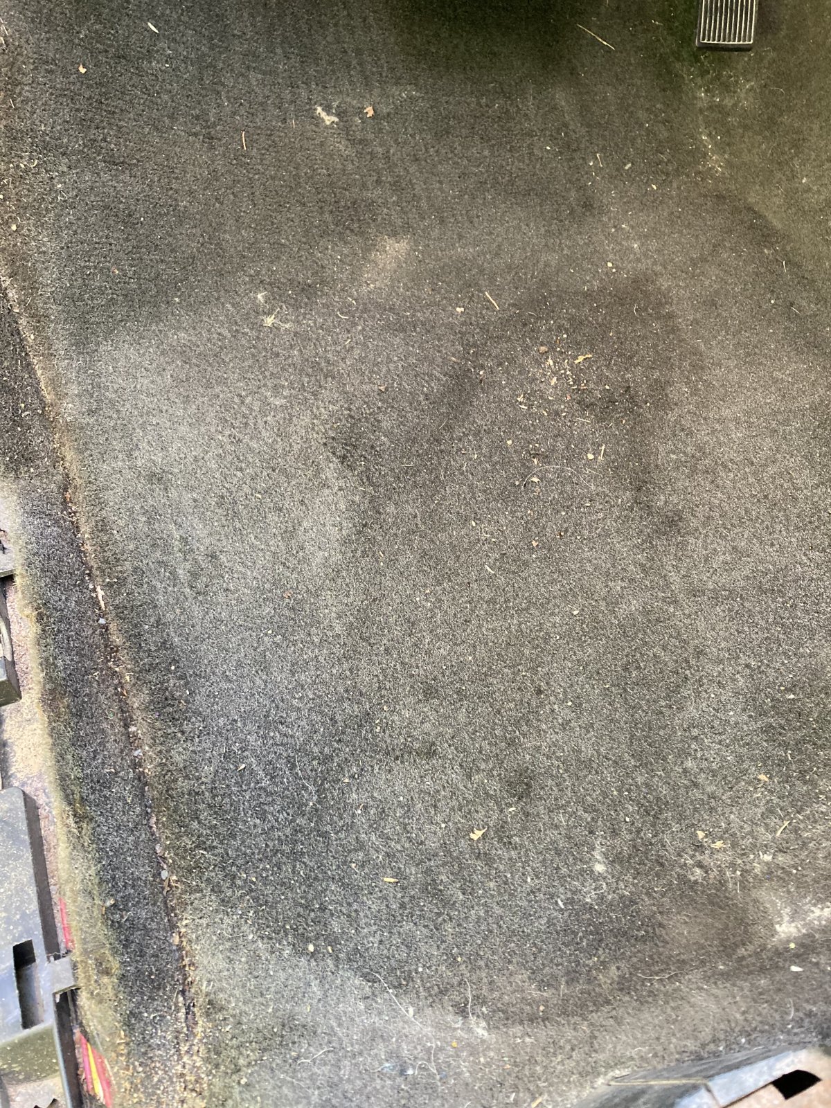

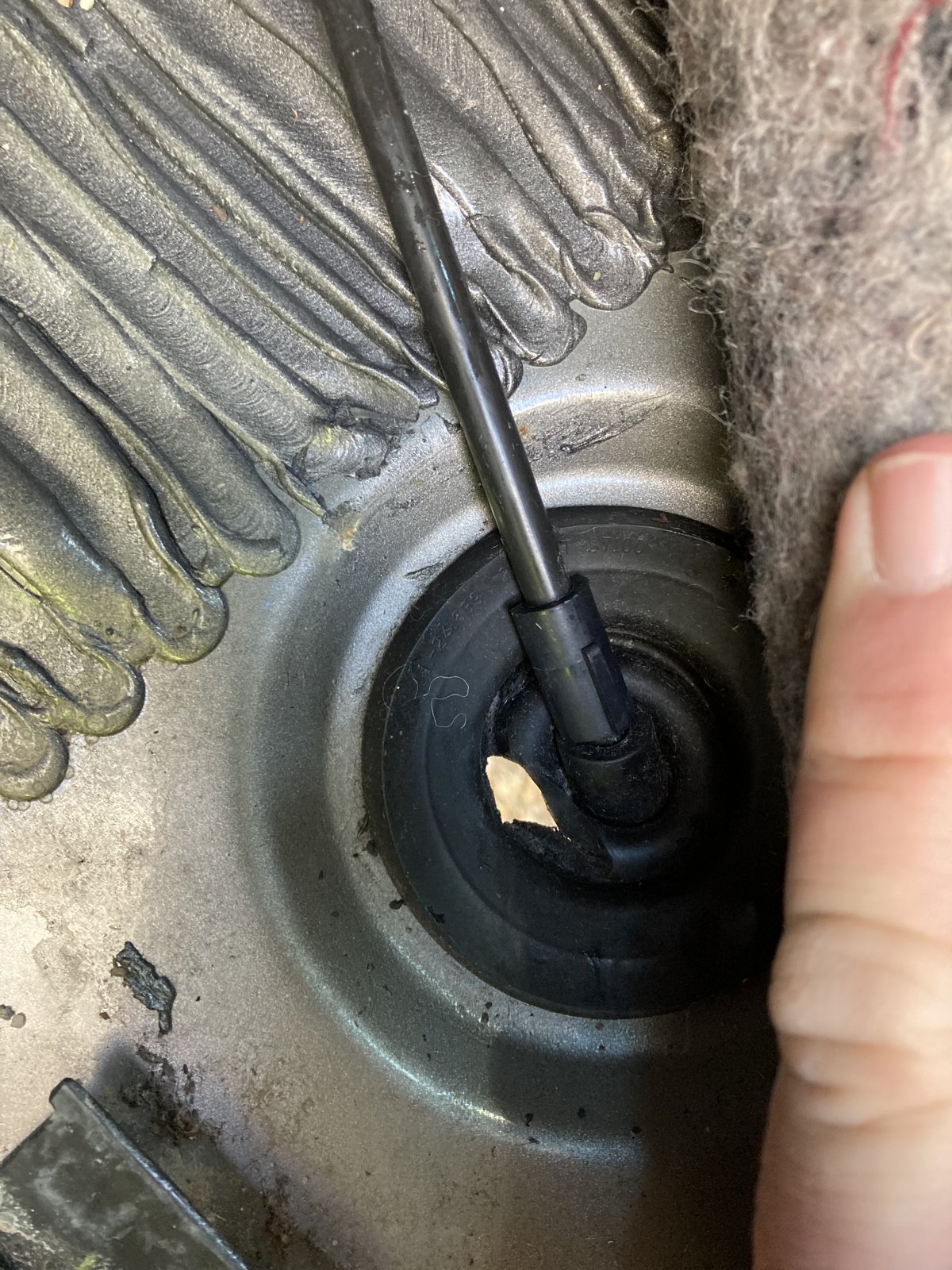

Agree with Wes. Water doesn't travel uphill unless it has a siphon effect. There's no way enough would splash through there to see.
You don't think the front tire would sling it up? Or the car under wash jets? The lower part of the sill plate is bone dry so that is what's got me scratching my head.
