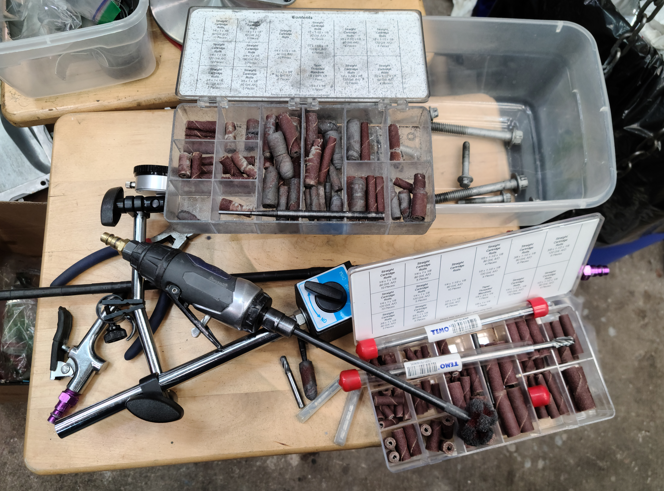

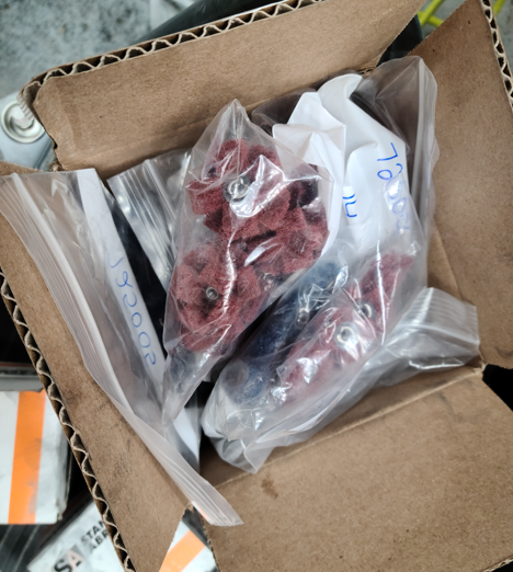

Mmm pretty porting tools!
And my precious.
(box of 3m cross buffs in all sizes, grits, and even little ones that fit in the oil pump passage ways)
Got some in here that i used in a few choice locations in the block.
it should flow oil good yes yes.

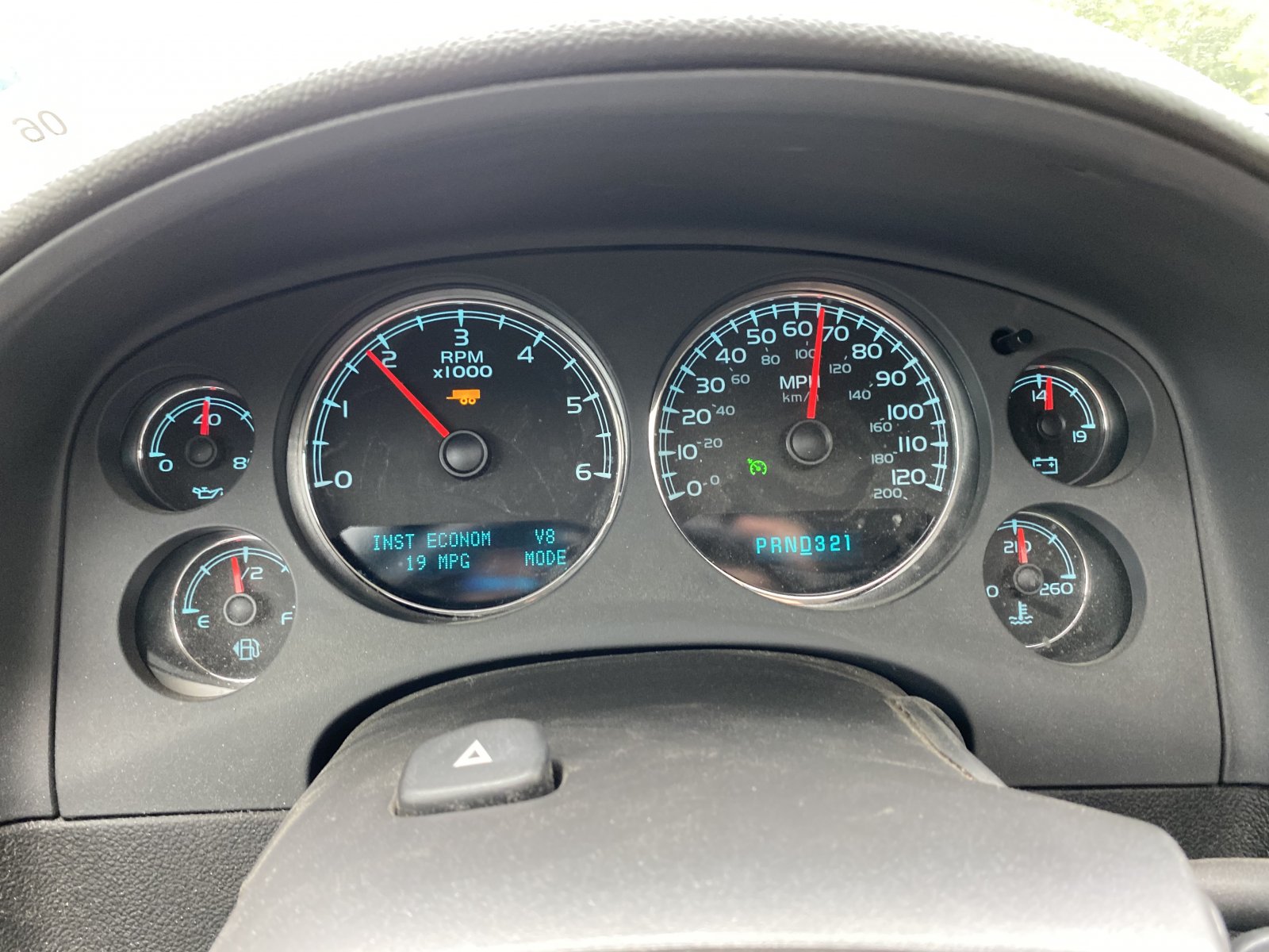

Did nothing to it today other than watch it drive away. Jenn's back behind the wheel.

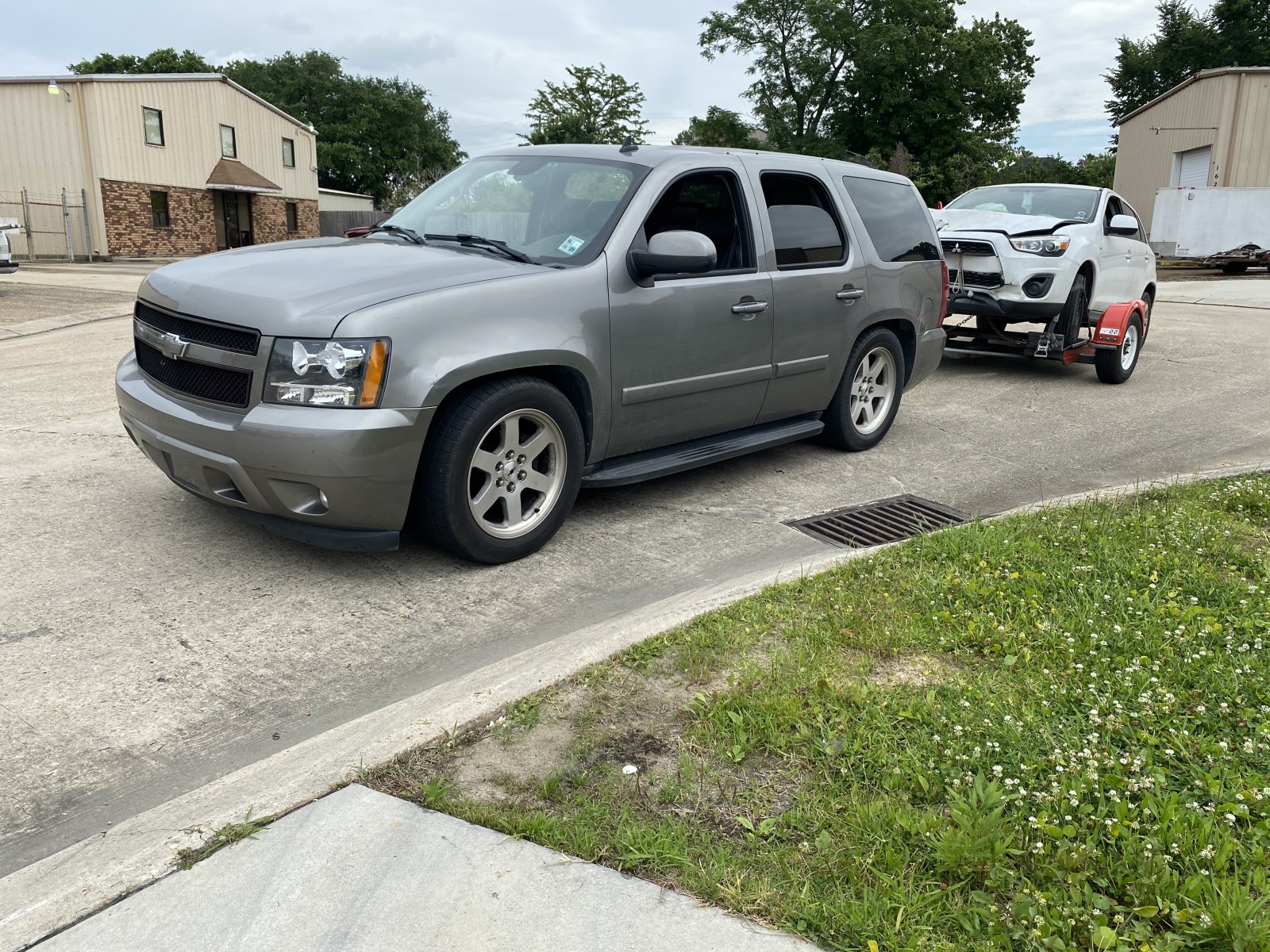

Yesterday, after filling the tank with ~$80 worth of Exxon 93, I took it and a tow dolly two hours away to Gretna (south of New Orleans) to bring home a parts car:
Yes, I'm (again) towing on my Jeep Wrangler "drop" coils and Airlift bags. I might could've used 1-2 PSI in the load bags to pick up the rear a hair. But, it sat level, rode fine and wasn't dangerously squishy at all. Not once did it feel uncontrolled. I'm still running the air that was in them when I picked up that golf cart from Tampa back in November. Haven't touched 'em since.

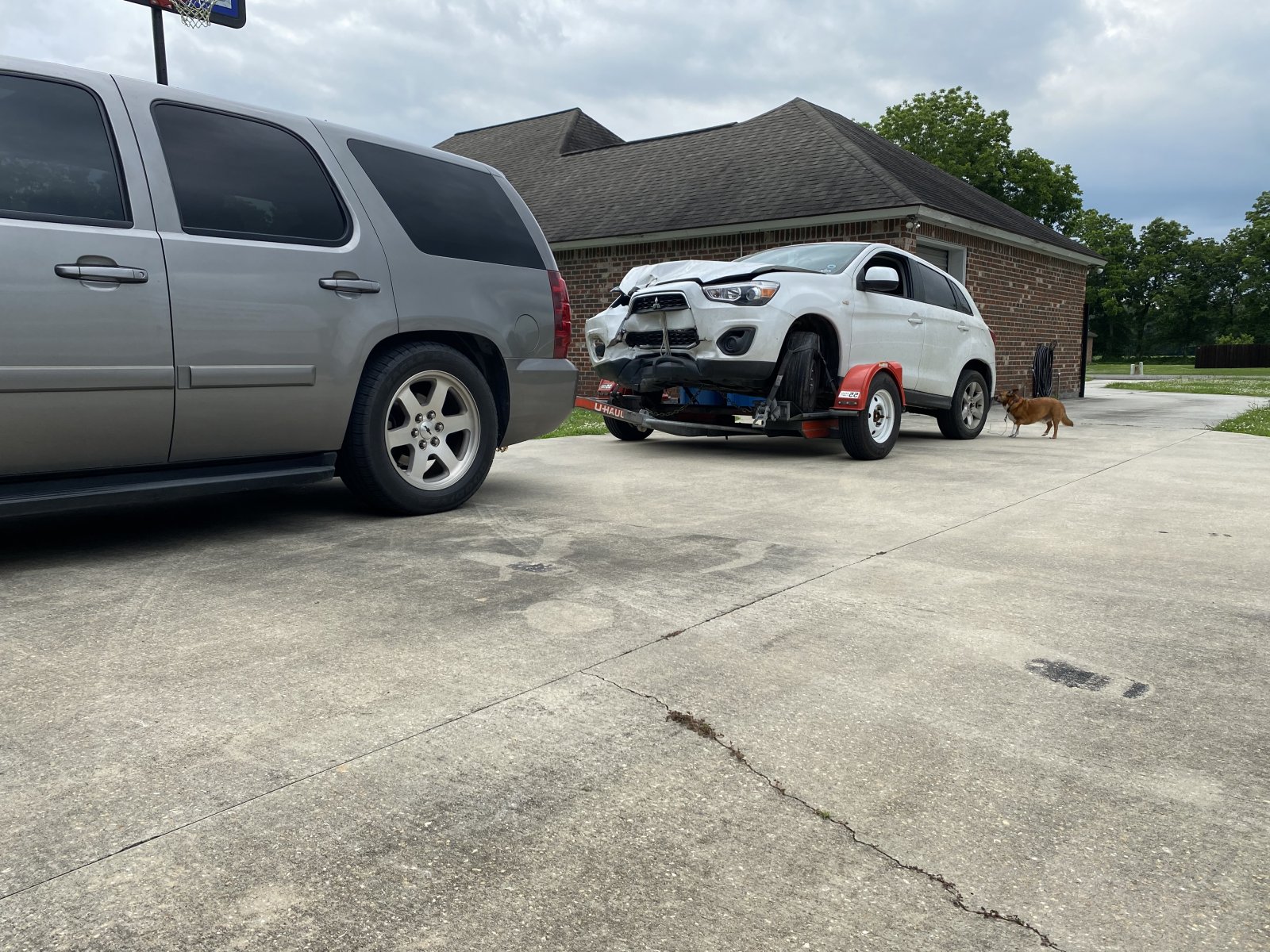

Had this ugly mug tailgating me for two hours. 81° ambient:

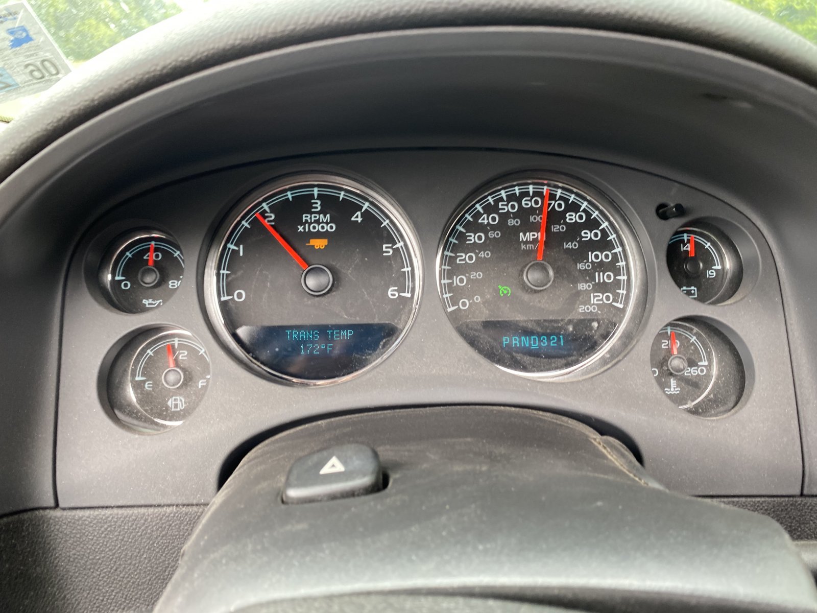

Yet again, I'm proud of this 'ol gal! Cruised at 65MPH, getting 19MPG. Taking her up to the speed limit of 70MPH cost me 1MPG and 1° higher trans temp:
Yes, that's the instant MPG. It bounced around 18-20 due to road conditions, but stayed pretty steady at 19. The average for the trip that included a decent amount of city driving getting the dolly and through N.O. was 16.4MPG.
The highest the trans temp reached was 201° after a ~1/2-mile (maybe longer?) ascent up the Mississippi River bridge. It settled at 172° once out of the city and cruising:
Home without a hint of issue:
