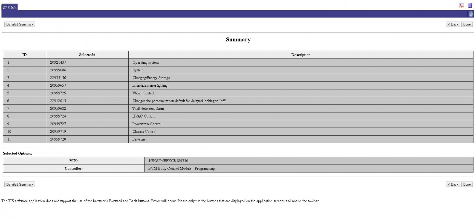

well **** apparently when I had the transmission worked on they wrote some files to the bcm which was programmed with a hypertech so it over-wrote "some" of the hypertech files so now I can't restore it to stock from the hypertech, so I wonder if I can just re-program the bcm with the tech2 ? @Rocket Man did the tech2 allow you just re-write the existing bcm?

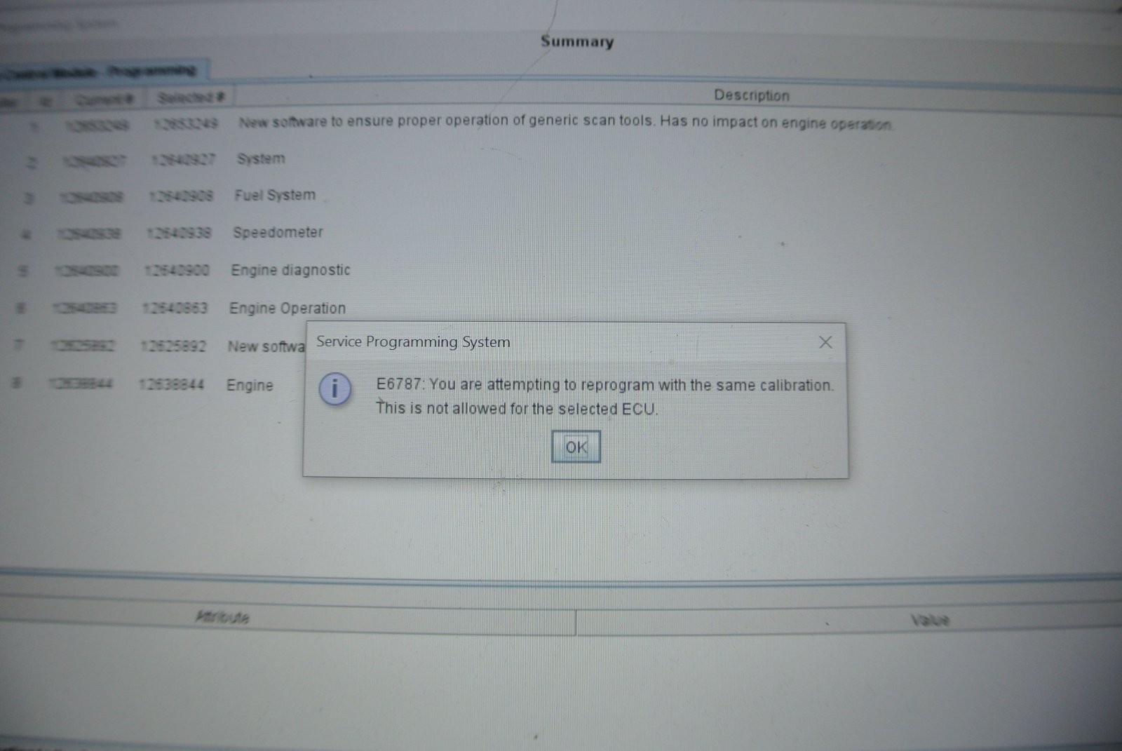

I didn’t try the existing, I bought a new bcm and flashed it to my VIN. (Which has now been overwritten by a bcm tune from BT Dieselworks.) IIRC it won’t write over the same file so when it checks the software version it won’t program if you’re trying to flash with the same version. A new BCM isn’t that much though.
Curious about this, too. I know you can flash a new calibration to the BCM with the Tech 2, at least it has that option on my '04.

You said BCM before, I wasn’t aware you were talking about BB flashing the ECU or TCM. Yeah they can be flashed with an Autocal as long as they aren’t bricked. BB doesnt flash BCM’s. I used the Autocal to flash my BCM with BT Dieselworks custom tune for it and same thing- it doesn’t look for software versions unlike the Tech2, AFAIK. It can get confusing to me. Now I was just wondering- I’m pretty sure I can’t use the Tech2 to flash my BCM back to stock since it has a custom tune on it. Not that I would want to anyway.
From all I've heard this is correct. Pretty sure we can't use a programmed BCM from another truck to reprogram to ours; the remans come with the VIN cleared, I think, ready to be flashed.
