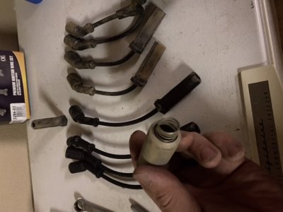

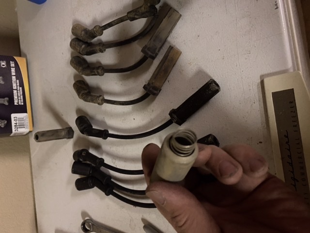

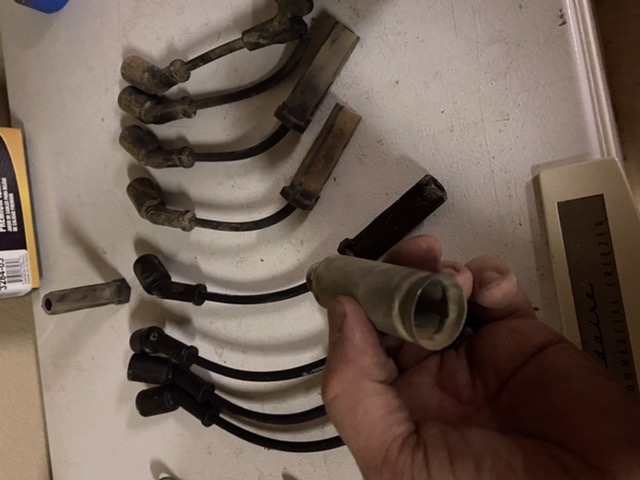

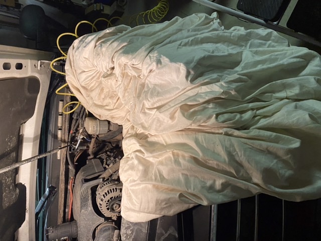

Shit man last time I did mine at least half of the wires broke off like that inside of the heat shield sleeve things. Do you have those? I don't see them in the pics. I used dielectric grease on the new wires hoping that would keep them from welding themselves to the fkn plugs again.:mad::mad:
I used special spark plug wire pliers and long reach pliers and they still fkn broke off. :mad::mad::( And what I mean is when they break off the boot comes off but the metal clip that snaps onto the ***** on the plug rips out of the wire and stays on the plug tip. :(
I don’t have a pair of the boot pliers. I know what they are, but don’t think I could get down in there with them anyway.

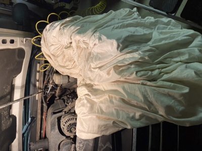

Yes, I had slipped them off as the wires came out.
B886D5A8-2813-4214-80C8-94EE6A85222D.jpeg A86C3667-683A-4530-A386-D360767D431D.jpeg

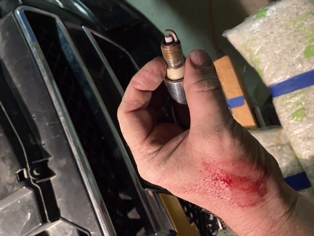

The easiest way for me to pull the ds #8 and #6 plugs and wires out--without breaking them--was to actually lay on top of the motor, my feet hanging over the grill--it put me at the perfect angle to take everything off without breaking anything.
That’s what this sheet is all about. Laying on top the Hoe.

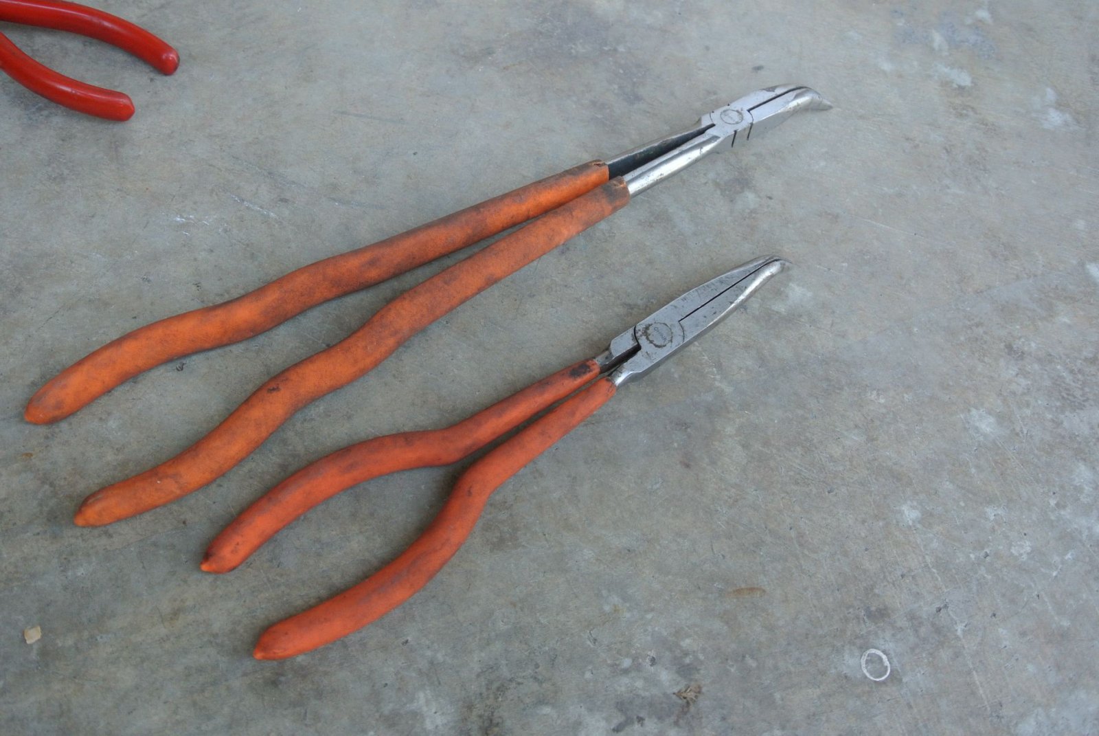

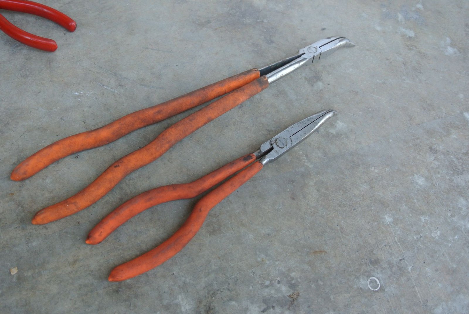

I found out years ago these long curved pliers come real handy for pulling plug wires and the metal shroud, harbor freight win
they have a pretty good grip, came in handy many many times, I think this set is about 20 years old
Those would be handy!
The ones I grew up with had nylon jaws. The idea being to not destroy the wire getting it off.
