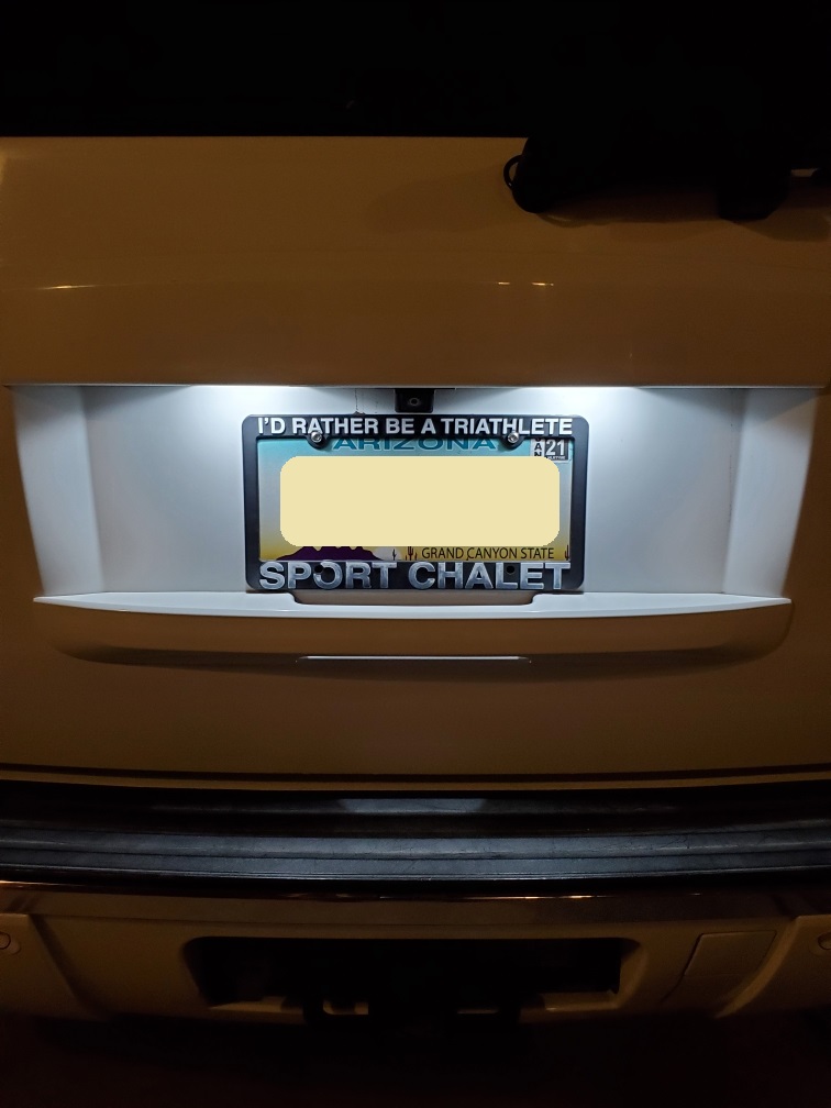

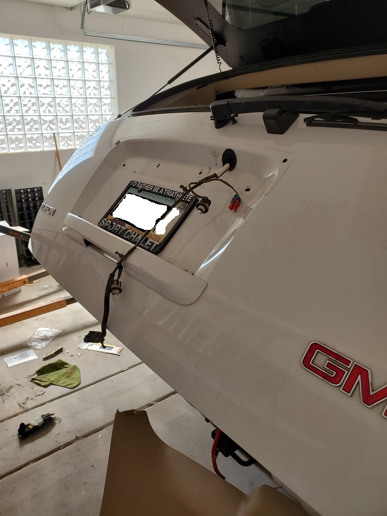

Did 2 things to the Yukon this week. First, I lost one of the lights over my license plate. Replacement bulb didn't help, so I pulled out the test light to confirm no power was going to the socket. Pulled the rear apart and found a pinched wire. I had to 'rebuild' the area where the bolts attach to that applique, but got it done. Second, replaced both the lift-gate struts, as one had gone bad and so the lift gate wouldn't open all the way. Would open 1/3 of the way, then close back down. 15 min, a gasket pick and a flat-head screwdriver and we're in business! :)
