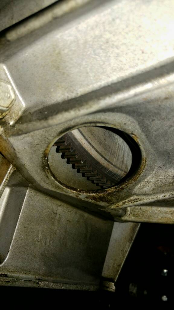

It's kinda difficult to see, but grab a bright flashlight and a small flathead screwdriver. Pry out the round hole plug (inspection cover) and shine the light up in there. Aim it between the flexplate and engine block. Look for oil trails coming from up near the crank.
Here's an interweb pic of the flexplate as seen through the hole with the cover removed:

Ahhhh yes I will do that. I completely forgot about that access port or whatever you call it. I'll get under there this weekend and see what's going on. It would be obvious if it were leaking from there.
