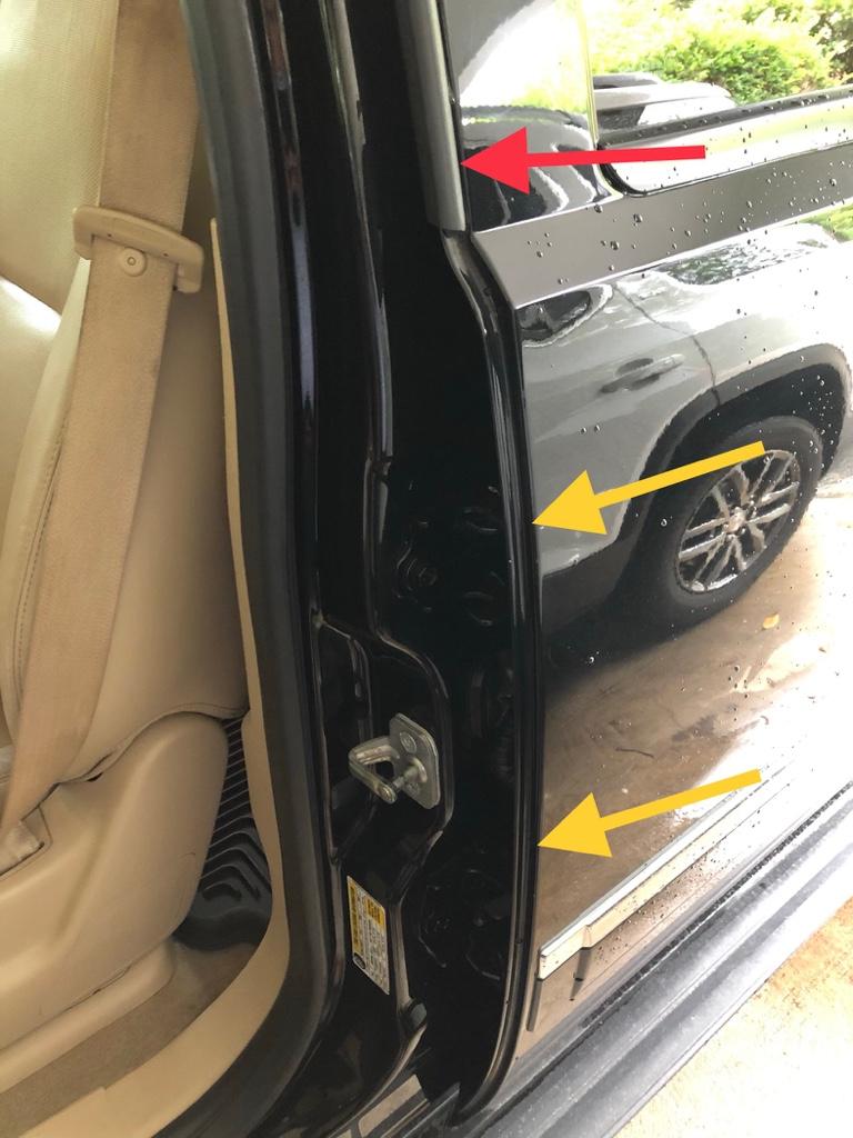

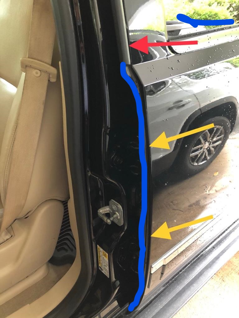

Thinking about the wind noise difference I’m noticing on my 2012 vs. that of the 2015.
The 2015-2020 Escalades have an additional seal that goes all the way down the front of the rear door edge which seals the door gap. It was a noticeable improvement when input it on my 2015 Yukon.
I haven’t seen it on the GMT900 Escalades I’ve looked at. Looking at my 2012 Suburban, it seems like the upper seal (red arrow) could be extended all the way down (yellow arrows) for the same effect.
The seal is just press fit on the seam. Anybody know where to get longer lengths?
Cmatt- I think your onto something here- I went out and looked at my 2012 Denali. The weatherstripping just stops and there is still that edge that you could put some weatherstripping on the lower half to reduce wind/road noise. The rear doors have full length weather stripping (double) for inner and outer.
I'm thinking they only did the top half because it is at ear level, so anything lower and the customer might be less prone to hearing road noise

What about this which would slide over the edge of the door continuing from the upper strip down?View attachment 253673
that same top piece fits on the bottom but they are $50 and about 6-8" short of covering the whole length, I just bought a $10 roll of some other stuff going to put it on the inner lip of the door to cover that area and see how it works

After looking again I don't know how much difference it would make because there is still a inner door seal, a outer one would be somewhat redundant
