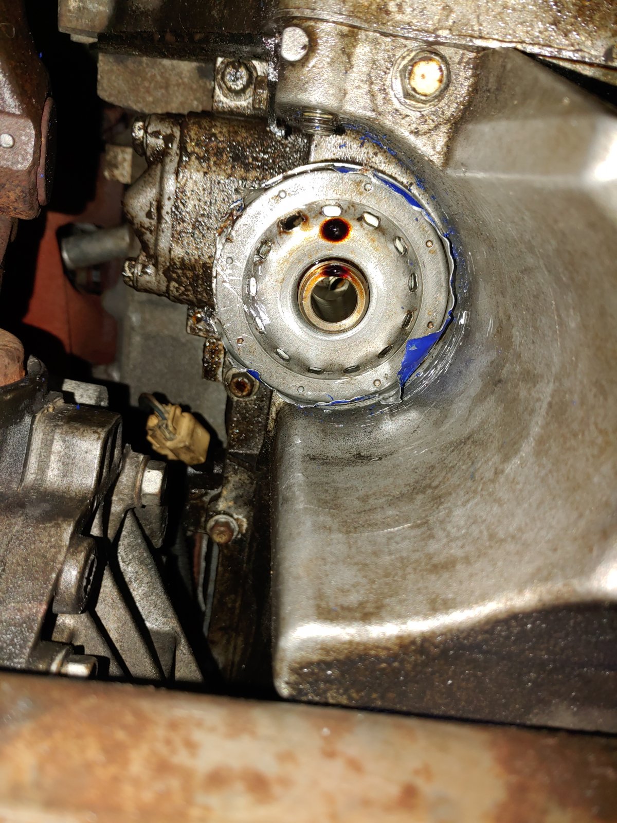

So I was changing the oil today and I guess last time I put my filter on too tight. I only use ACDelco PF48E but after this I might change to either k&n with the nut on the bottom or something else. Anyway my cap wrench removal tool wasn't working it was just slipping around the filter and my oil filter pliers wouldn't work, as you guys know there's really no room to get it around the filter. I don't have a strap wrench either. So I went with the old punch a hole into the side of the filter and that didn't work, although I have had luck in the past on other vehicles doing that. I religiously change my oil every 5000 miles so that means I've done it about 35 times on this truck already without any issues.
Well one thing leads to another and eventually the whole can is ripped off and all that is left is what you see in the picture. It's the top 1/4" of the oil filter. The whole can peeled away and the insides fell out. Eventually I got it removed by grinding away and chiseling away at all the little holes around the center to make it a huge gap where I was able to get a pair of vice grips around and unscrew. I was wondering if anyone knows if you could replace just the threaded piece that the filter screws onto or do I need to potentially replace the whole pan? There is a nut towards the top of the nipple once the filter is removed.
The new filter went on fine and there are no leaks but the bottom two threads were a little mangled, nothing too crazy but enough to make me look into replacing next time I do the oil. I didn't want to try messing around with the nut to see if I can remove it because it's more important that I have another 5,000 miles to consider either replacing the whole pan or get the right part if that piece can be removed and replaced only. I looked on RockAuto and didn't see anything except new pans that have the threaded nipple on it already.

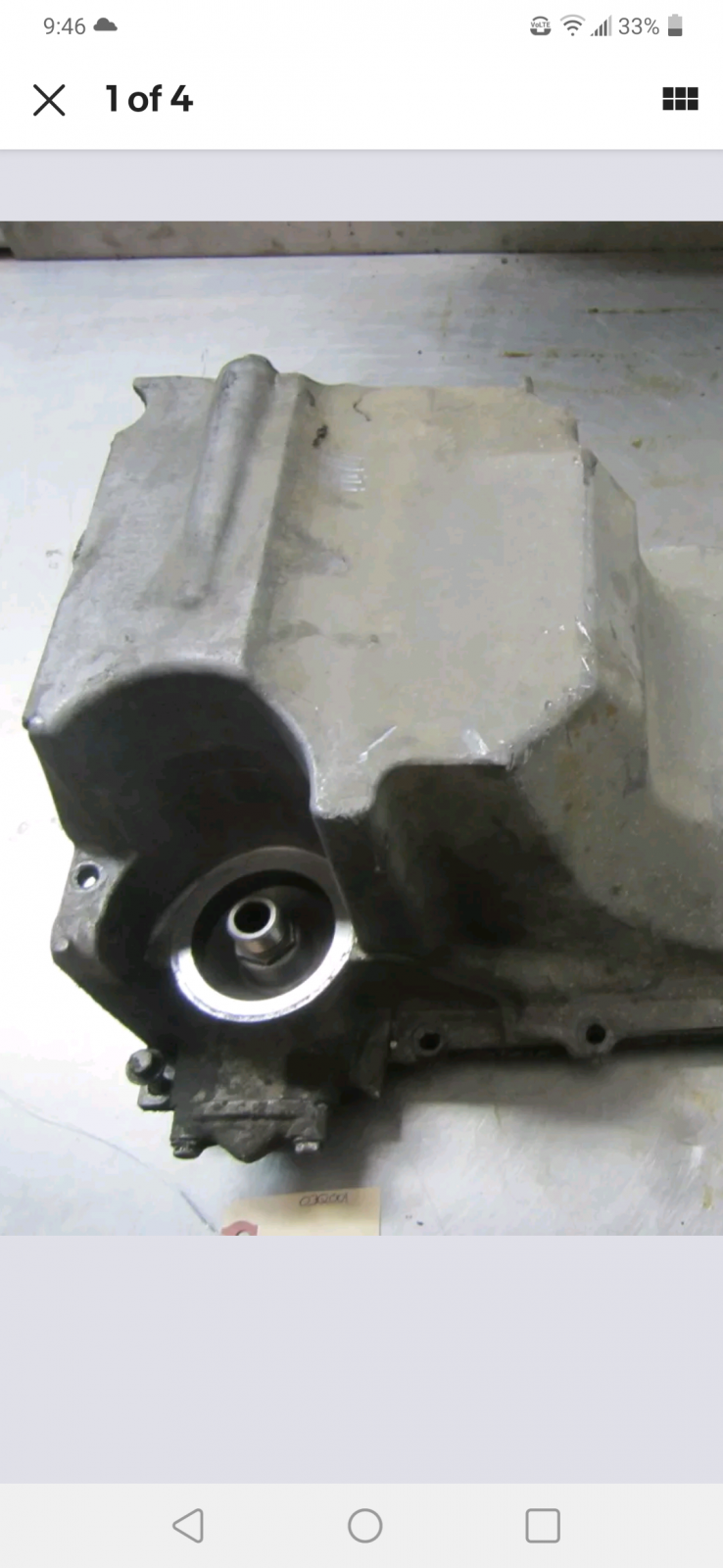

This picture of a new pan shows what I'm referring to, anyone know if it's possible to just buy the small nipple/nut that screws into the pan and replace that only?
45,012
Yes, that part can be replaced. It's obviously a separate part that is screwed into the pan since it's steel and the pan is aluminum. I've always known them as an "oil filter adapter" since it's what is used when you're adapting a filter to a filter boss, such as on an aftermarket remote filter kit, etc.
...After a little digging, it looks like it is part number 12552357 and the proper name for it is "fitting" or "connector". Do your research to confirm as there are different threads sizes between the years.
