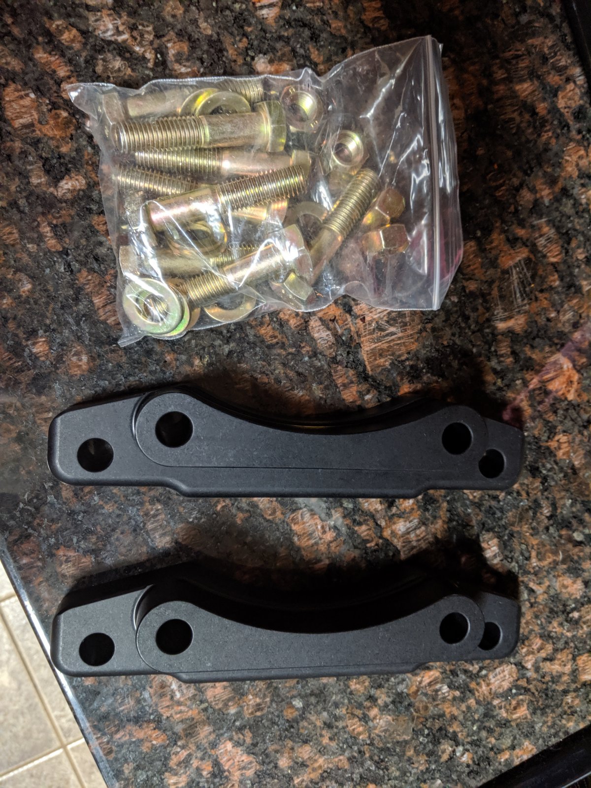

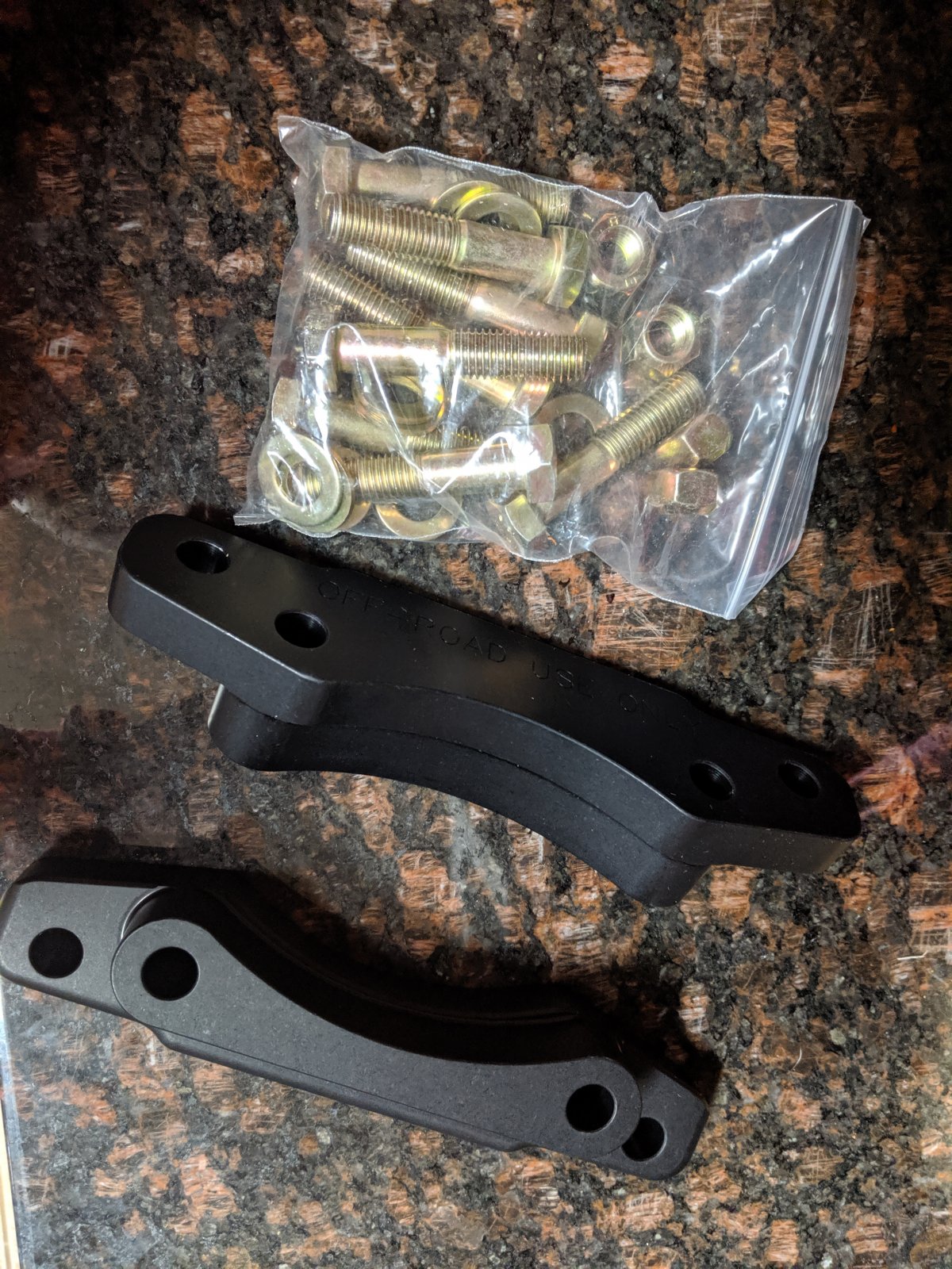

Where did you get the caliper brackets from?
Rudy over on one of the Silverado forums. I'll post his contact info up in another post.
But here is a picture of what I got from him.... quality parts
52,949
View attachment 242152 View attachment 242153
Silverado SS forum? I have considered this for my Silvy but don’t those calipers have Corvette on them? That was one of my issues plus the fact that by the time you factor in the brackets and pads you have $1500-1600 into these and you can get the Wilwood kit which has way bigger 6- piston calipers for about $1800-2000.

It's all up to the member. But yes, the calipers would have Corvette on them
I get parts at cost, so I'll be under that $1000 number.
