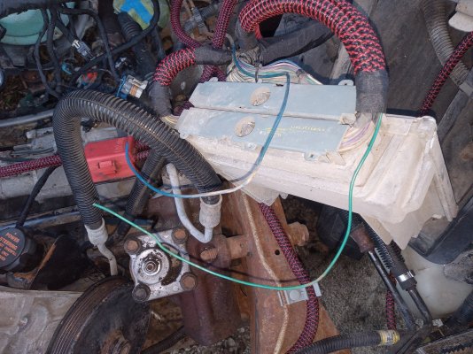

Love the look.
But, it would probably be extremely painful the first time you have to start cutting into all that hard work to trace down a circuit issue...
Split loom for me.
If I have to peel off any of this split loom I'm gonna cry too though! Lol

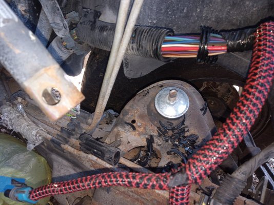

I wrapped the wire in tesa tape before putting the loom on, hopefully it protects it.
This is the piece of loom that inspired this job, if I would have known that it and a couple others were the only crunchy ones I might have just done those couple pieces. Too late now...
