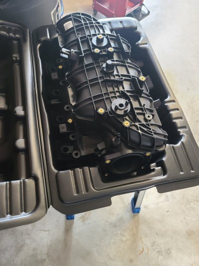

Picked up a free intake from a buddy of mine. He got it from someone else and had no need for it. Looks to be an oem TBSS. After some research, looks like the swap is not direct swap and will require several things. All he gave me was the bare intake.

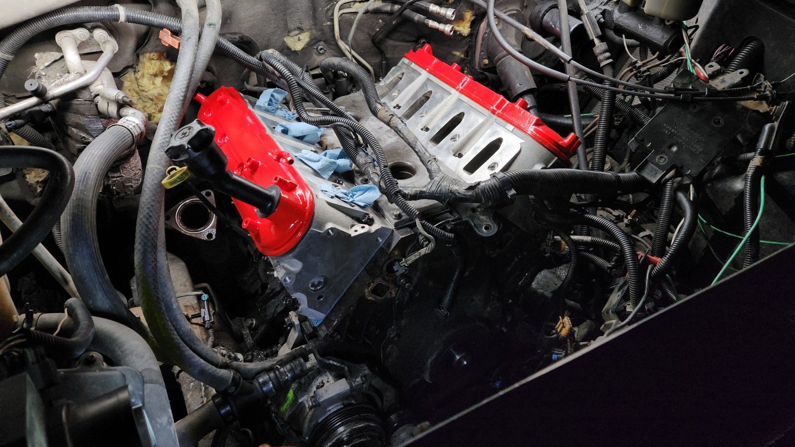

Buttoning up my '02 Silverado 2500. 6.0 just went down for major overhaul/maintenance. New motor mounts, cam, lifters, hardened pushrods, head studs, refreshed 862 heads, rockers with improved trunion, stainless shorty headers, upgraded trans cooler, tranny fluid change, replaced tranny cooler lines, etc.
Went with a Summit SUM-8719R1, for those curious. .550"/.550" 209/[email protected] 112±1LSA
I expect it'll be pretty happy in the 6.0, particularly with the increase in compression with the 862 heads. Excited to have it all buttoned back up and get it tuned/back on the road.

Easy install and I already had a set. I still have the factory exhaust anyway and it's in great shape. While I would've loved the bump in low end from the long tubes, just wasn't necessary right now to spend the money and go through the effort, especially when I didn't have a better muffler to support the increased flow.
