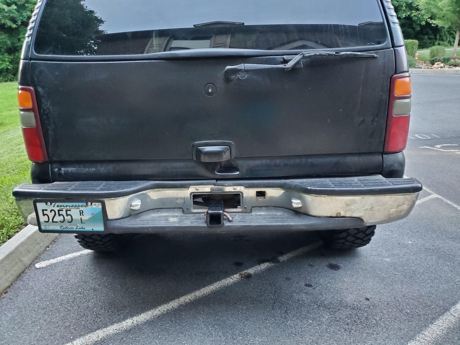

Finally replaced the few crumbles of rust I had hanging off the back with a fresh bumper. Didn't realize the Tahoe and Silverado bumpers were different until i'd swapped the mounts over and slid it into the frame! No matter, actually improved departure angle a little.
Also tossed the factory hitch receiver and welded a receiver tube right onto the bumper. This will get reinforced quite a bit more with kickers running back to the frame rails on both sides, and safety chain points of course. Again, this is for improvement in departure angle.

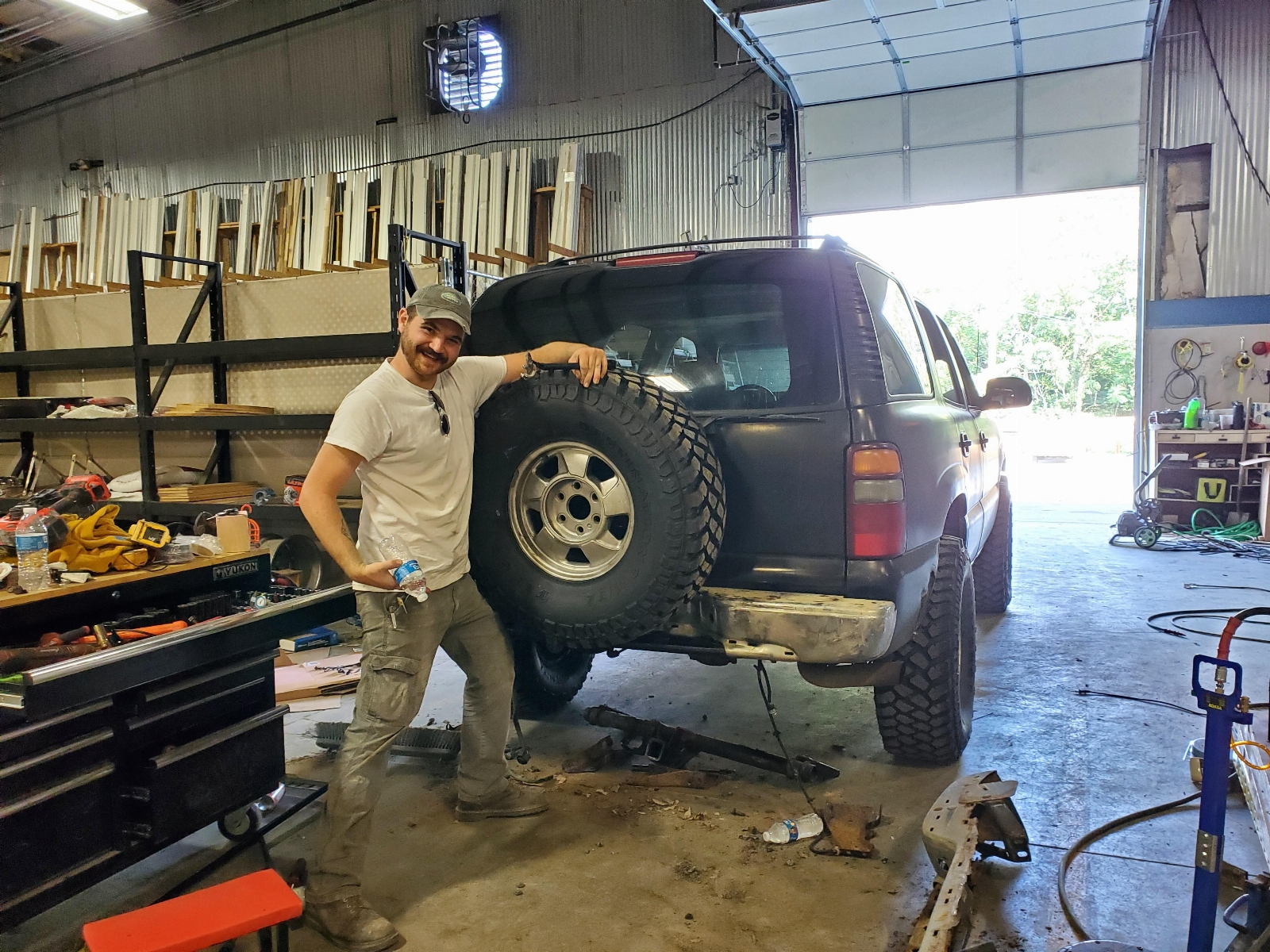

This was all in preparation for the swing out spare tire carrier I'm building. I've got everything for that except some 1/4" steel plate that will sandwich above and below the bumper to mount the spindle. I'll also bend a piece of tube that will weld to the bottom piece and then kick back to the frame for further reinforcement.
I am debating back and forth between a passengers side mounted spare, or a center mounted spare. I had pretty well settled on side mounted until I saw it center mounted. I'm starting to think that may be better. I believe I could still mount a Jerry can on the hinge side (maybe two), and then also have space to build a small box to keep some recovery gear in. It would also have the benefit of lowering the spare to retain some more visibility out the back window, and potentially lower the center of gravity just a little bit. I had my buddy hold it in both positions, so give some input. In the center position it will still mount about 3" higher than shown in the picture. The side position will mount about 1" higher.
