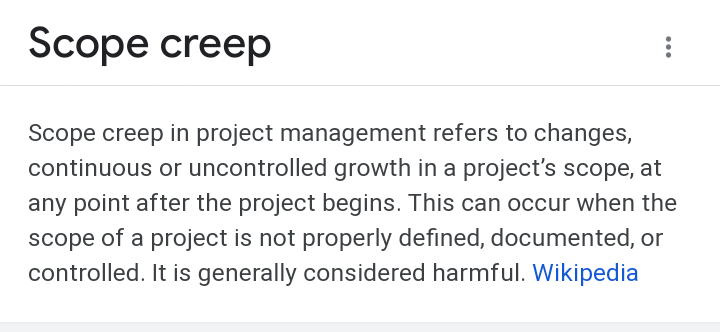

Ps. I'm gonna have to Google scope creep

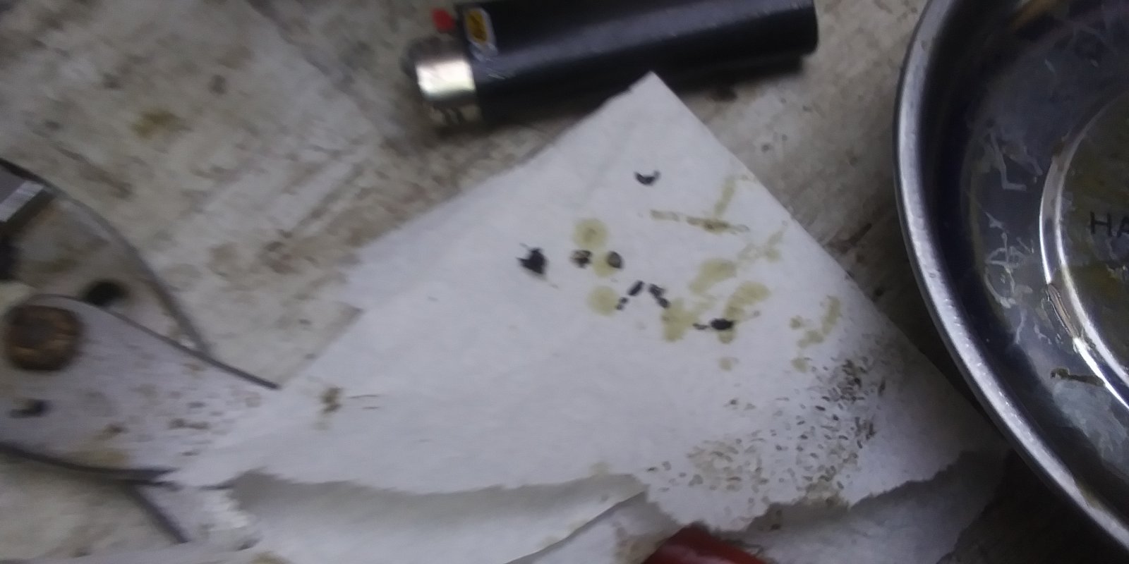

This is what's happening, I I hope it's not harmful, lol
33,210
51,476

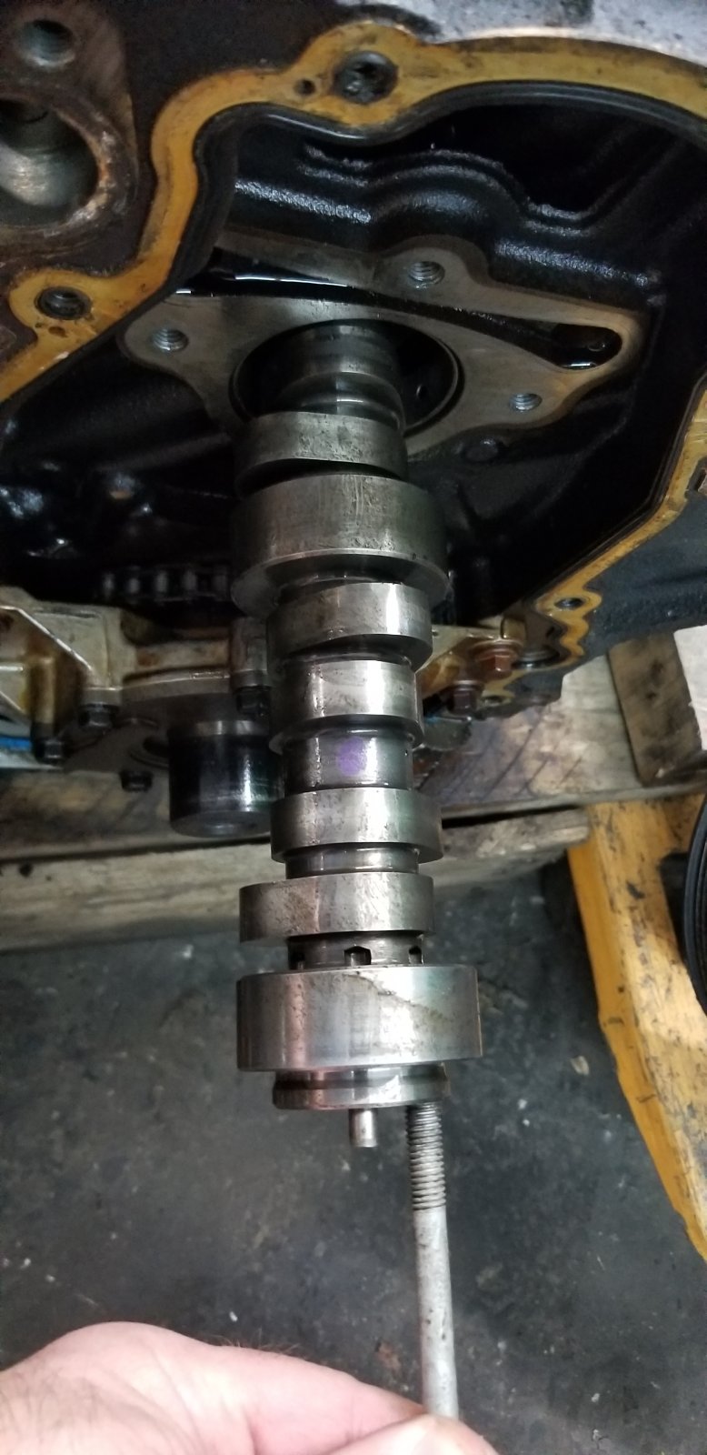

I tried to pull the cam out while the lifters we're still in there, with the engine upside down, and it was binding up. After I puller the lifters out with pliers and probably destroyed a few, the cam was still not wanting to come out. Found the problem afterwards.
Extra wide cam bearing... Lol
I bet that motor had a tick. That's what happened to my 1st motor too.
33,210
51,476
It had 3 broken exhaust bolts so maybe they couldn't hear it over that, lol.

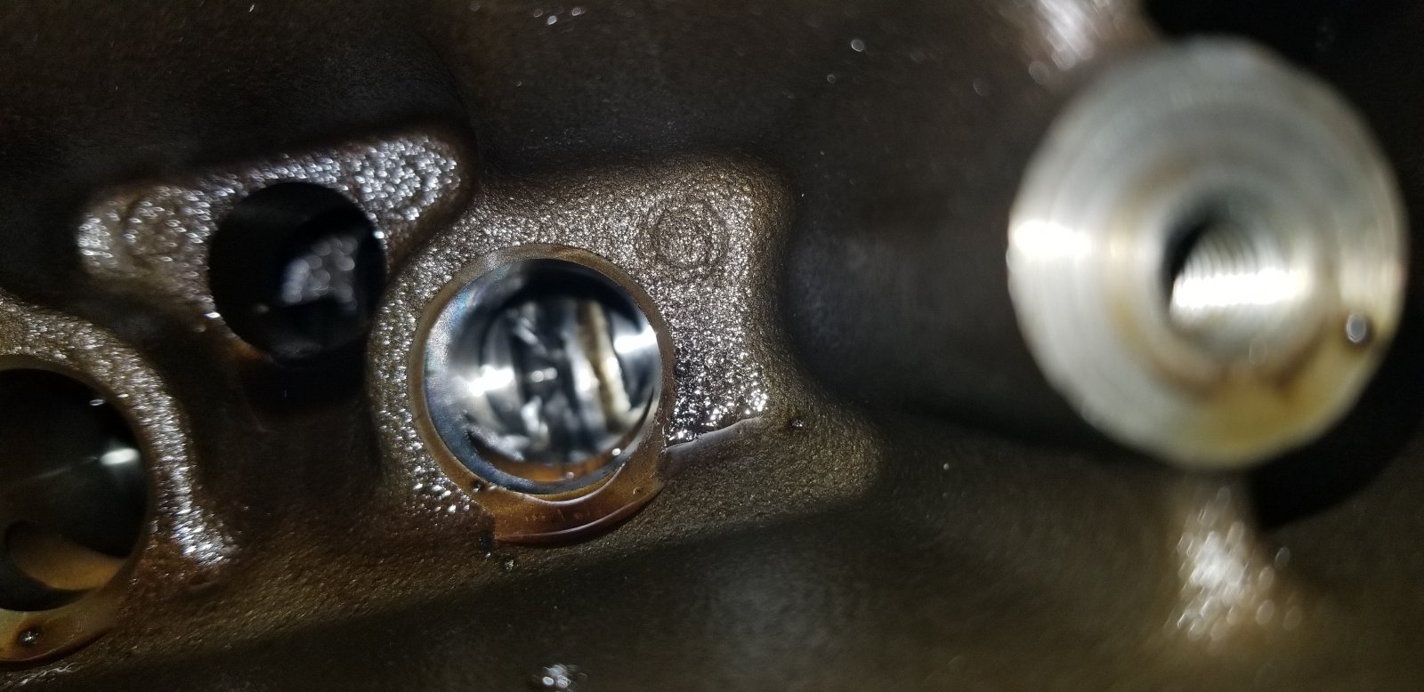

I just found some slag under the thrust bearing too.

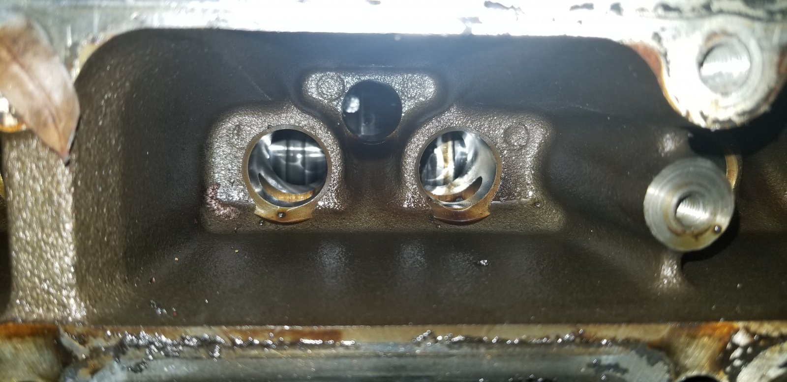

Gonna take the block to the machine shop? At least for a hone and clean up?20200702_100248.jpg20200702_100240.jpg20200702_124329.jpg
My motor with the spun cam bearing. There wasn't a lot of mileage on this cam, less then 20k. It was a BTR stage 3 truck cam.

Gonna take the block to the machine shop? At least for a hone and clean up?View attachment 365248View attachment 365249View attachment 365250
I thought about making my own hot tank, I might call a machine shop,but the only ones I know of are kinda shady so I need to do some research.
