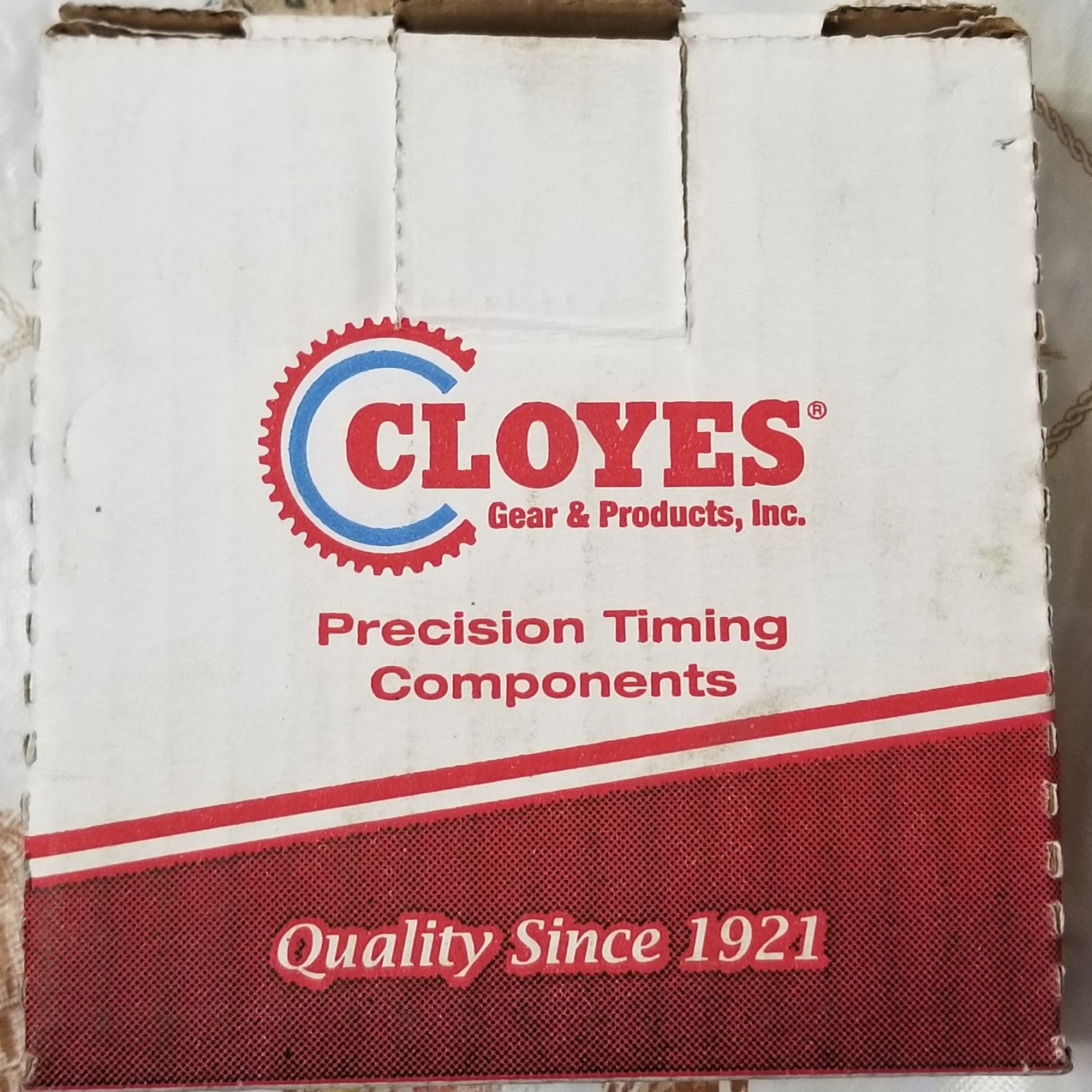

And I got the little valve seals and new lifter trays. Head gaskets, valley cover gaskets, new head bolts cause the guy at btr said he wouldn't re-use them. I
Am debating a timing chain now too lol
