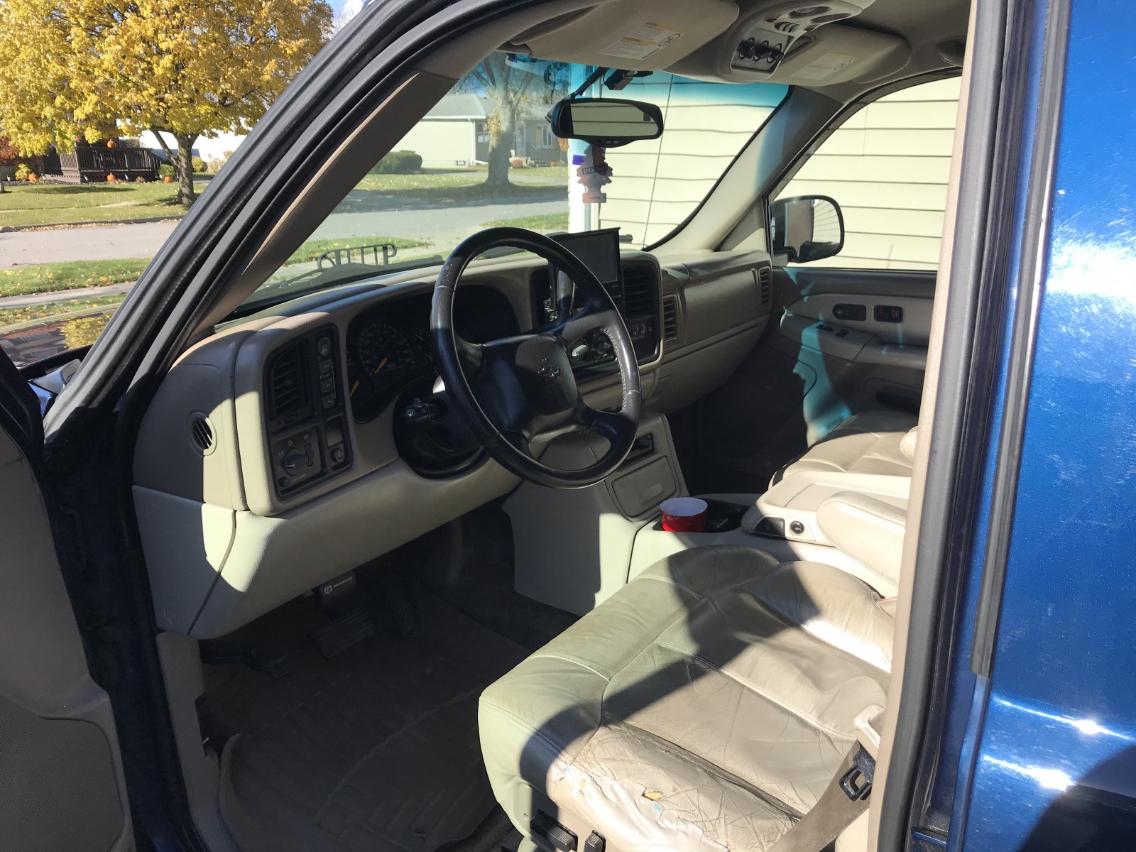

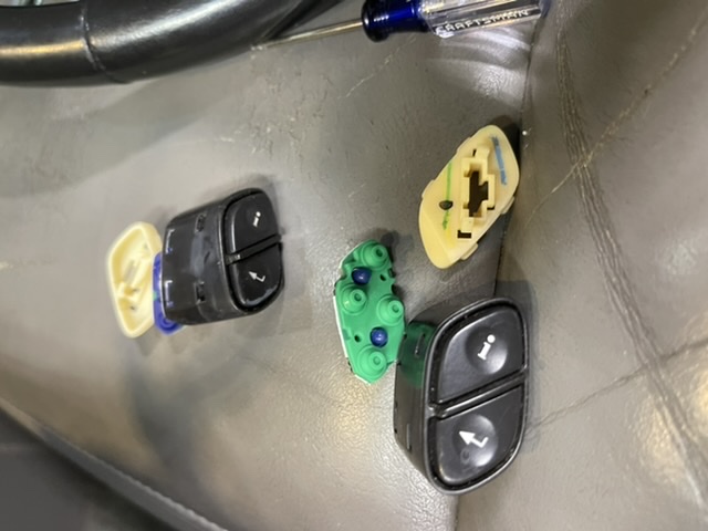

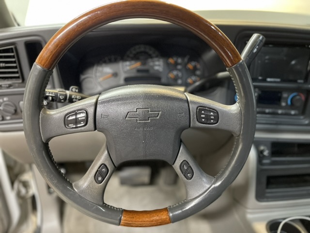

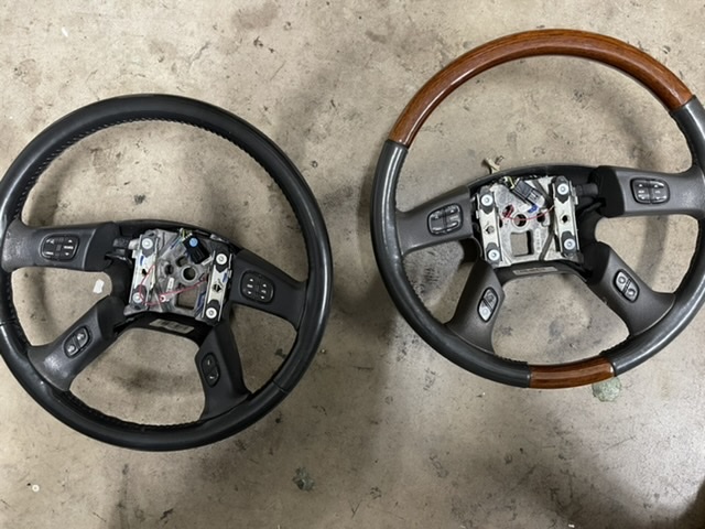

Finished up the steering wheel swap. Took longer than expected since I had to swap the buttons from the old steering wheel. Weird thing is none of the controls work. They didn’t work before either.

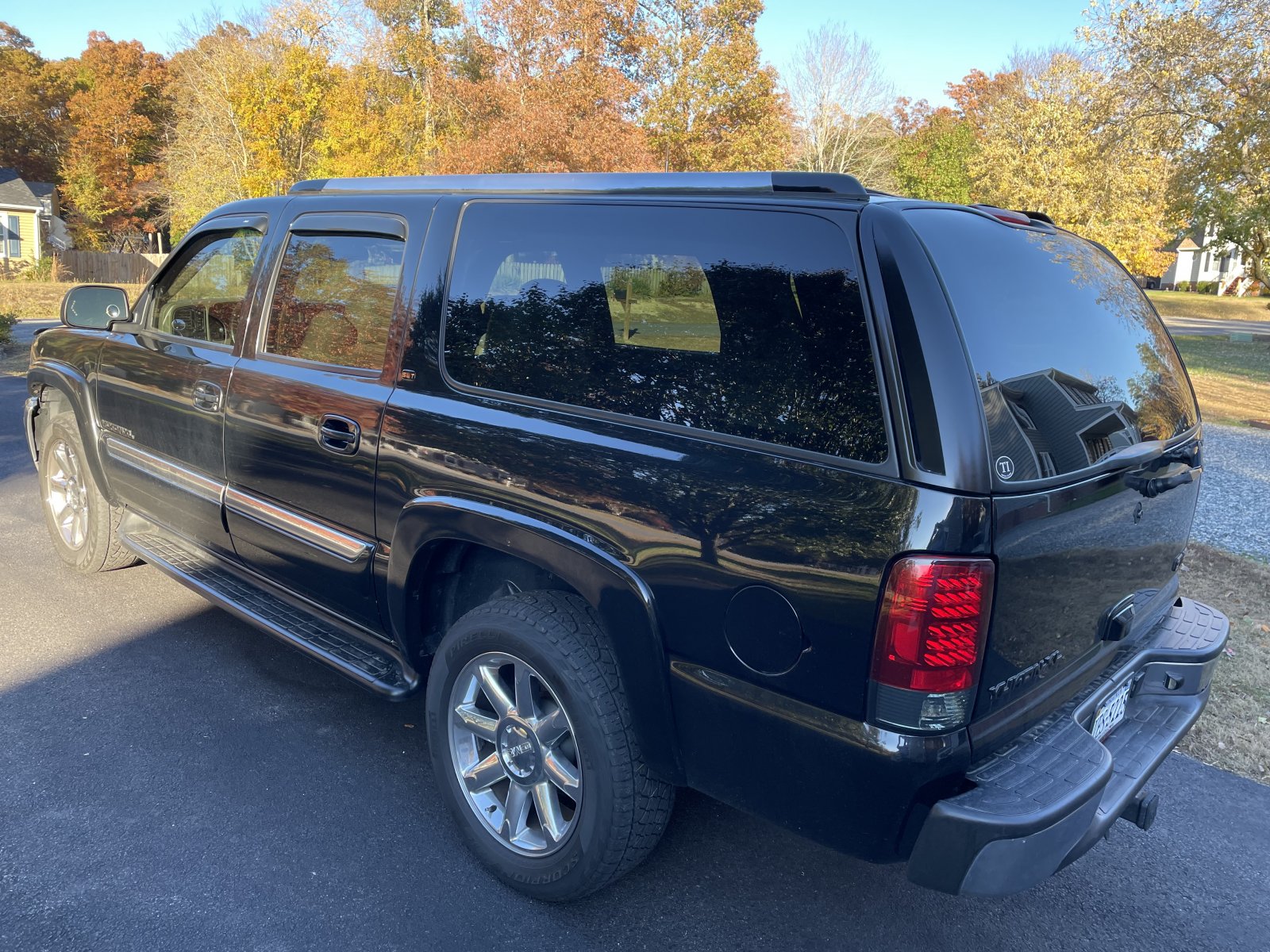

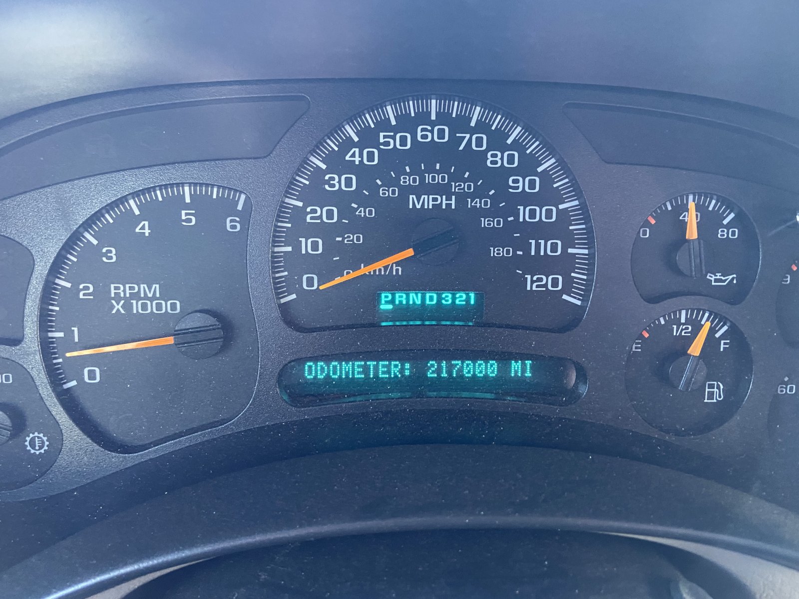

Picked up a Suburban. Ended doing the rear brakes and valve cover gaskets. Installing a Esky steering wheel later this afternoon. Needs a good interior/exterior cleaning.
Mileage? If that's all original in there, it was treated to good oil and timely changes.
*EDIT* Never mind. I replied before seeing the rest of your posts. They took care of it. Good find!
Thats likely because of the radio. Might not have the RSWC interface, or have been wired for it.

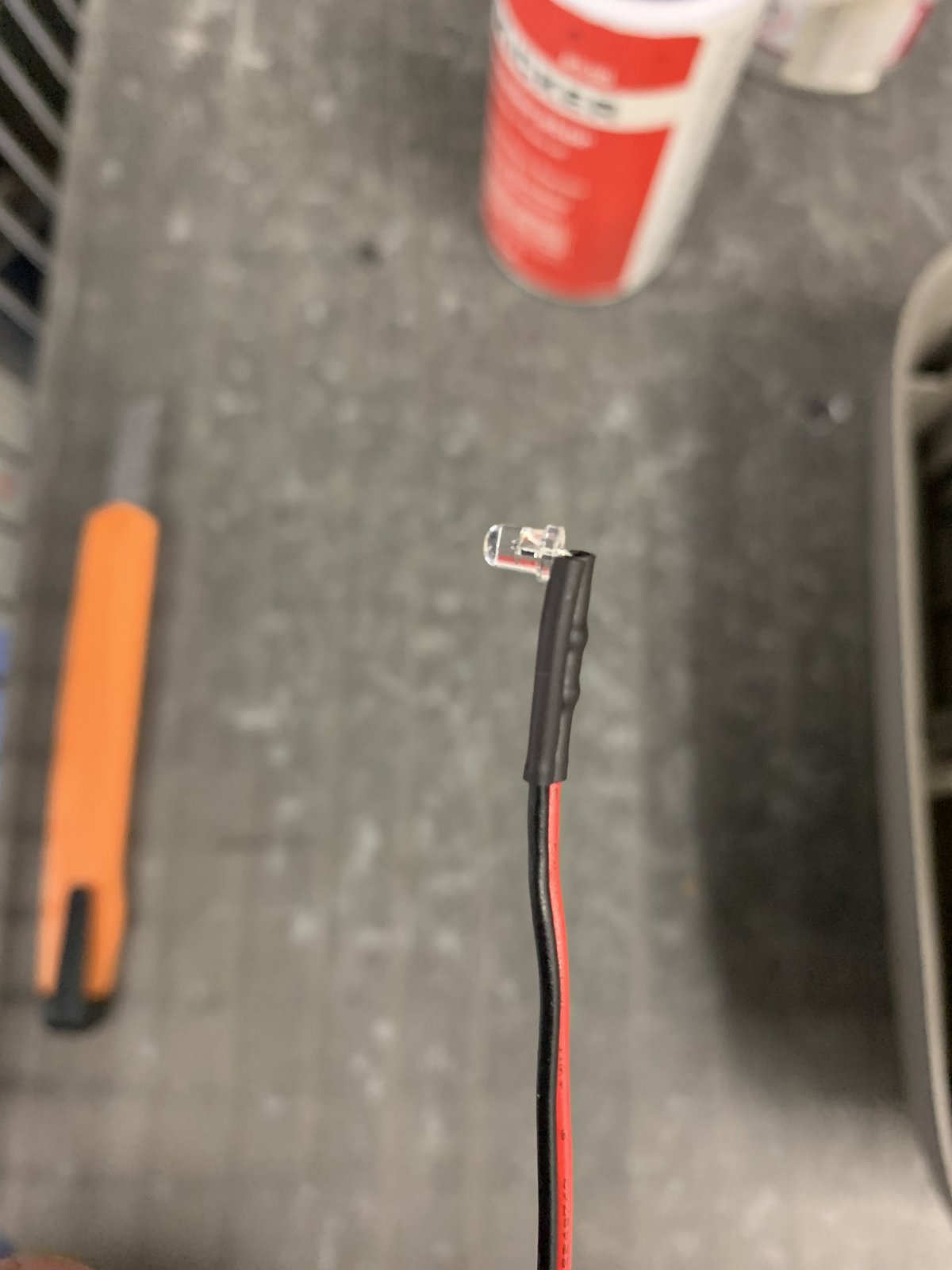

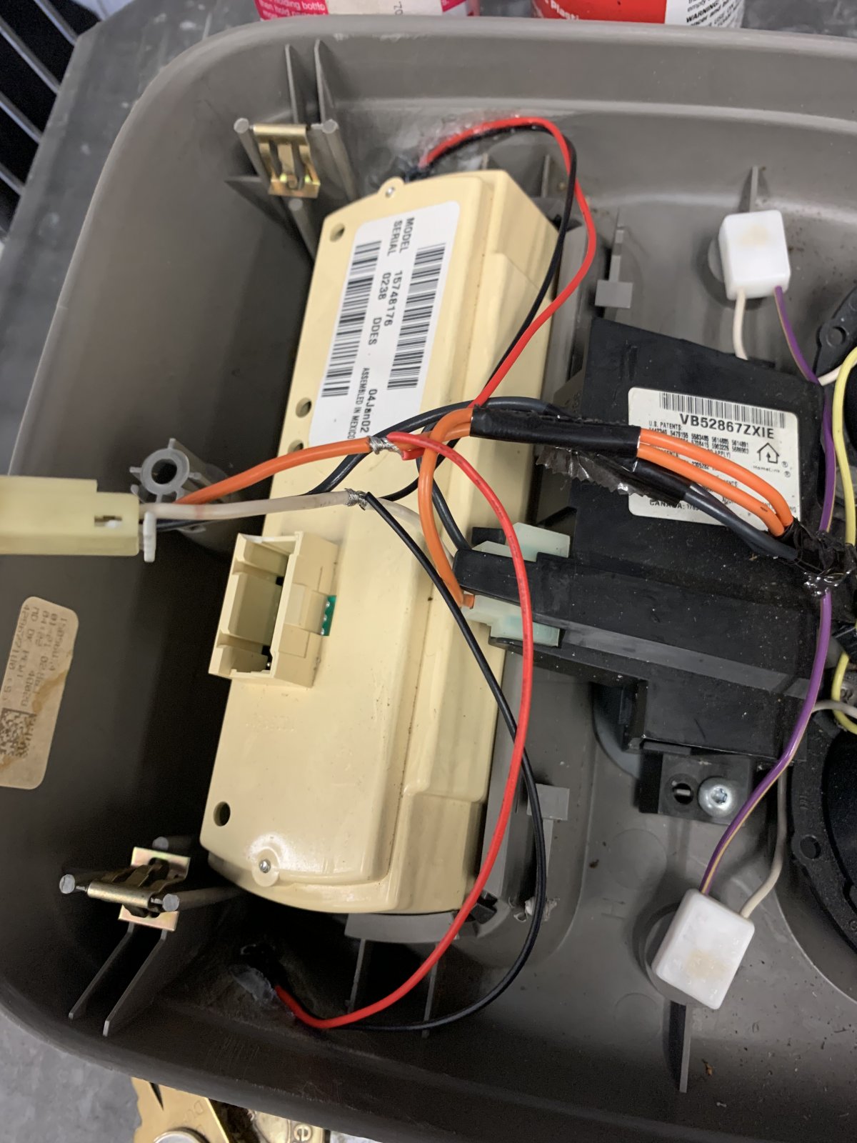

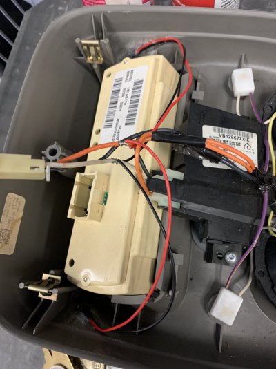

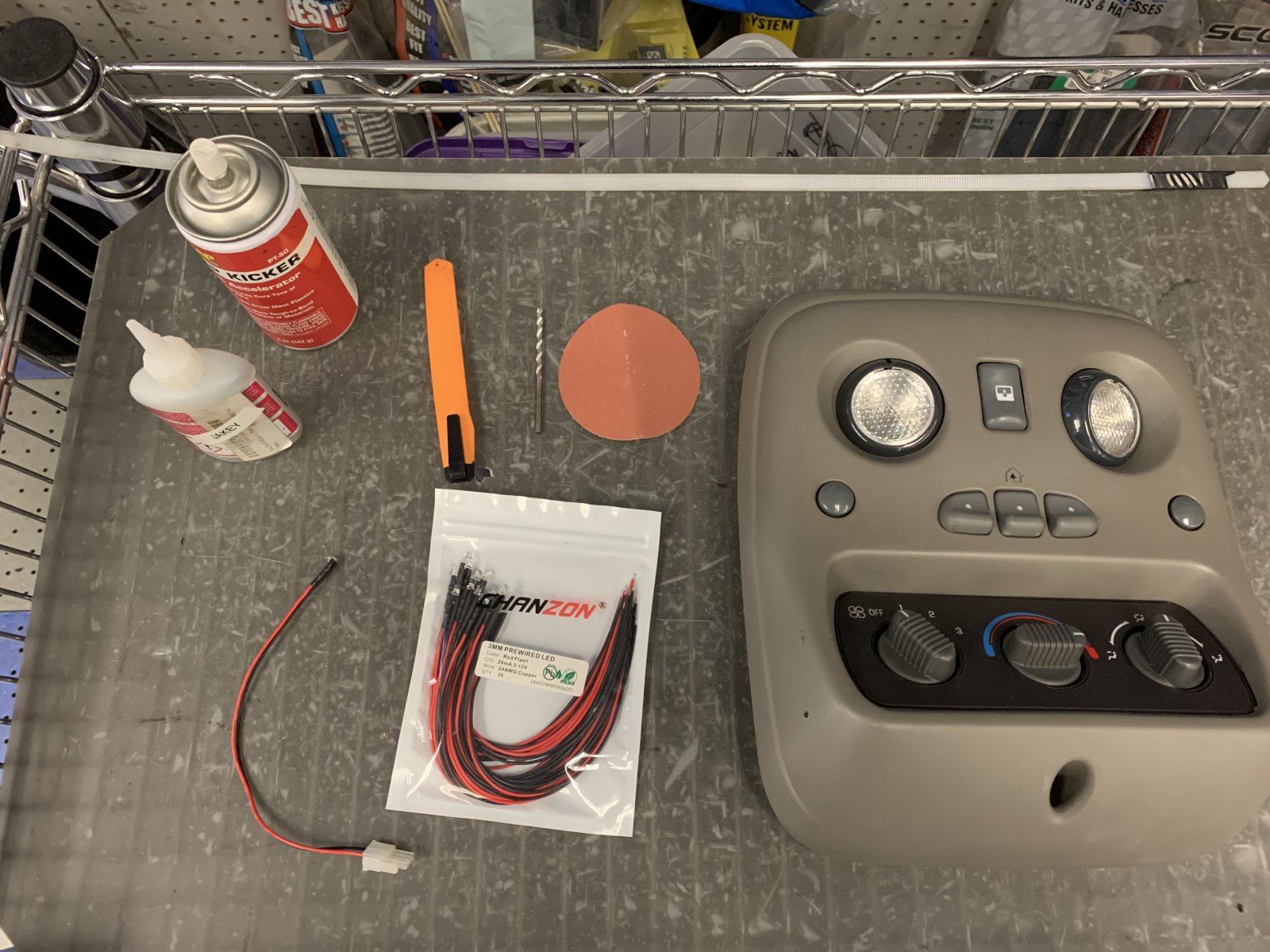

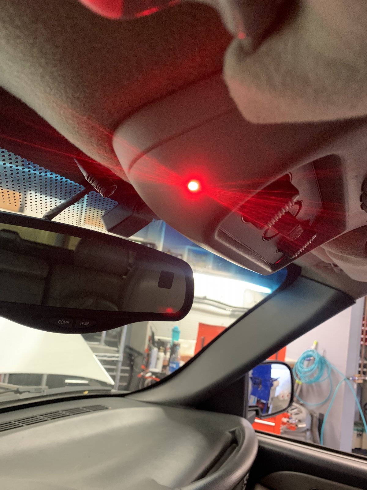

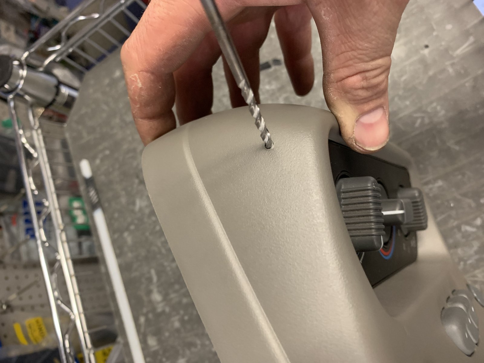

15 minute $12 fake security hack: installed two blinking Led’s into overhead console, that only blink when the car ignition is off:
C82E714B-6E16-44A1-B8C8-2036DAB689CA.jpeg4BB64F44-1180-42EA-8591-35542946F24E.jpeg9EA4E24B-85F6-4F88-B4C3-F08334788E44.jpeg
Wired to dome light circuit for constant 12volt power (red led wire)
and ground to white wire which is 12 ign, but goes to ground when key is off.

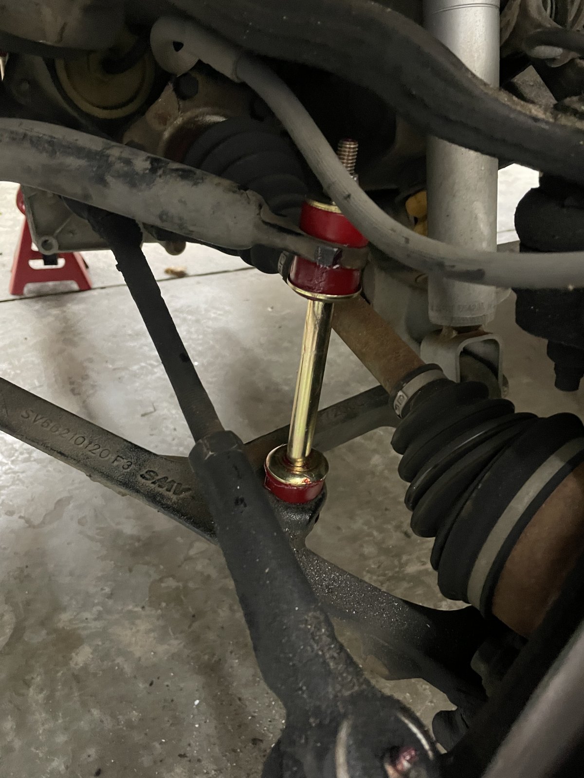

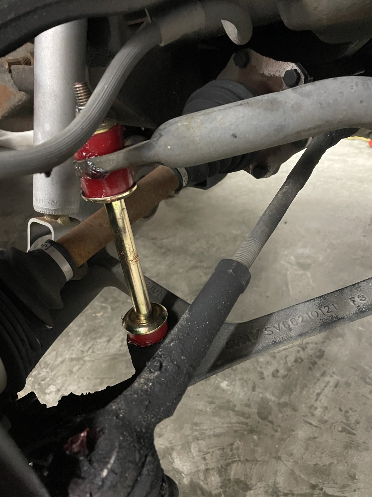

Did u also do the sway bar bushings? I did front and rear and man what a huge difference!!! She feels safer and tighter at 70+ mph than before.
I did the sway bar bushings about a month ago, but ran out of time that day to do both. Curious to see now that both are new and Energy Suspension if I will feel an improvement.
