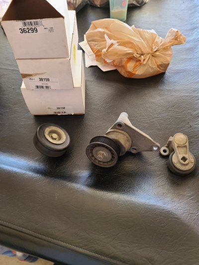

Got both belts and all those swapped just now. Just cause. Not sure how old they were but the ac belt looked bad.
