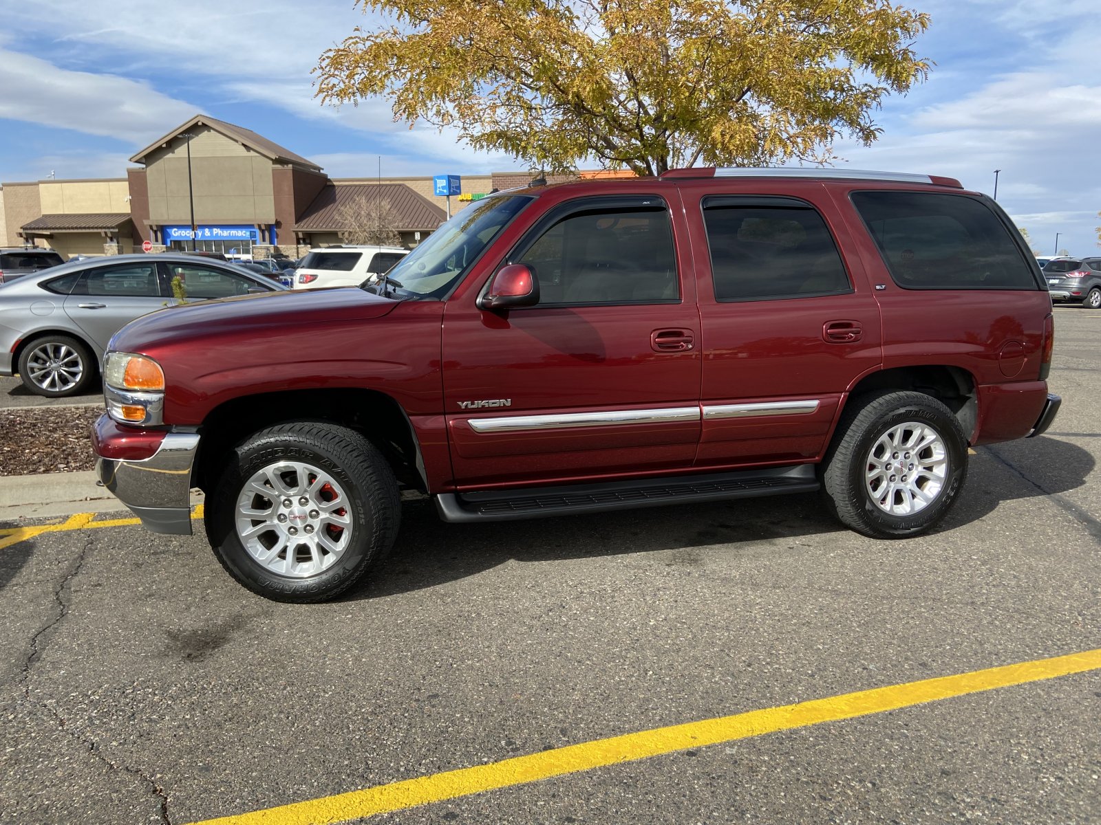

After efan upgrade report:
Now that I’ve driven her more, I can definitely feel a throttle response improvement.! I think it’s more so at the higher RPM range, which is sort of the opposite of what I expected. And I cannot believe how quiet she is now…! Boy that clutch fan is louder than you think… pic after pumpkin patch, and quickie wash / half a detail, cuz it’s mandatory to post pics..! :cool:
Teamiez
Oct 10, 2016
306
392
Now that I’ve driven her more, I can definitely feel a throttle response improvement.! I think it’s more so at the higher RPM range, which is sort of the opposite of what I expected. And I cannot believe how quiet she is now…! Boy that clutch fan is louder than you think… pic after pumpkin patch, and quickie wash / half a detail, cuz it’s mandatory to post pics..! :cool:View attachment 353510
I would have expected a little more push off the line as well, wish I had more things a damn slug!
Yours looks pretty level, did you just raise the torsion bars?
That Color has always been a favorite of mine. Damn good looking ride man. Whats the specs on the tire size???

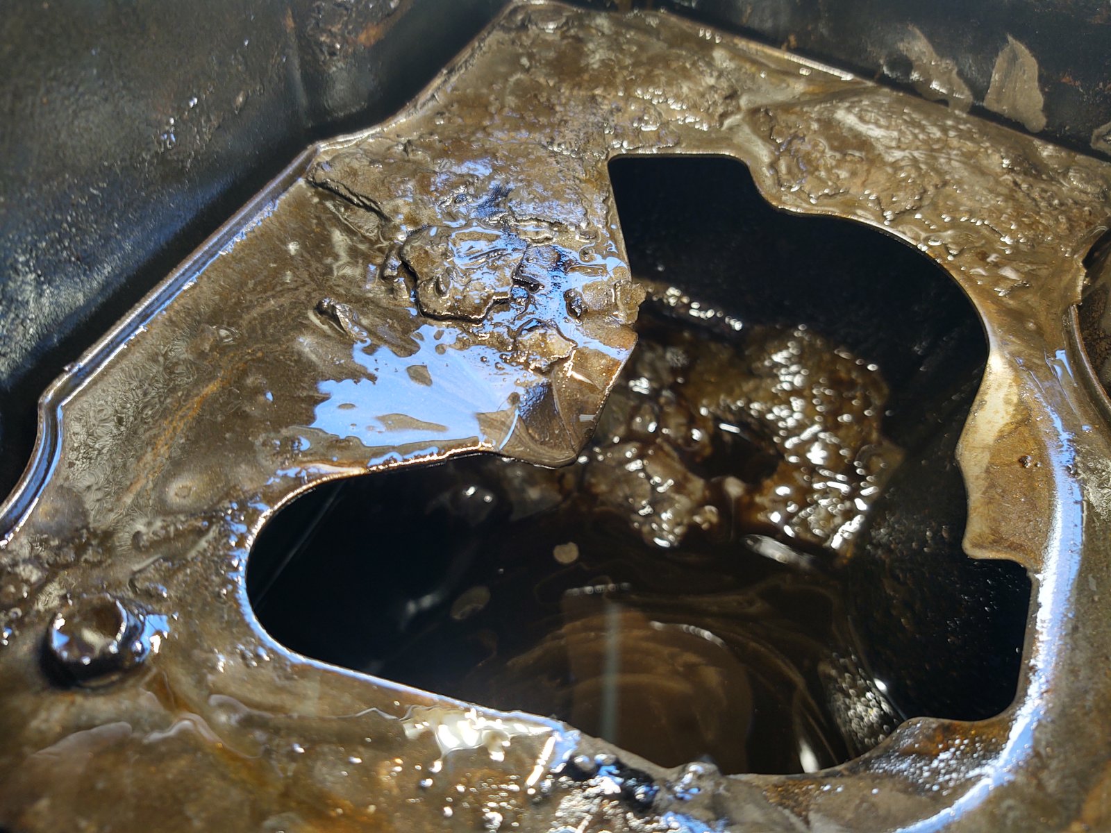

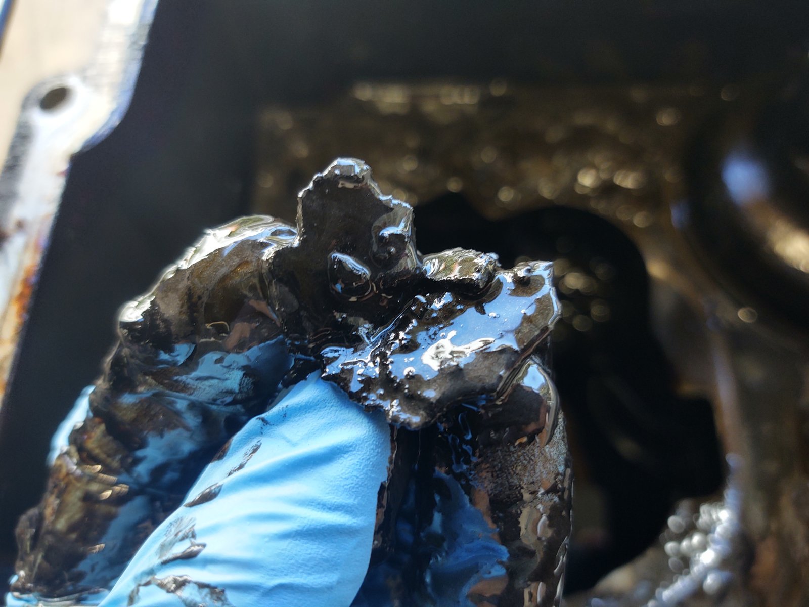

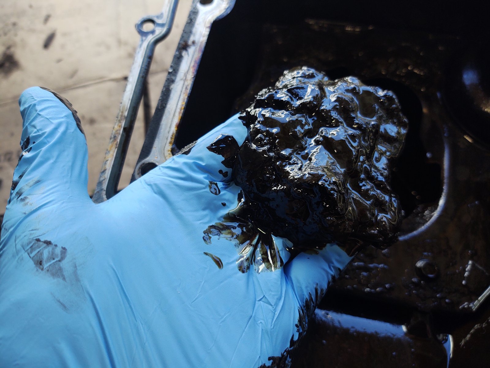

Got my oil pan dropped today and that sumbitch is FULL of sludge! Boy am I pissed. I COMPLETELY cleaned this pan out when I replaced the gasket and pickup tube in 2017. Since then I have changed the oil every 5,000 miles with Amsoil XL series oil and either a Mobil1 filter or a Wix XP filter. I'll admit though, the last 2 oil changes I used Mobil1 oil and then Walmart Supertech Full Synthetic for the last oil change. (about 3 months ago). In the bottom of the pan there is a THICK mud like sludge, and on the baffle, there is some hard caked up sludge that is flaking off in chunks kind of like rust. It also has a slight metallic color to it. Can anyone with more insight than me explain WTF is going on here? :confused:
It's possible that all that sludge was already there in 2017, and it finally broke loose and fell into the oil pan with new oil and consistent oil change intervals.
Are you using high mileage oil? My understanding is the HM oil will contain detergents that will break up sludge and cause it to fall into the oil pan. If the PO only ever used conventional oil, and had extended oil change intervals, it could have caused the buildup you're seeing.
When did you purchase the truck, and how many miles have you put on it since you bought it? How many miles are on it now?
