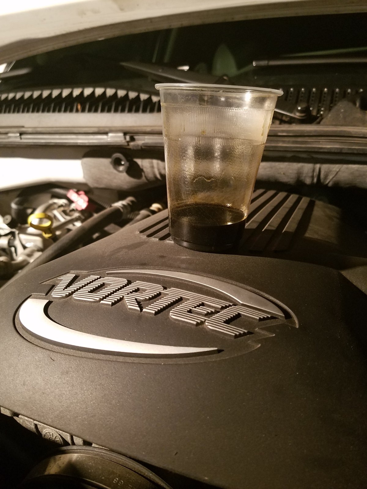

Changed the oil and emptied the catch can...
I think there's a little less than last time. I'll have to check. Need to rotate still, will get it in the next day or two.
