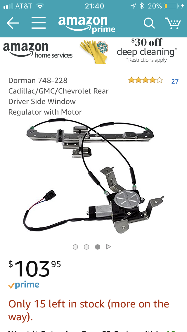

Sheesh AC Delco showing $105 for the regulator without the motor and Dorman $103 for the regulator and the motor on Amazon.

You think I need both the regulator and the motor or just the regulator because it is going up, just very slowly?

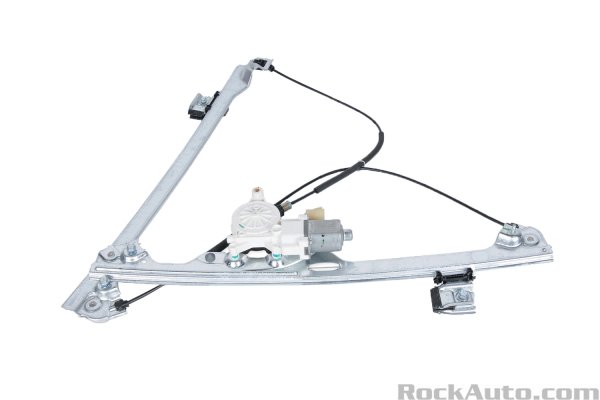

i show its $99 for the motor and regulator assembly (rockauto) AC Delco
Believe the regulator is the motor.
nope. regulator is actually the track/arms that do the scissor lift motion. i even have regulators on my '50

Here seems to be what we are looking at and there are prices and manufacturers/names all across the board so needs a bit of a search.
Beat me to it. Thx man. At least confirming my questions. Maybe worth just replacing both at the same time in one unit.
Oops I mean I thought it's all 1 piece. Can't buy regulator and motor seperately right?
