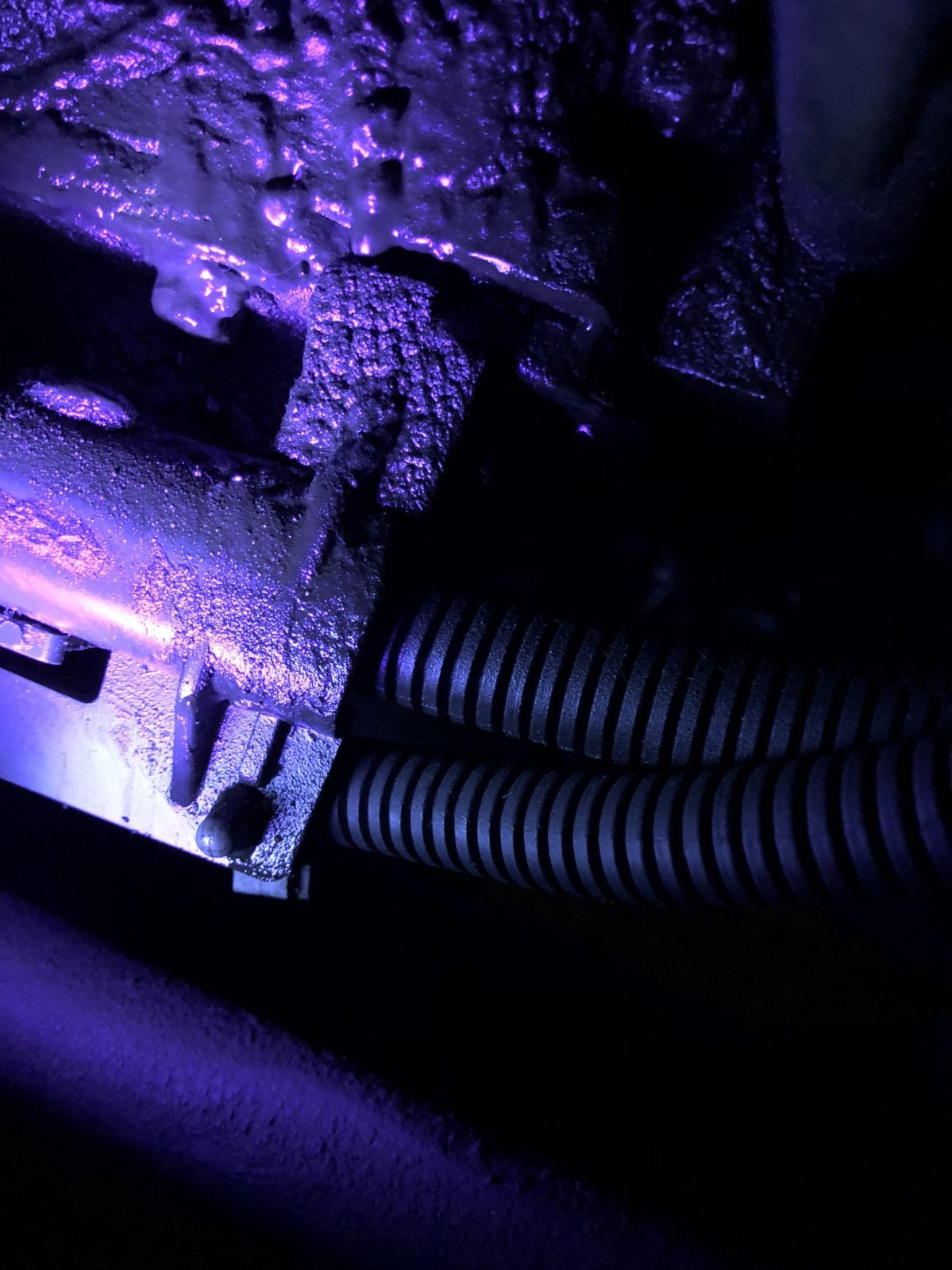

Added dye to the oil after getting tired of a two drop a day oil leak leaving a mess on my floor.
Best I can see is the leak is from the front of the pan due to build up and what looks like two small streams coming from it.
Here's the bad buildup. Cleaned it up and will wait to see if more dye comes through. Build up was so thick I couldn't even see the dye under it.
Tuned in to see what comes of this, mine leaks about the same amount and from the same spot
You need to clean everything up with a pressure washer and degreaser, then have another look. That's kind of hard to see where it's coming from.
edit: oops, guess I didn't read your thread very well lol.
That's what I do when I try to locate a leak. Brake cleaner helps tremendously for drying it up as well. I find that Purple Power, or LA Awesome both work far better than the aerosol engine degreasers that they sell at the auto parts stores.
