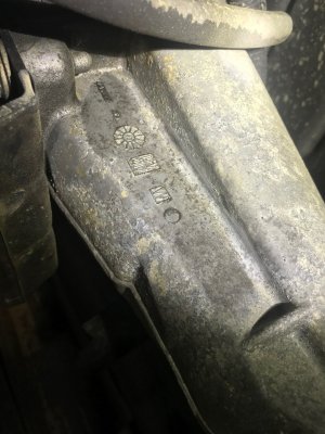

As a side note, I do remember having the drive side mount replaced a couple years ago. It was obvious when putting in gear with one foot on brake and the other giving it gas the drive side of motor would go up and down. Really don't think I ever had the passenger side replace.
So I assume it's possible the vibration may be due to a worn passenger side mount? Still need to figure out the leakage though.

Looks like it is a GM extension housing. Hopefully that partial number stamped on there isn't the actual part number as it looks like it ends in 3015.

Forgot to mention, I had the original driveshaft balanced early on while trying to diagnose the vibration. No change. Same vibration. Went so far to order a new driveshaft with yoke and u-joints all put together, which is what is on there now, and again no change. I am pretty sure it is not the driveshaft.
By the way, the small vibration that is there at times, I do not feel in the steering wheel at all. Driving down the road at the speed limit and the vibration comes and goes. It's not consistent. It's subtle, but there at times.

I remember all that stuff you went through a year or so ago. Whoever installed the seal might not have put it in right, with a block of wood instead of a seal driver.

btw im going with seal and driveshaft out of balance.... my 01 went through a few seals (output shaft seal on transfer case...pretty much same thing as end of the trans on a 2wd) until i had an aha moment as to why, yanked the shaft sent it out to be balanced and viola...

Maybe the leak and vibration are unrelated. I would see if a new seal fixes the leak and keep chasing the vibration separately. Maybe put the joint into the rear yolk 180 from where it is now. Could it be the rear brakes making the vibration? Try swapping the rear rotors from side to side?

Late jumping onto this thread. This is a great forum. Lots of very intelligent, thoughtful, helpful individuals trying to diagnose and fix a problem based on sometimes limited information. Hard to do.
The oil mark seems considerable so more than a light drip, more like a seep and it been going on more than two weeks. Oil spray evident on floor pan so leaks while driving. The exhaust may have burned the oil off but would still leave a deposit or stain.
Is it possible that this trans has been overfilled at some point? The indicated angle of driveway isn't severe enough for this much leak without a mechanical problem or overfill so I would level the vehicle, check trans fluid level, put a piece of cardboard under assumed oil leak area while level and see how much it leaks. If it still leaks (any), and the fluid level is correct, then remove driveshaft and replace the seal and check the yoke for any wear on seal surface.
There is no reason this should be leaking that much oil without seal damage or the wrong seal or a problem with the yoke.
When the correction is made, let us all know what was found. Helps others.
