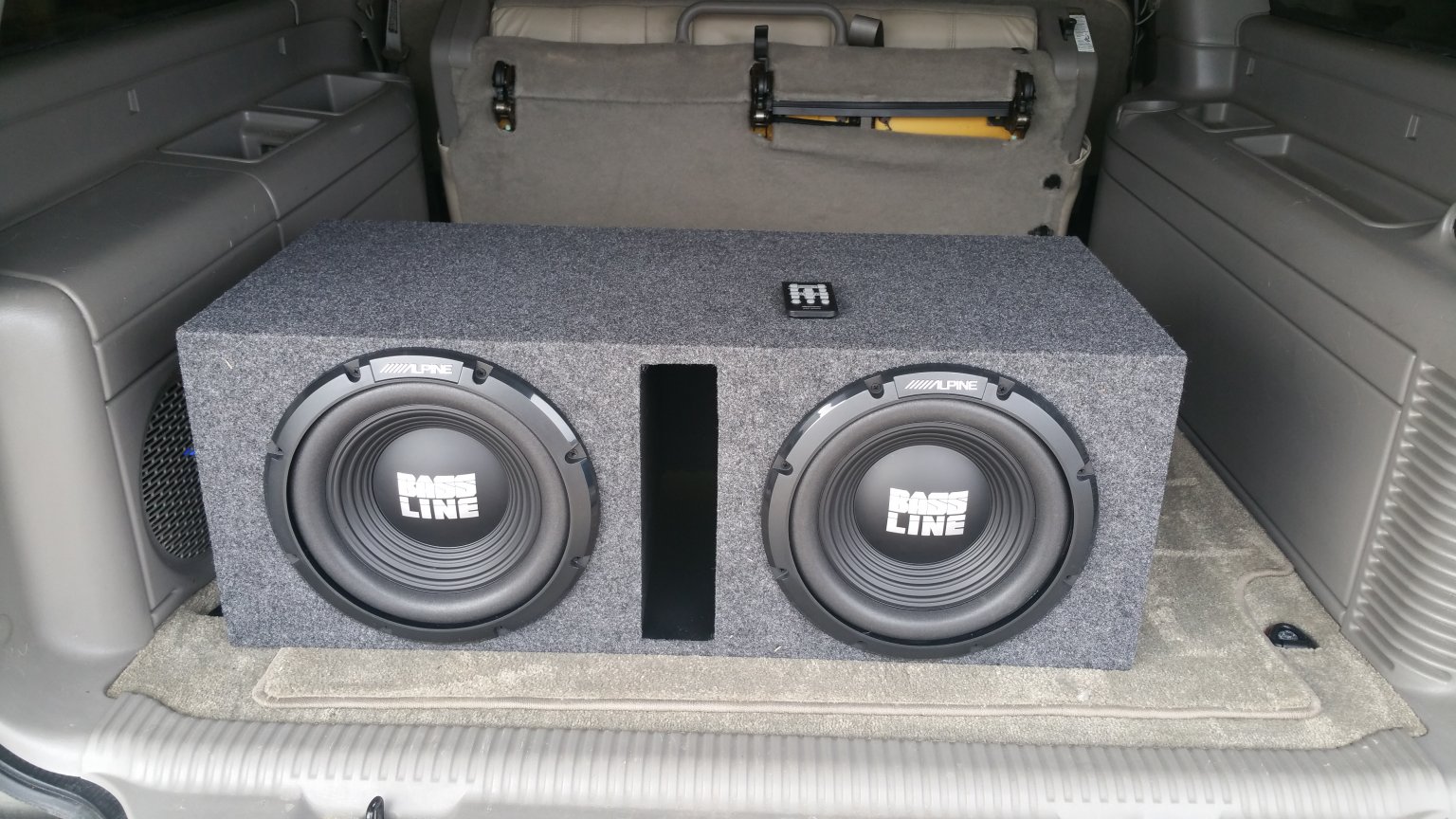

When I went to there today, I asked how much extra it would be to upgrade to dual 12" subs, and it was only an extra $40, so I went for it.
So I got 4 Alpine SPS610 speakers (one for each door), a pair of Alpine SWA12 12" subs in a ported box, and an Alpine MRV-M500 to run it all.
I had them take out the factory sub box, and put the new amp in its place (you can see the light through the factory sub grille).
Now my wallet is $1000 lighter, but I know the the install is done properly, and if something goes wrong, I know who to call. :D

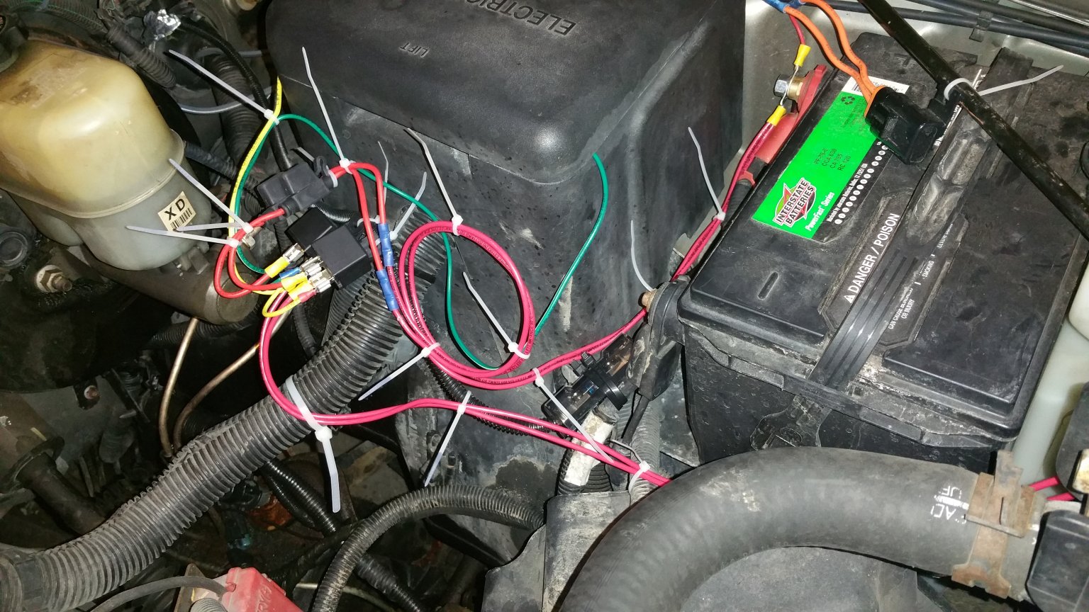

I spent a few hours tonight trying to figure out where to mount my new air horns, and only managed to mount the horns themselves. I still am working on a location for the pair of on-demand compressors (it looks like it will take an excessive amount of zip ties to make it work)
W8TVI
W8TVI
Nov 6, 2016
696
692
Traverse City, MI
Ugh.
Though I was finished.
Seems I have a couple of bad relays.
Relays click but don't pass power on the proper terminals.
Checked and double checked my connections. Everything is connected where it should be.
Going to have to pick up some relays and a fuse tap to pull the signal from the horn relay.

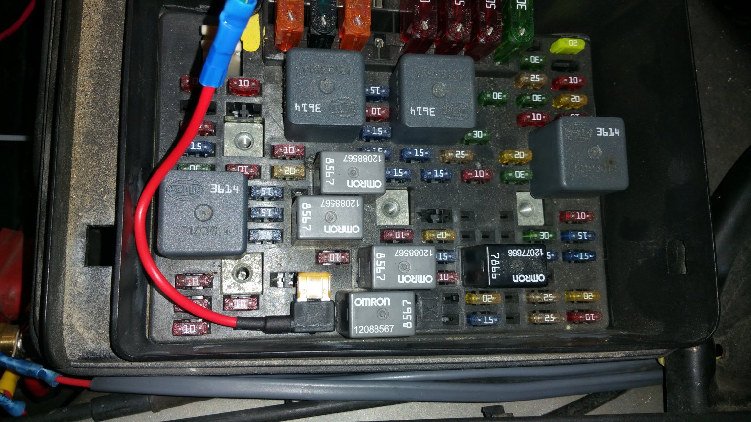

So I used a fuse tap to pull power to trigger the relays. It has two slots for fuses. The bottom fuse allows the original horns to work (and the alarm to chirp when armed), but it also worked out so the chirp doesn't sound the air horns. I'm thinking about fixing the second OEM horn so I can have dual stock plus the air horns.
Here you can see my wiring mess so I could at least have it done.
I might come back later and do something about it.

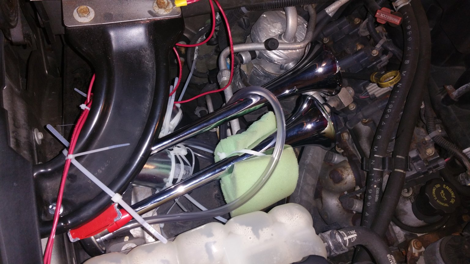

Next you can see the mess I had to leave just to get the horns and compressors tied down some how.
I have some blue high density foam between the short trumpet and the AC line to make sure they don't hit and rub.

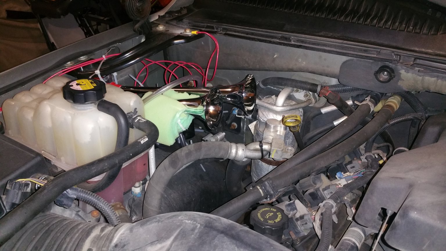

Detail showing the dual compressor location:
I've installed air horns on 4 trucks before, but they all had room on the fenders or radiator mount to put one of these compressors... There is just no room in this truck, especially for a pair or compressors and the horns.
A friend told me that his dad ended up installing them to the hood. I might have to investigate that option, but I don't think it will help me that much.
This was a real mess getting these to fit. I still need to figure out something better for the compressors.
(Yes, I did clip the ends off most of the zip ties when I was through.)
