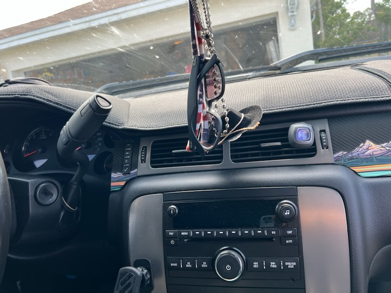

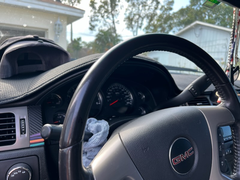

For Christmas little sister gave big sister this cool sticker of the Grand Teton mountain range for the Sierra. To recap, the Sierra was purchased in Idaho and the girls flew out and drove the truck home through the Grand Tetons.
So a little while earlier Julia put the carbon fiber wrap on her dash trim pieces and then put the Teton mountain stickers over that and finally sent me photos to post here. She also got her dash mat in today, it is Carhartt and was laid up on the dash in the afternoon, the sun will flatten it out over the next few days.

Looks really good. I wonder how the radio bezel would look with the cf look.......

I like that sticker idea.
