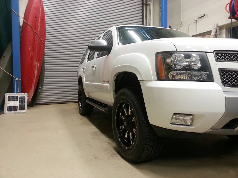

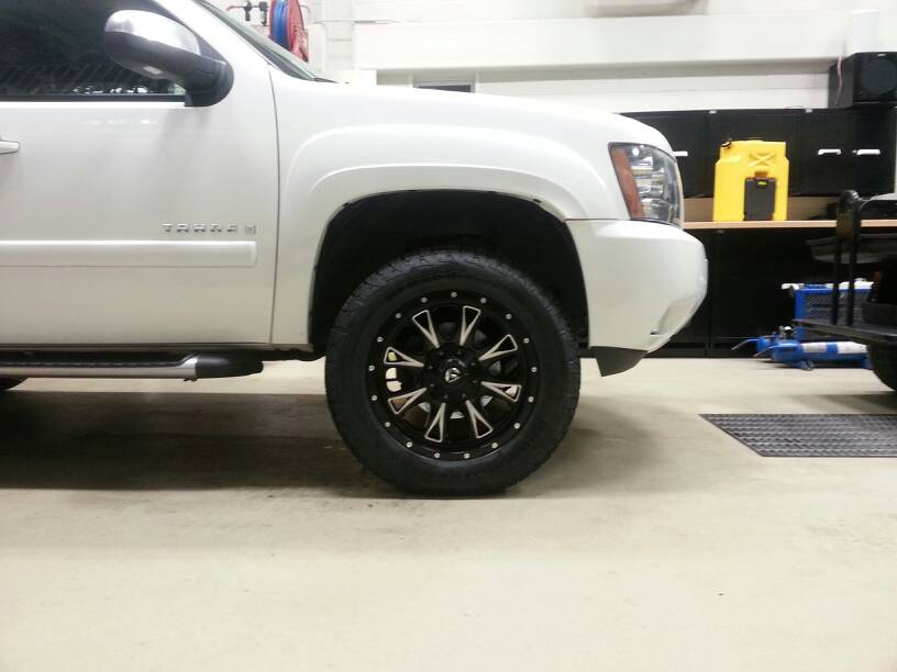

For the record. I greased back of the pads where they contact the caliper, and cleaned and lightly greased the pins. Used new hardware that the pads came with.
No squeaking here.
They aren't as cool looking as I had hoped but they perform well. They seem like quality parts. I just wish I could see them better through my wheels!
