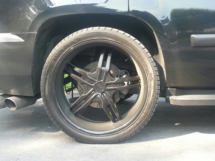

Awesome. Thank you for the answers. Do you happen to have any pictures of them installed with the wheels mounted back on? Trying to gauge how much they truly stand out. Thanks again! If emailing is easier than hosting and posting here, than tylermathews at me dot com is my direct email.

I'll post up pics when I get home. With 26's I'm sure your gonna see them....problem is, bbk's are so expensive. Fhats why I went this route. I'm satisfied though and chris has top notch service as well

Here is the pic of the rotors on my 24's. Hope this helps.
