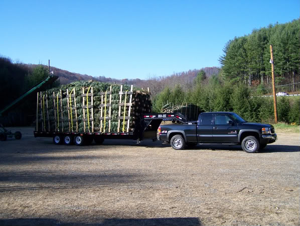

Actually, I have run the full ceramics on my 03 Dmax for over four years now. The first two of which were my last two years of hauling Christmas trees out of Sparta NC on highways 21S and 18S. My "Average" load total gross weight (truck, trailer and load combined) weighed in around 35K lbs. Those two highways are also both 6-9% down hill grades, 21 is about 5 miles and 18 is about 15 miles of bad corners and switch backs on a two lane road. In the years before installing the Premium rotors and posi ceramic pads, the pads and rotors would be metal to metal. But not only did the posi's eliminate the fade that I had with the stock brakes, the original stuff I put on four years or so ago are STILL on the truck today with well over 50% of the pads left.
In a nutshell, I truly believe they will perform VERY well with anything you could possibly haul behind your Tahoe. Without any fade or issues of any kind. It is because of my personal experience with using those pads on everything I own that I recommend them so highly. I have NEVER had ANY issues out of them at all. I have also never had complaints from ANYONE that performed a complete and proper brake system service during the installation of the new parts.
Below is a pic of one of my largest loads, this load weighed in at around 34K lbs TGCVW. The truck and trailer together weigh in at 14,440K lbs empty.

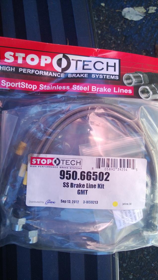

I installed my R1 Concepts rotors and pads on front and rear. The rear pads had a lot of life left on them, but the right rear inside pad was completely gone. I had always noticed a smell coming from the right rear when I would get out after driving for a while. I am wondering if cleaning and installing new pads and clips will fix this problem, or if I have to rebuild the right rear caliper?
Also, I was given 4 rear lines, and I only see two to replace. I attached a picture if you can let me know if this is actually the correct part that was shipped.
Thanks!

I had read through this thread bc my brakes were squeaking and I was considering upgrading. I decided to inspect what I had first. I don't need to replace anything, just clean and grease and we are all set no more squeak. But any way I had noticed 2 soft lines above the rear diff and had wondered if they were included in the pkg in this thread. Glad to hear they are. I may eventually splurge and get em.
If you take off the wheels you will see the soft lines at the caliper follow the steel line to around the diff and you will see the others.

Sorry I missed answering this until now. Yes, you should have four lines for the rear. Two lines for the calipers and two lines for over the differential. Exactly as stated above, he hit the nail on the head for the lines and for the one pad with excessive wear. Servicing the calipers can help that and should be done whether you are trying to keep using the old pads or replacing them with new pads.
