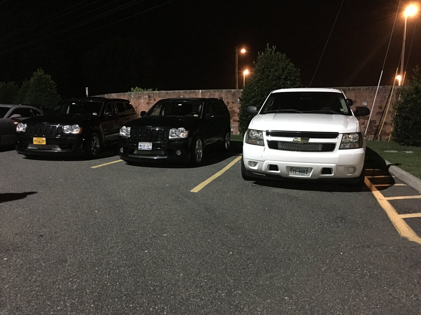

Haha it has not blown up. Although for some reason it seems my ECU took a crap which seems very uncommon for the type of ECU that it uses. So I've ordered another one but am currently trying to narrow down whether the most recent HP tuners update had something to do with it or just natural causes I guess. Here's a photo of it with friends turbo srt8 jeeps last weekend.

Great shot.
