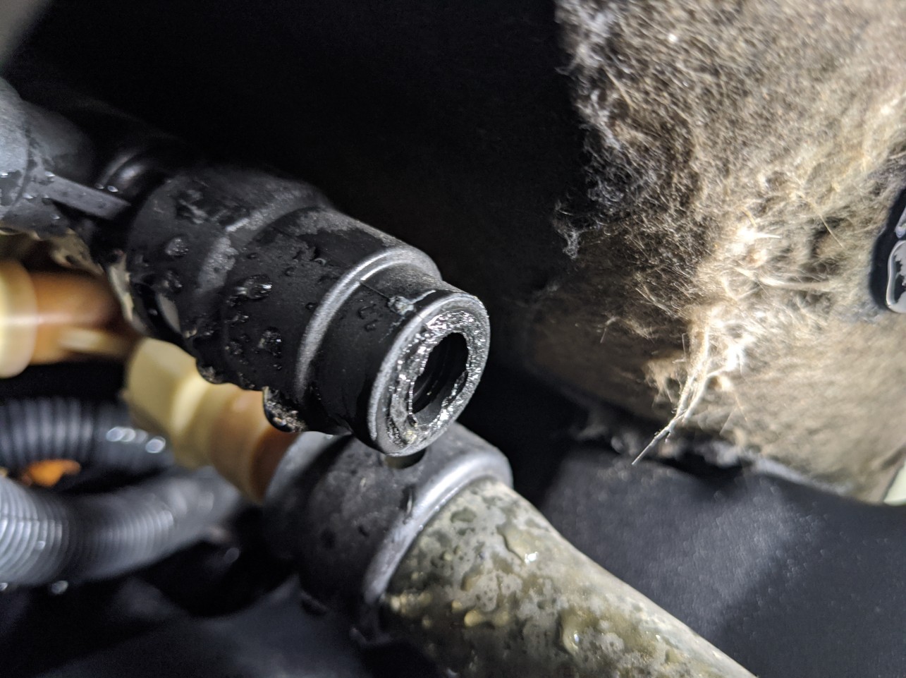

Dorman metal is the way to go. I wish that they were available when my hose blew out, but I had to use OEM Tees, and they work fine at this time.
But, if one of the Tees fails now, they are virtually inaccessible with my supercharger installation.
The Tees can be tricky to disconnect, but the best practice is to first push the hose/pipe into the connector, and while pushed in, rotate the connector and push in the 2 tabs as hard as you can, and then pull while still rotating. If that does not work, you need to cut them out carefully with side cutters or a small saw blade, being careful not to damage the metal tubing going to the front heater core.
When you change out the tees, be sure to wear gloves, as the firewall insulation is quite aggressive, and your hands will itch for days.
Also, while you are into the cooling system, check all of the hoses (radiator, heater, reservoir cluster), and if they are original (manufacture date is often stamped on them), change them, as they deteriorate over time with the heat inside the engine bay. Otherwise, you risk getting stranded somewhere.
And, yes, I had your exact same issue, and note that it was not the Tee that failed. It was the hose that failed.

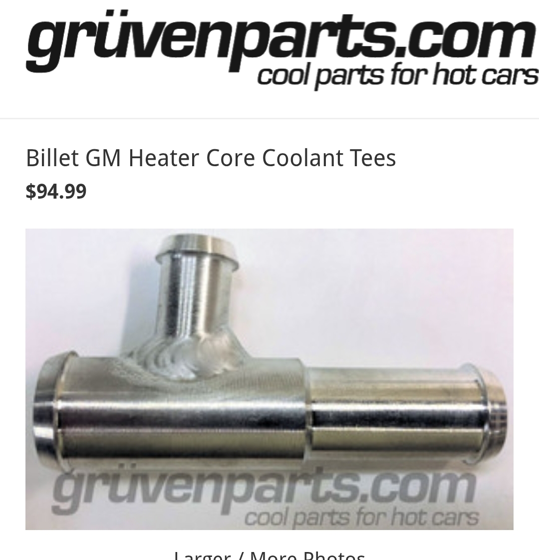

I did the OEM Gm tees a few years ago.. They were in stock locally and
dorman hadn't come out with the metal ones yet. I could have done the Gruvin
brand metal ones... But I figured the OEM ones lasted 7 ish years and looked
good when removed, so just did them again (I only replaced as preventative, didn't
have any issues, but intake was off so was easier to do then)
You are good with either choice

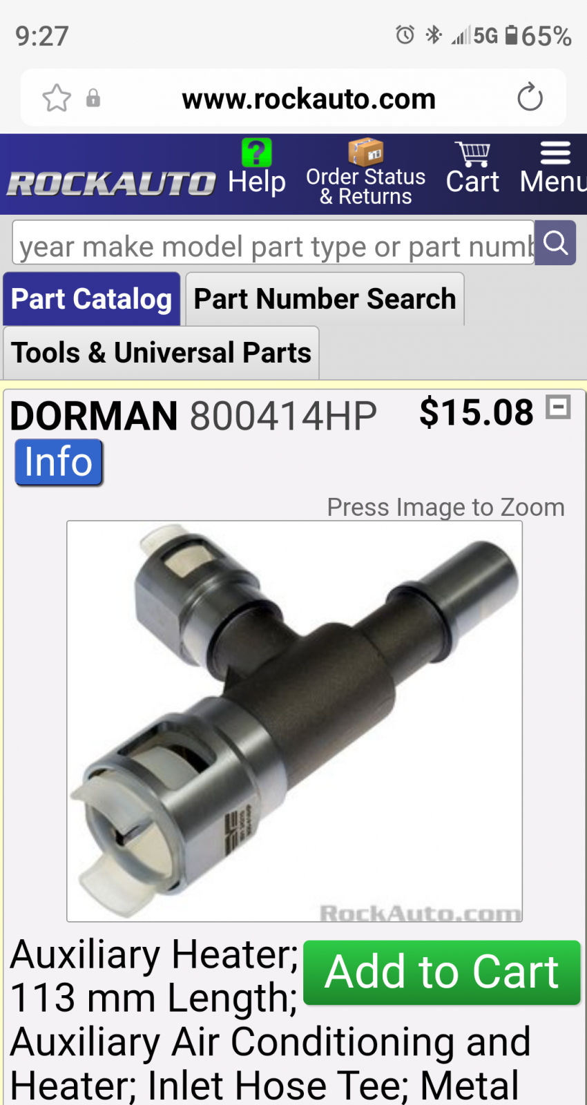

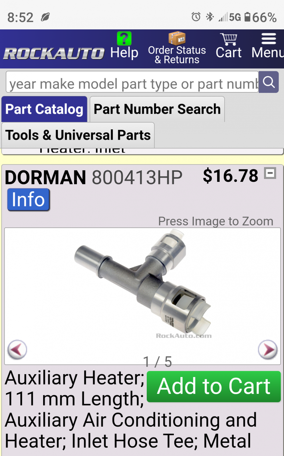

Dorman has metal ones on RockAuto for about $16 each if I remember correctly. Look under the HVAC category.
I just stayed with OEM on mine, replace the originals at 170,000 miles, we're still functioning properly. Preventative maintenance

I'm happy with Dorman T's, no need for hose clamps.. Looks perfect to me for a metal replacement part.
BUT you still have the plastic hose end, which fails around the same time T's fail.
Gruven cannot compete with Dorman pricewise.. (small volume vs big volume)
But hopefully they will continue to produce many niche products.
