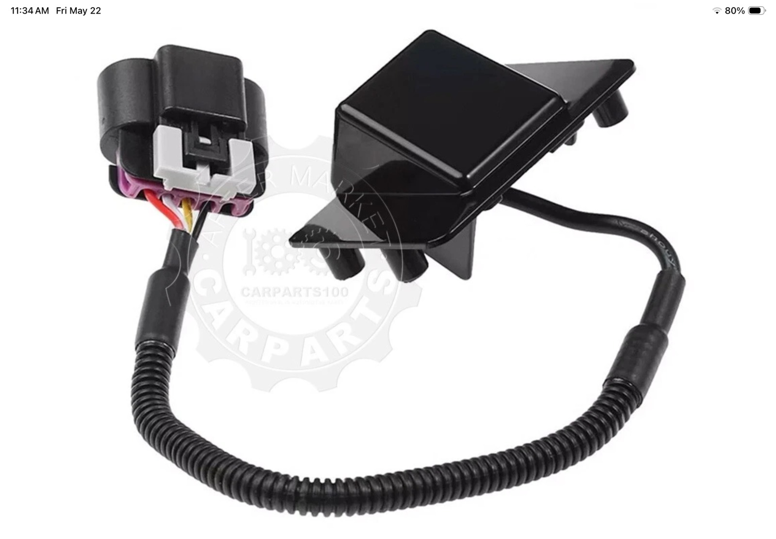

I’m wanting to install an OEM backup camera on my 1941 Cadillac project ( it’s on a 2008 Yukon Denali). I have all the stock Yukon wiring, except I’ve deleted the harness for the lift gate. I want to wire the camera directly to the rear harness. My challenge is that the camera I bought (OEM replacement) wiring colors don’t match the wiring diagrams I have. Doesn’t anyone have, or know, the pin-outs for the camera?
Pic for those curious…..

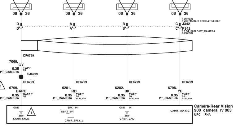

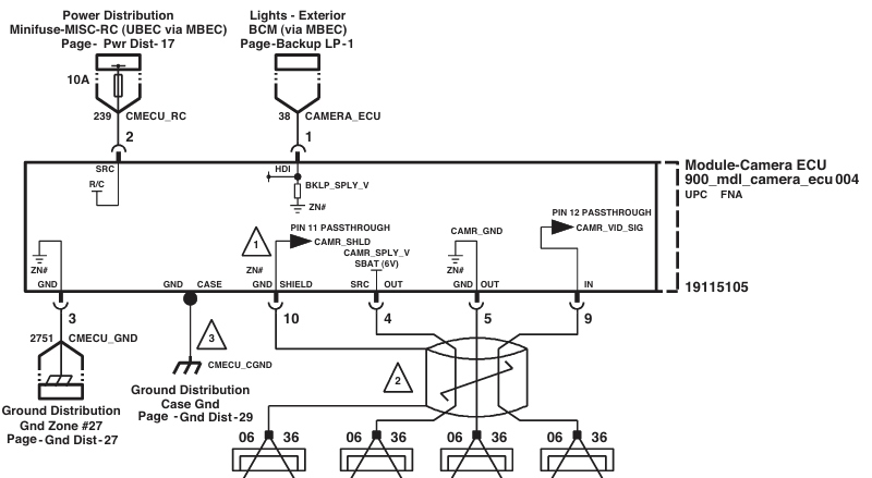

Thank you! That’s certainly helps. I tried hooking it up according to this diagram but it’s not recognizing the camera. Maybe the white wire (not shown on the diagram) needs to connect to something? The white wire doesn’t seem to be shown on this diagram.

Update, camera is working. Using the diagram I have and the diagram provided I was able to get it connected and working. If anyone else ever needs the pin-out from the camera, you can ignore the white wire, it isn’t used.
