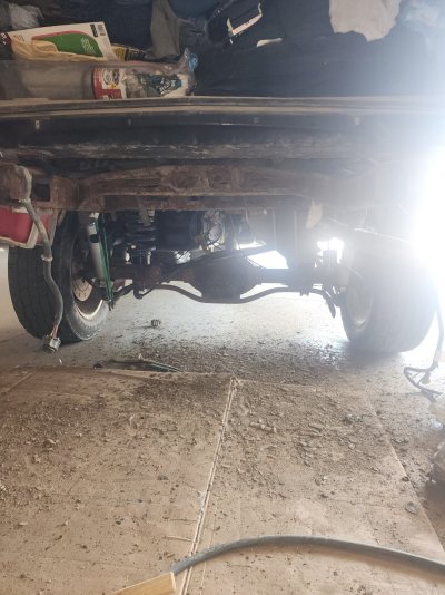

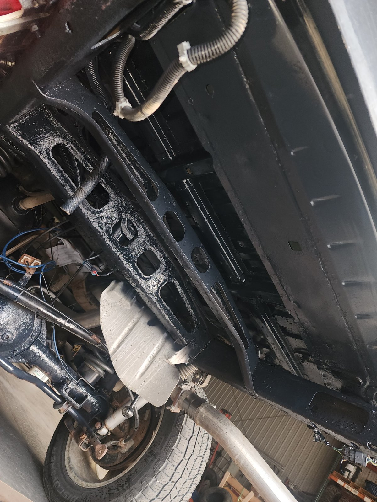

I'd skip the Por-15, it will flake of in short order if any rust is present.
I cleaned and wire wheeled then treated the rust with phosphoric acid to neutralize it then sprayed with Fluid film, basically the same as woolswax.

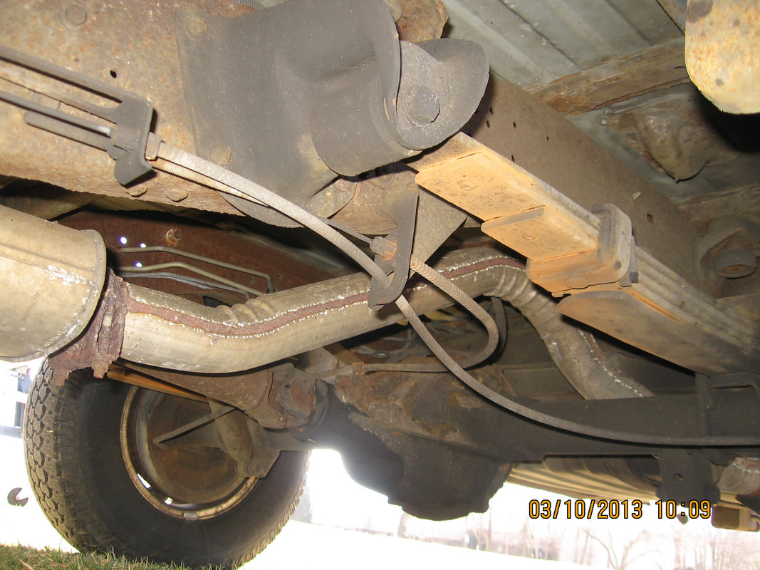

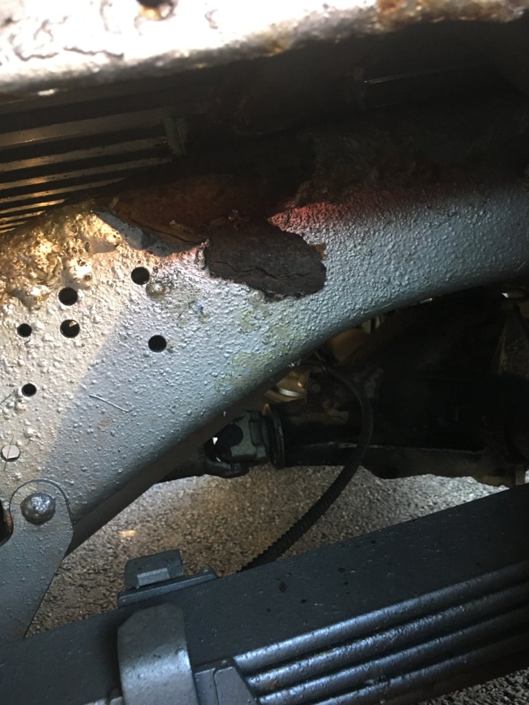

Here is an example on one of my old Suburbans of improper treatment before POR15. This is before and after pics a few years apart. That crack was not there. The POR15 acted like an encapsulator. It still continued to rust from the inside out. I was better off not painting it and leaving it alone or using some type of wool wax stuff. This really sucked because it was a clean truck for it's age.
