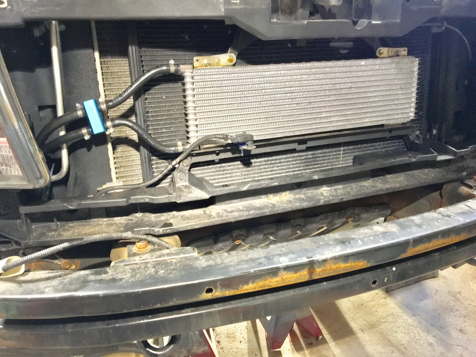

That said, I think if I had it to do over again, I would go with a Derale transmission cooler with its own fan, and mount it either below the radiator, or somewhere else that's out of the way. The challenge I'm having with the Tru-Cool is that while it's super effective, it also reduces the airflow through the radiator, while increasing the temperature of that air, creating engine cooling problems when towing in warm weather, and necessitating a radiator upgrade in my case. It's possible that I would've needed a radiator upgrade anyway for the kind of towing I do, but either way, putting the heat from the transmission cooler in front of most of the radiator makes the whole cooling system less efficient, and really doesn't make good engineering sense.
I'm in the process of putting in the Derale trans cooler with it's own fan too.
My trans runs a little hotter than I'd like and I think the reason is that my intercooler
for the supercharger is directly in front of the oem external cooler..
So moving that should help airflow to everything else and not having hot
air going directly into the aux trans cooler should help too

Consider running the DERALE as a stand alone cooler. By design they are intended to be used "stand alone". I kept the radiator in the circuit on mine and feel it isnt necessary at all. Since you are allready concerned with removing heat sources from your engine cooling system this is the way to go. when you cut the line's to plumb the DERALE simply cut the in and out from the factory trans lines to the radiator down low and leave them installed in the radiator zip tied out of the way. In the event you end up living in Vail and want the trans heat from the radiator it is easily plumbed back in with clamps and hoses.
