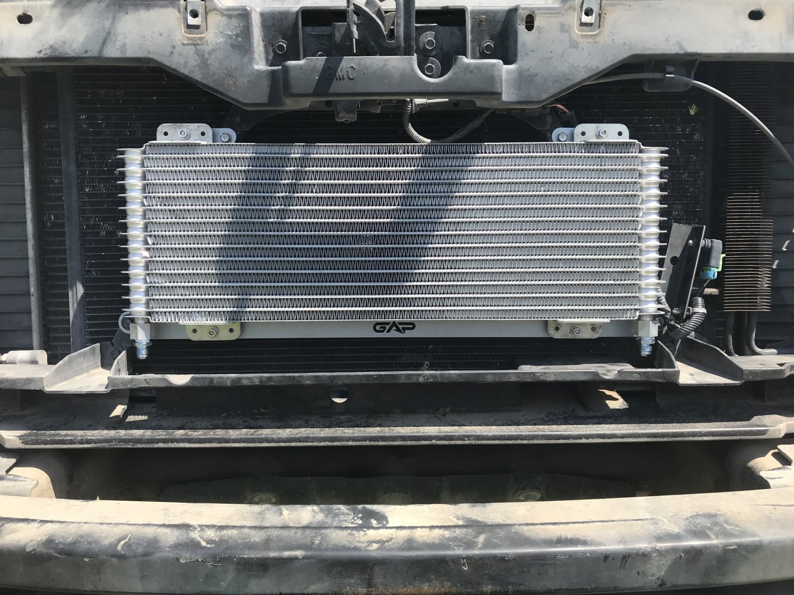

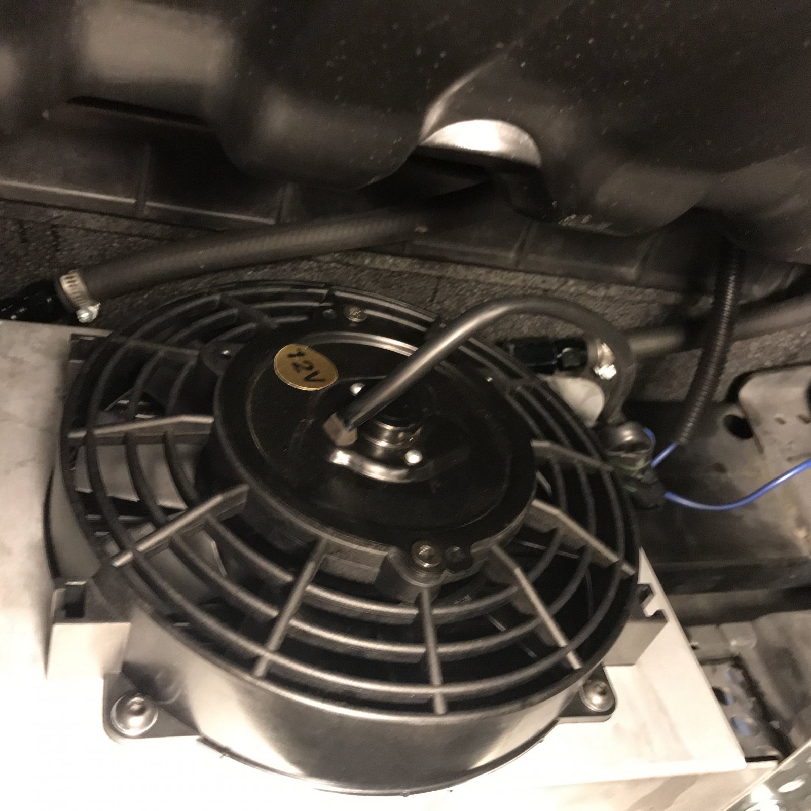

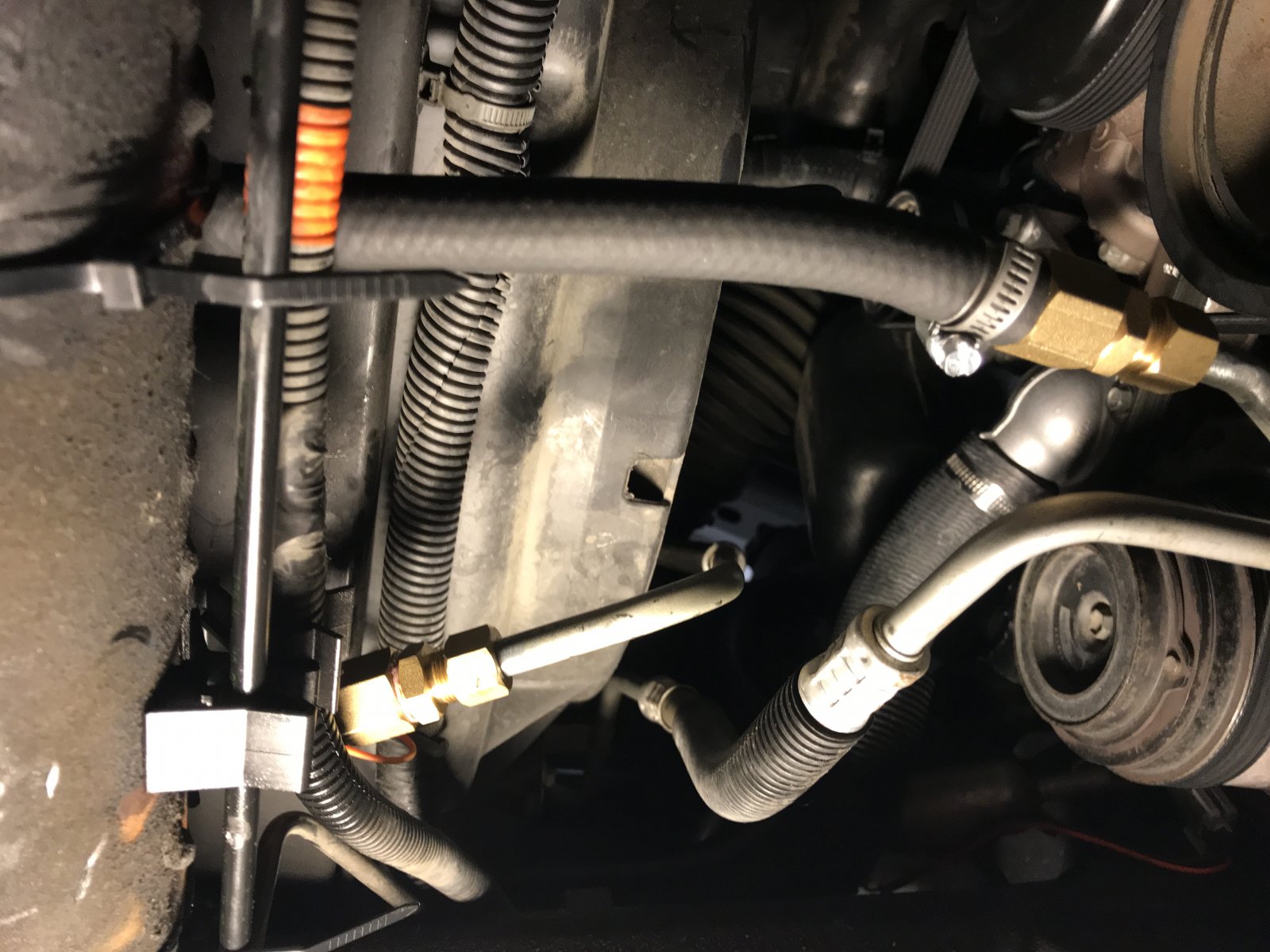

Figuring out how to upload the pic's may be harder than installing the trans cooler!LOL F'ing non compliant computers need to be taught a lesson somehow! How can somthing so smart be so dumb, Here are the pic's now upload them you pos machine! Nope i dont think i will, And i wont help you understand why either! Im old and hate computers!
