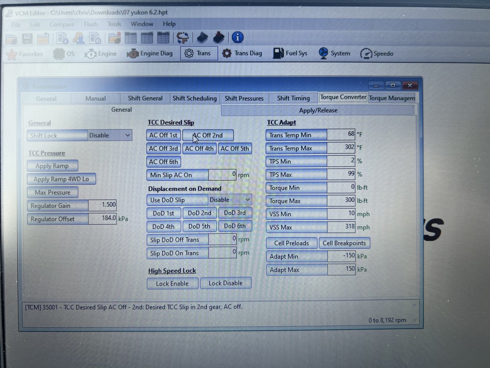

I zeroed out the tcc slip and used the bluecat to make changes to the shift schedule.

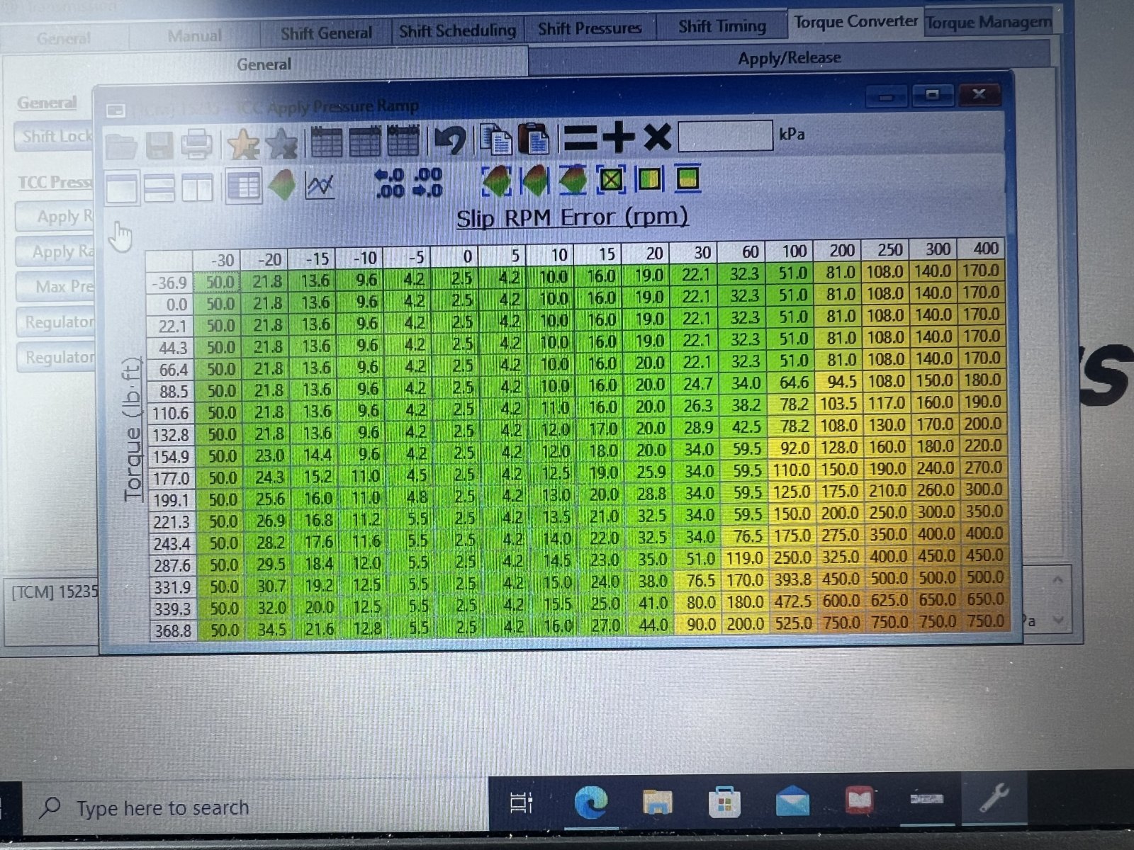

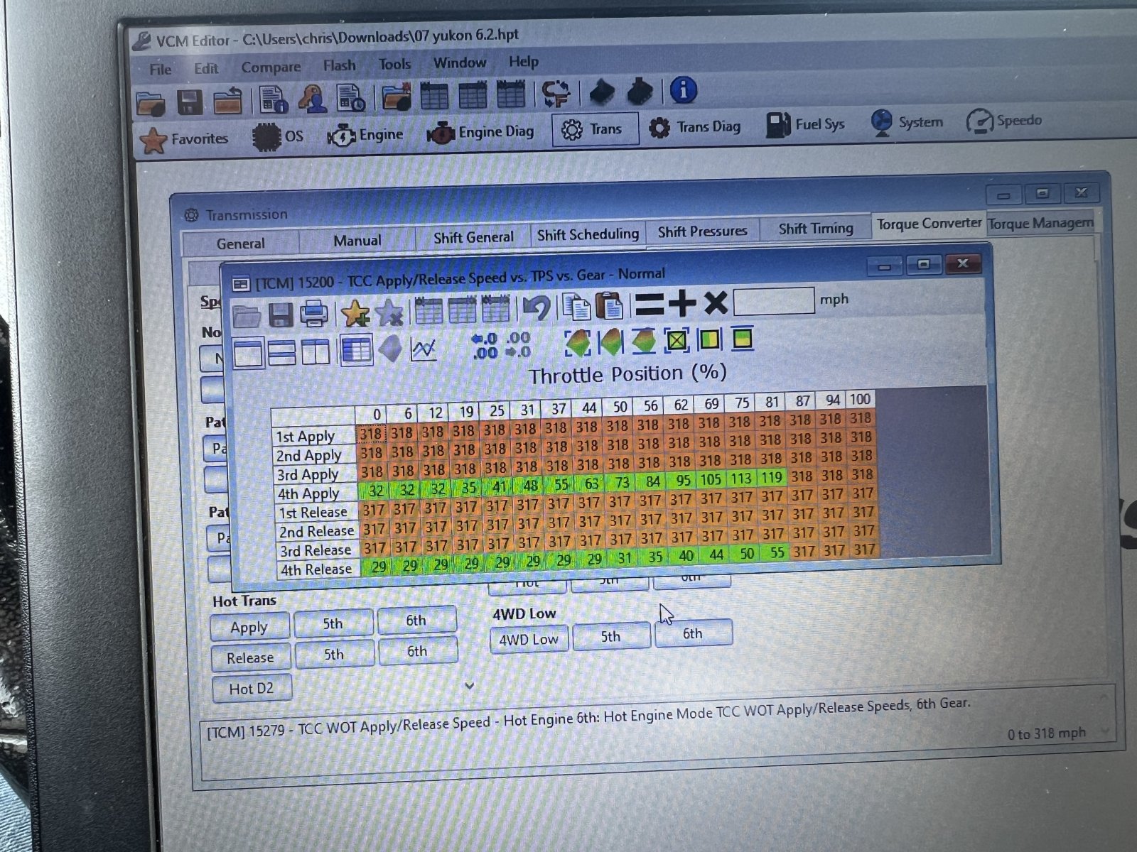

My tcc desired slip is all zero as well as dod.
I didn’t change the apply ramp.
I have it set in the apply release tables to lock up in 4th. I left tow haul mode alone.

I have read several threads on HP Tuners forum that say don't mess with 5/6 lockup as doing so will shorten convertor life. I did not change mine per the warnings i read.
HERE is another great vid. There is actually a few good vids to watch if you're interested in learning.
C
Chris2144
Jul 13, 2019
222
192
Ok I see what you’re you’re saying.
So I did change it but only an exaggerated amount of what it was.
So 5th apply wot was 156 which that Yukon will probably not see but it was changed to 318 if I get this thing to 318 I’ll be worried about a lot more than the converter lol.
So converter function remains unchanged there.
In that video he did the same thing I did and for desired slip he zeroed everything out.

Why not. I would think out of all gears you wouldn’t want any slip in the od gears.
For OE or OE-equivalent torque converters, some slip is required because they are designed to always have slip and not having it can damage the friction materials. From all that I've read about the Luk you installed (and which I intend to install in mine), you can zero slip without any concern.
