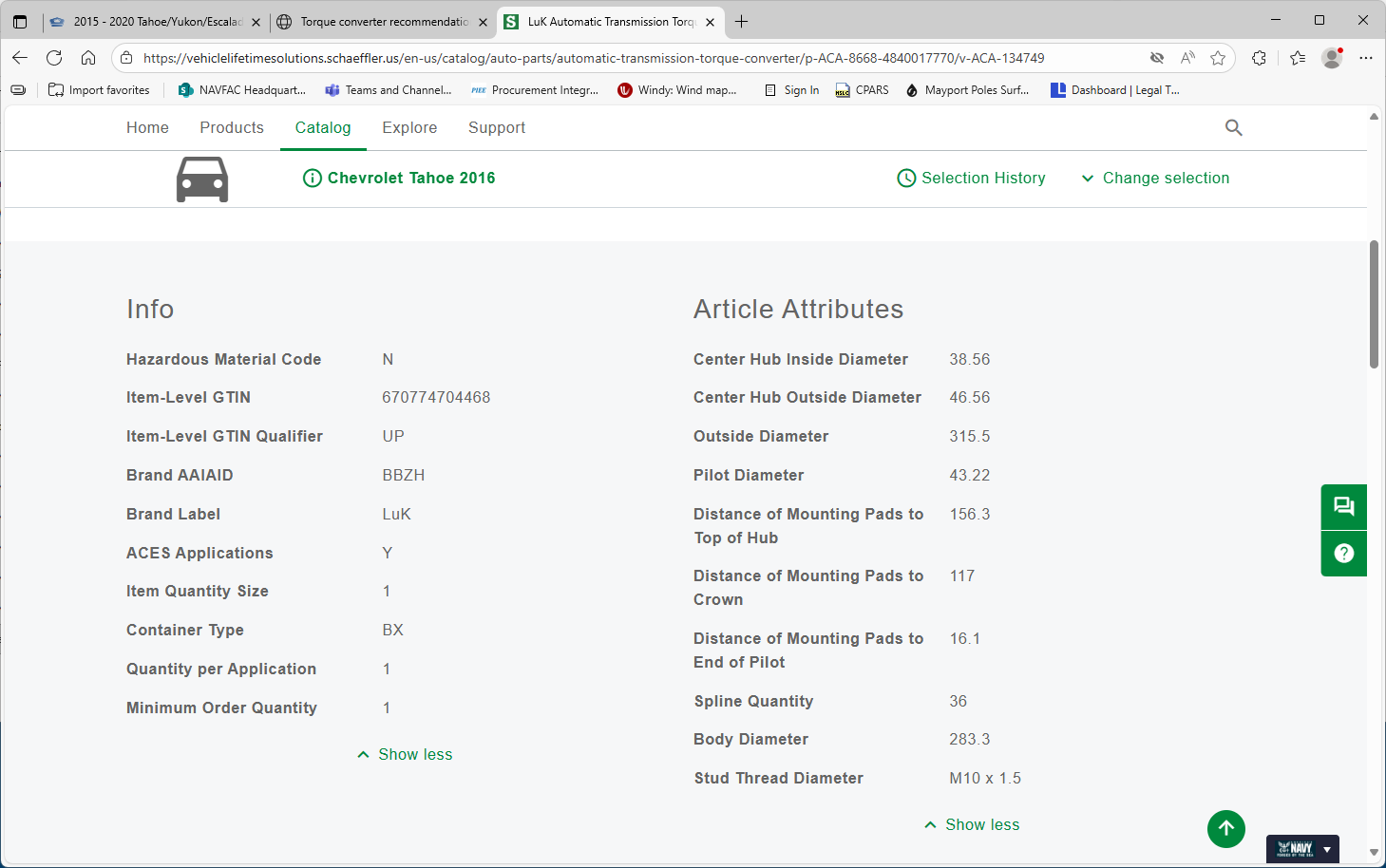

Copy..went to the site via the link.
But no mention of dual clutch disk in converter..
