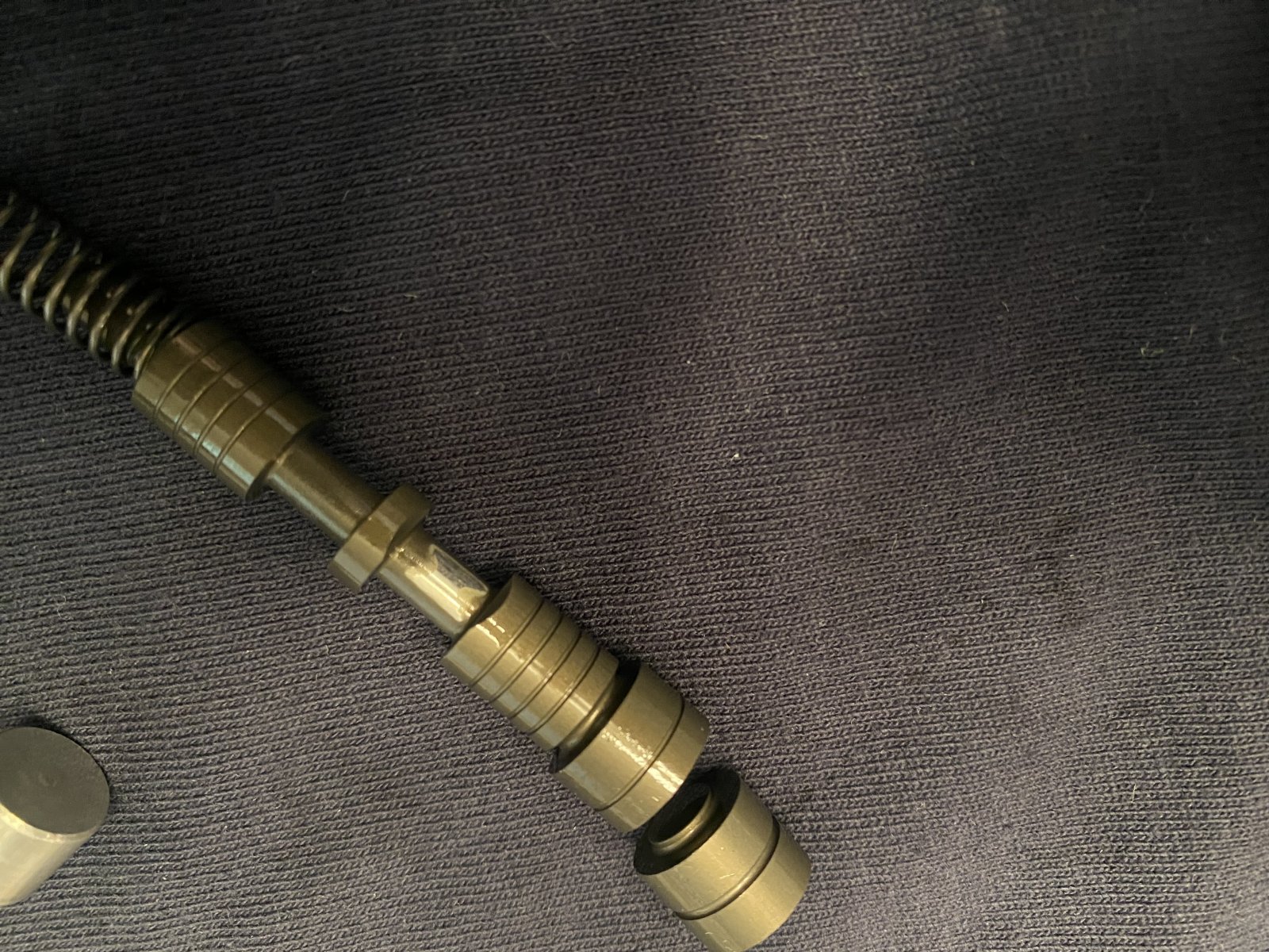

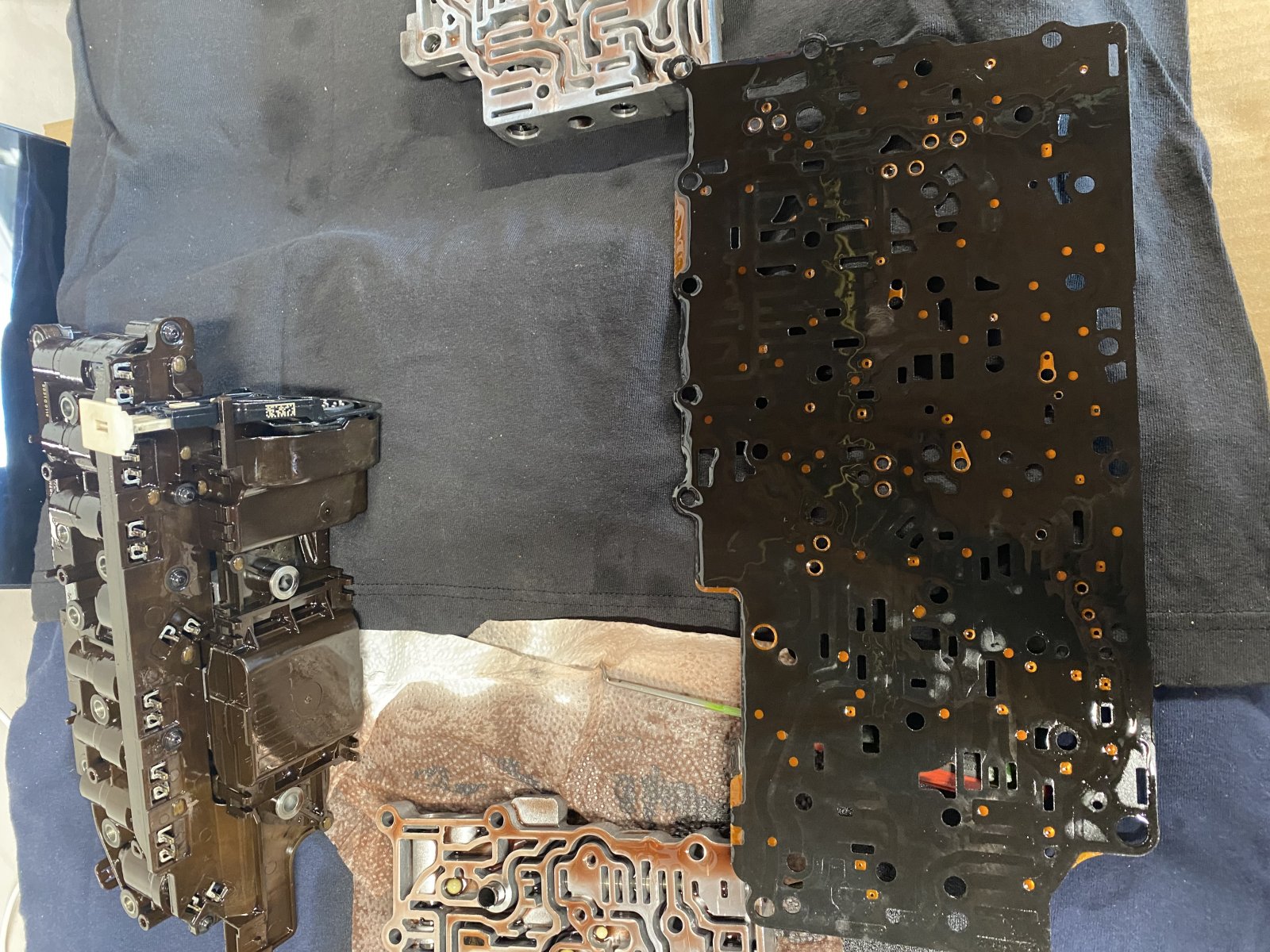

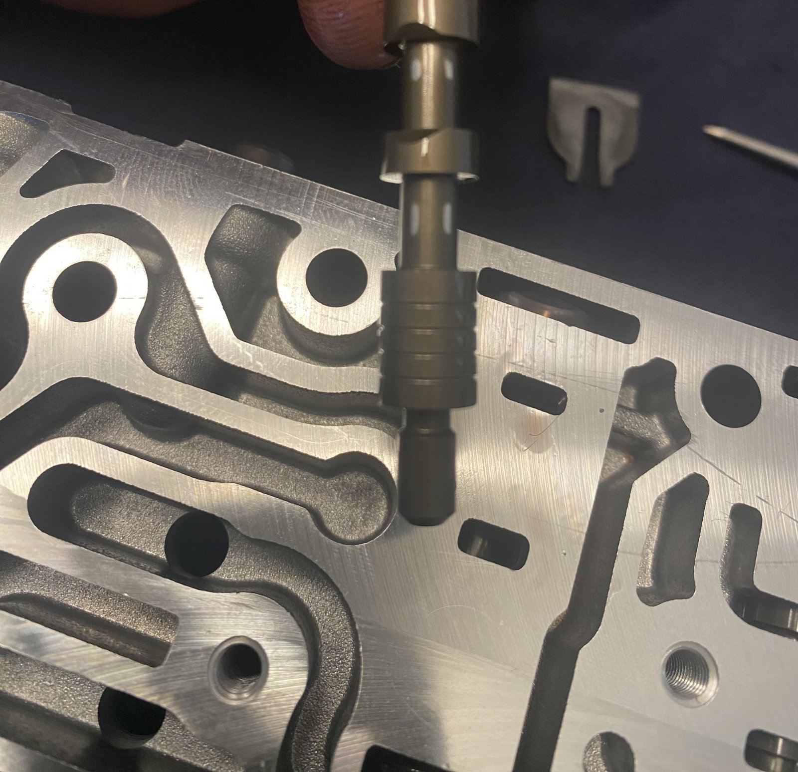

@NickTransmissions Looks like this check ball might be the culprit. When I split the case it was stuck in the separator plate. So I’m still going to change all of them with the sonnax ones, test tehcm and change diaphragms, install the zip kit minus the pump parts. Should I still get the transgo cs/tss kit to install as well and the cooler bypass valve. From a search the 456 comes with the zip kit so that’s good.

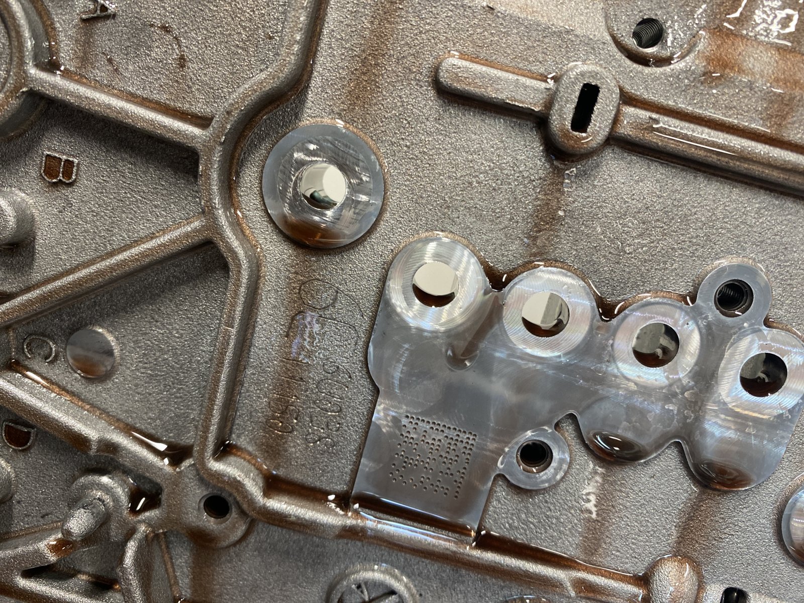

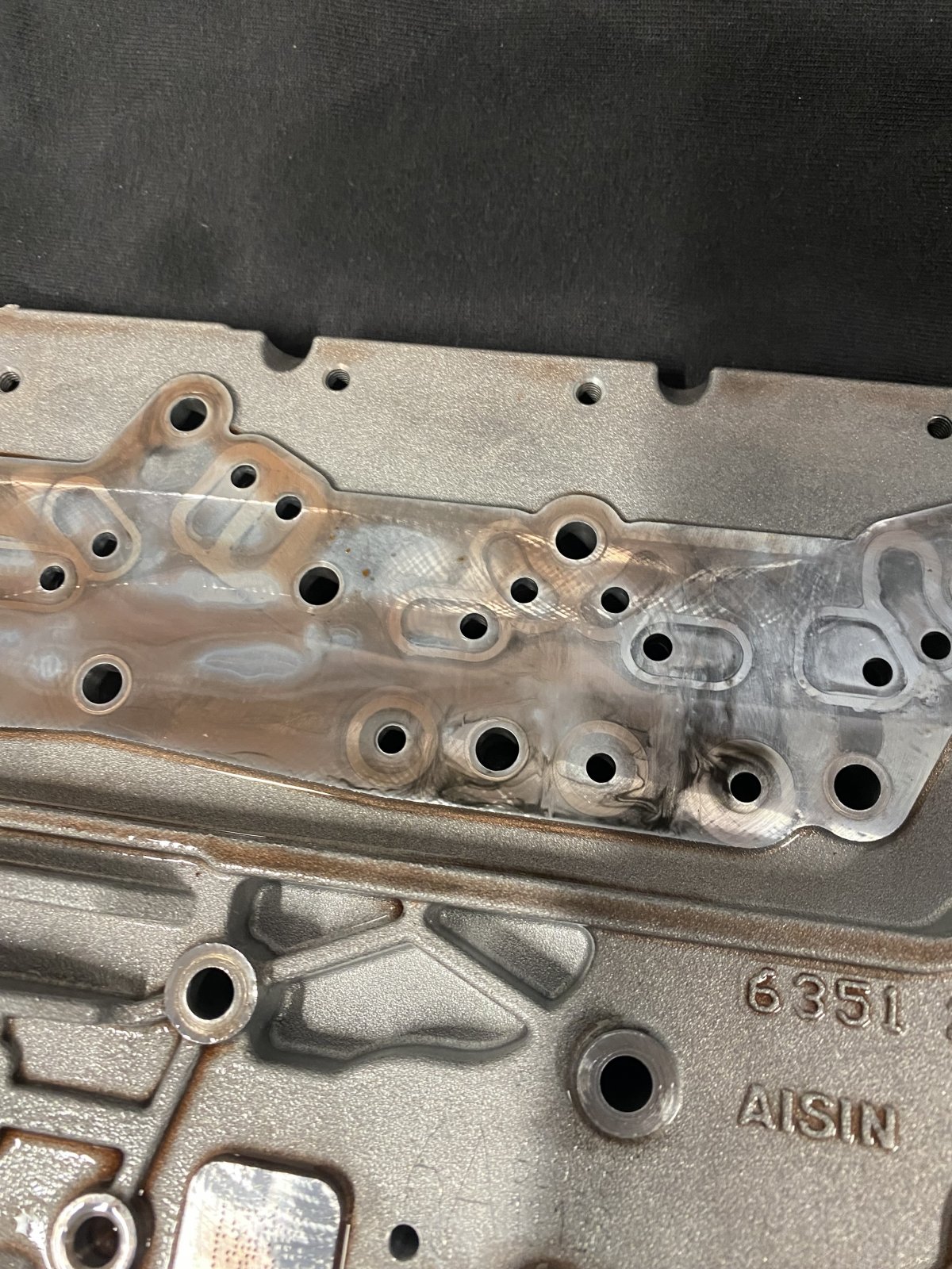

Does anyone know if these marks are a reason for concern? I could definitely notice the discoloration but they are still smooth and round. Not sure what they’re wearing on.
